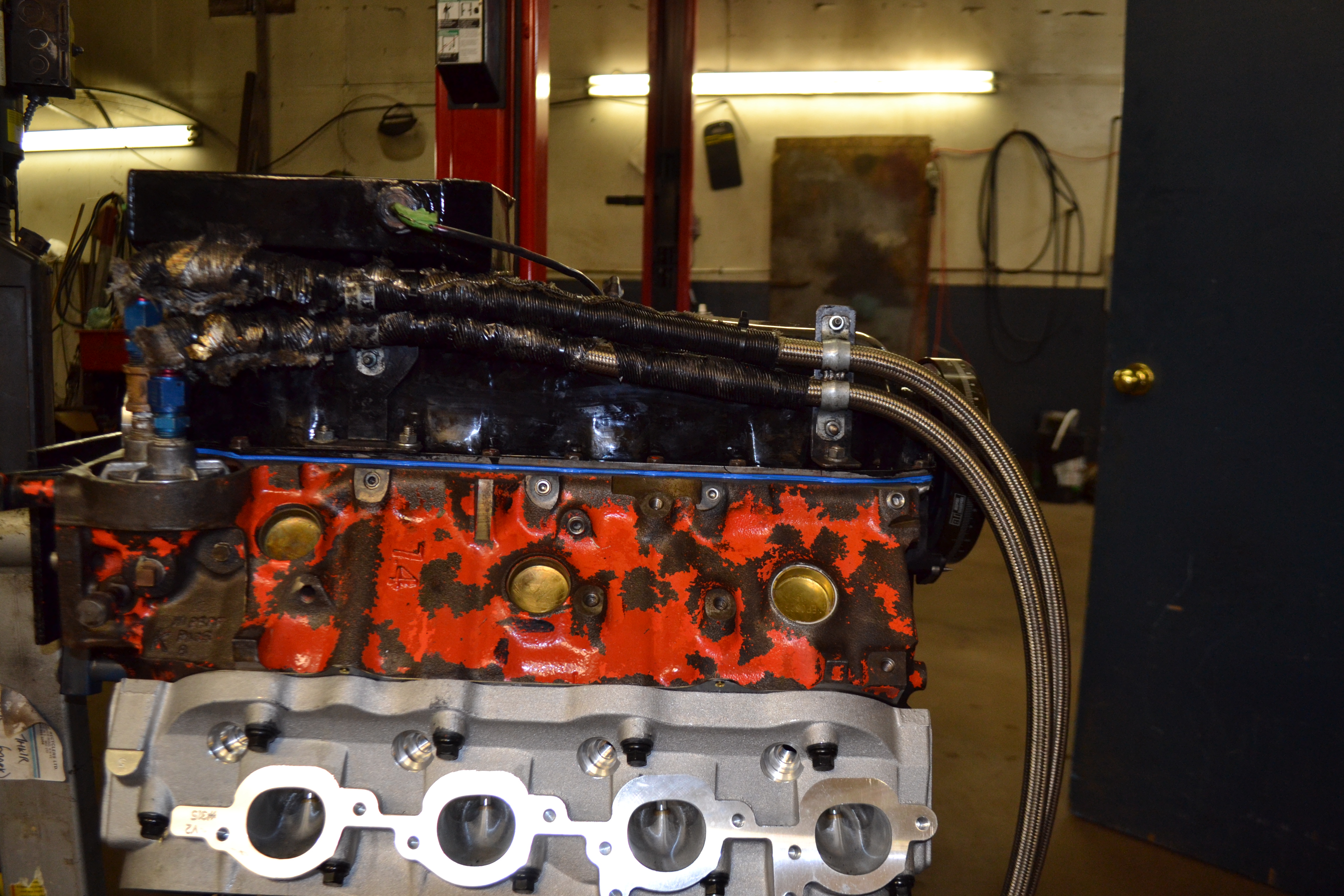

I had some braided SS hoses made up and wrapped them with Thermotec heat wrap alongside the oil pan.
Seems to work pretty good.

Can you change your oil with the pan bolt like that?
I always run Moroso oil filter bypass part# 23782 when I install an oil filter relocation kit, unlike the spin on versions these mount so the fittings are always inline so there is no interference with each other when mounting the AN hoses.
Reactions: RGBody87 and TURNA
Nope! I literally did an oil change before bolting everything up... I have 3,000 miles or less before I have to pull the engine to rebuild! Time limit makes me get more power under the hood!!!
