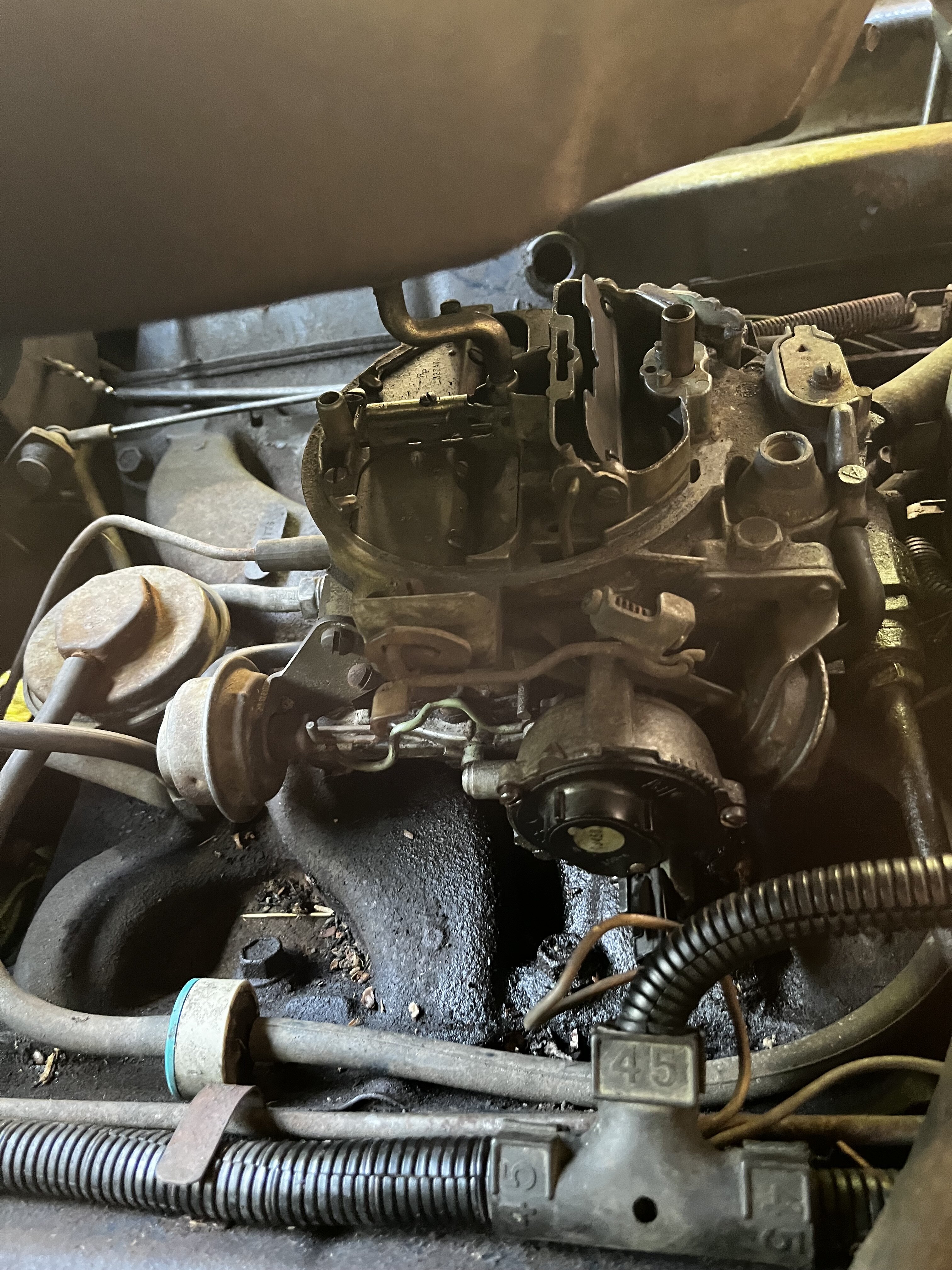

So in search of choke pull offs has to be an art now. Did figure out that I have a 750cfm carb. And I know many of the group has gone to injection of one style or another and or we know G bodies had the beginning of the computer controlled carbs. That being said, the secondary choke pull off for CadiRat is like hen’s teeth. Even after getting the carb number! I found a place on line with the part called MIKESCARB.com or here's the link www.carburetor-parts.com. They had injection and carb parts, rebuild kits, rebuilt carbs. Web site seems pretty well organized. Might want to add it to that ever growing list of options to look for parts. Figured it’s worth a mention. Enjoy the ride and let the adventures continue.
So in search of choke pull offs has to be an art now. Did figure out that I have a 750cfm carb. And I know many of the group has gone to injection of one style or another and or we know G bodies had the beginning of the computer controlled carbs. That being said, the secondary choke pull off for CadiRat is like hen’s teeth. Even after getting the carb number! I found a place on line with the part called MIKESCARB.com or here's the link www.carburetor-parts.com. They had injection and carb parts, rebuild kits, rebuilt carbs. Web site seems pretty well organized. Might want to add it to that ever growing list of options to look for parts. Figured it’s worth a mention. Enjoy the ride and let the adventures continue. View attachment 242143

That should be a 800 cfm Qjet. The secondary pulloff can be removed, glad you found one. Cliff's pull offs are the best, he actually adds restriction so they don't release too quickly and cause a bog. Yeah probably the factory fuel pump. Glad the old girl is still floating along.
