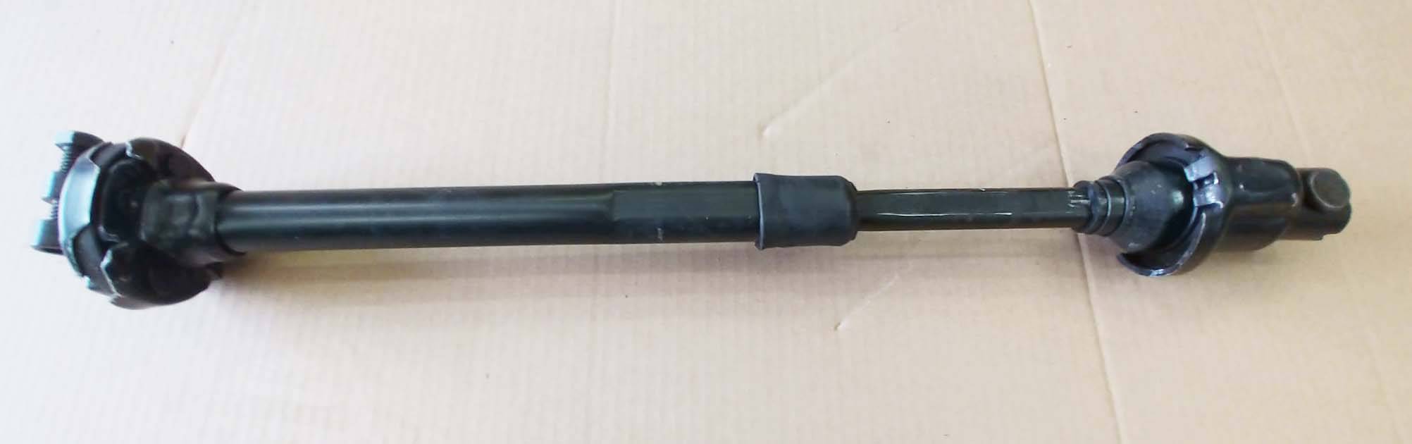

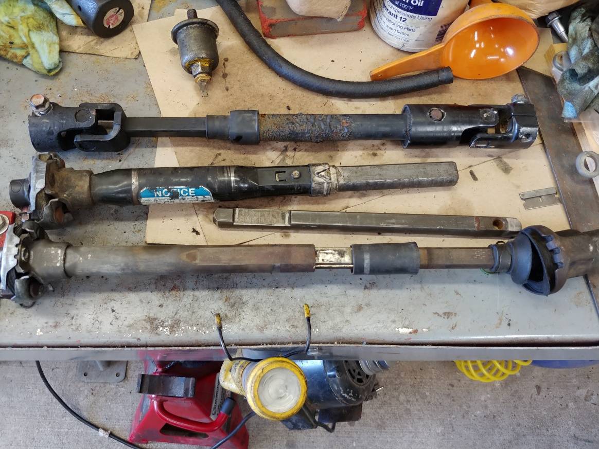

I believe your steering shaft is the culprit. I bought a brand new one off Ebay and installed it with no improvement from the old one. It ended up being the rag joint. The rubber is so soft, it compresses whenever you turn the shaft. This is what caused my steering slop. Went to the junkyard and grabbed a Jeep Cherokee steering shaft, modified it, installed it and never looked back.
Replacement Unit - Sent Back For Refund
Junkyard Unit - Top / Original Unit - Bottom
