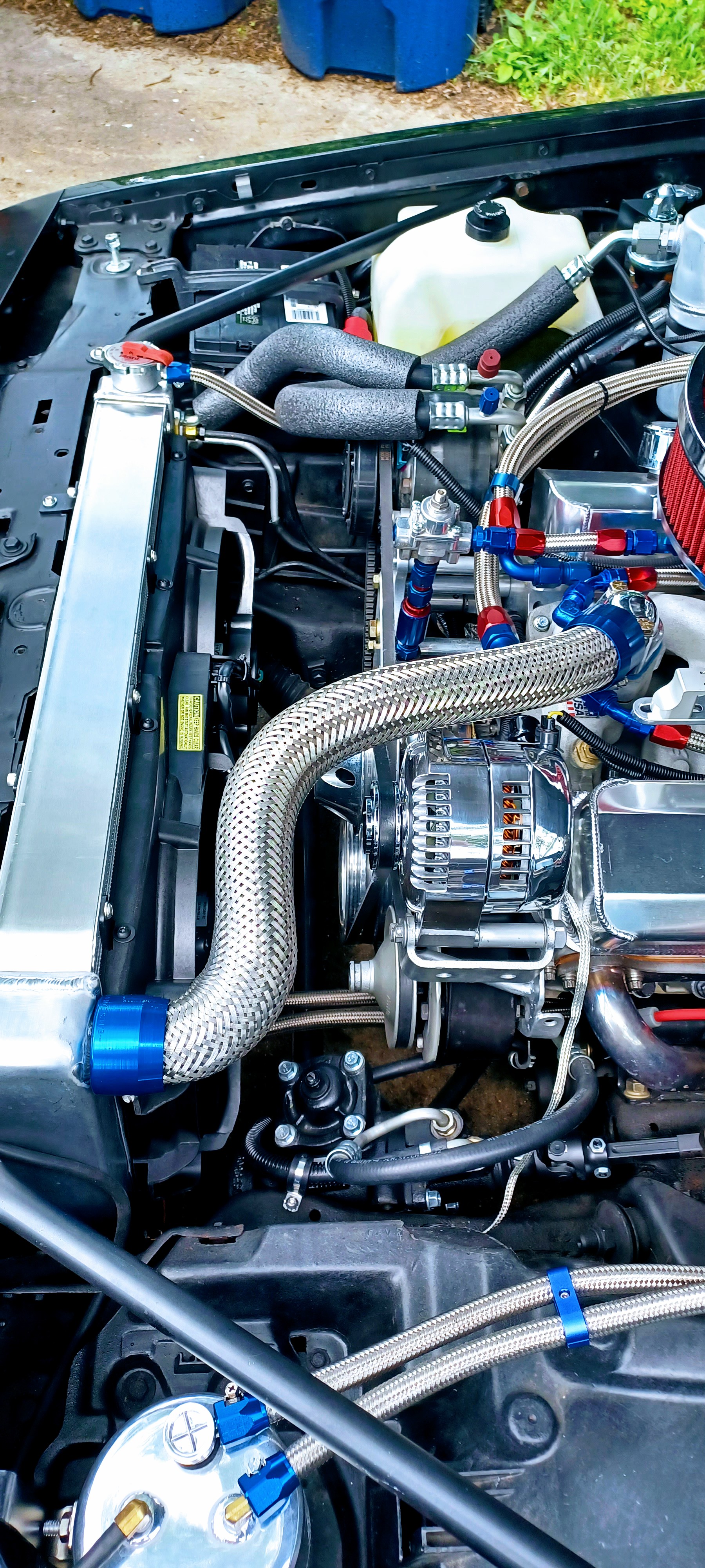

Original install the Champion 3 row and the 307
And the SBC with the Griffen and Intrepid fans

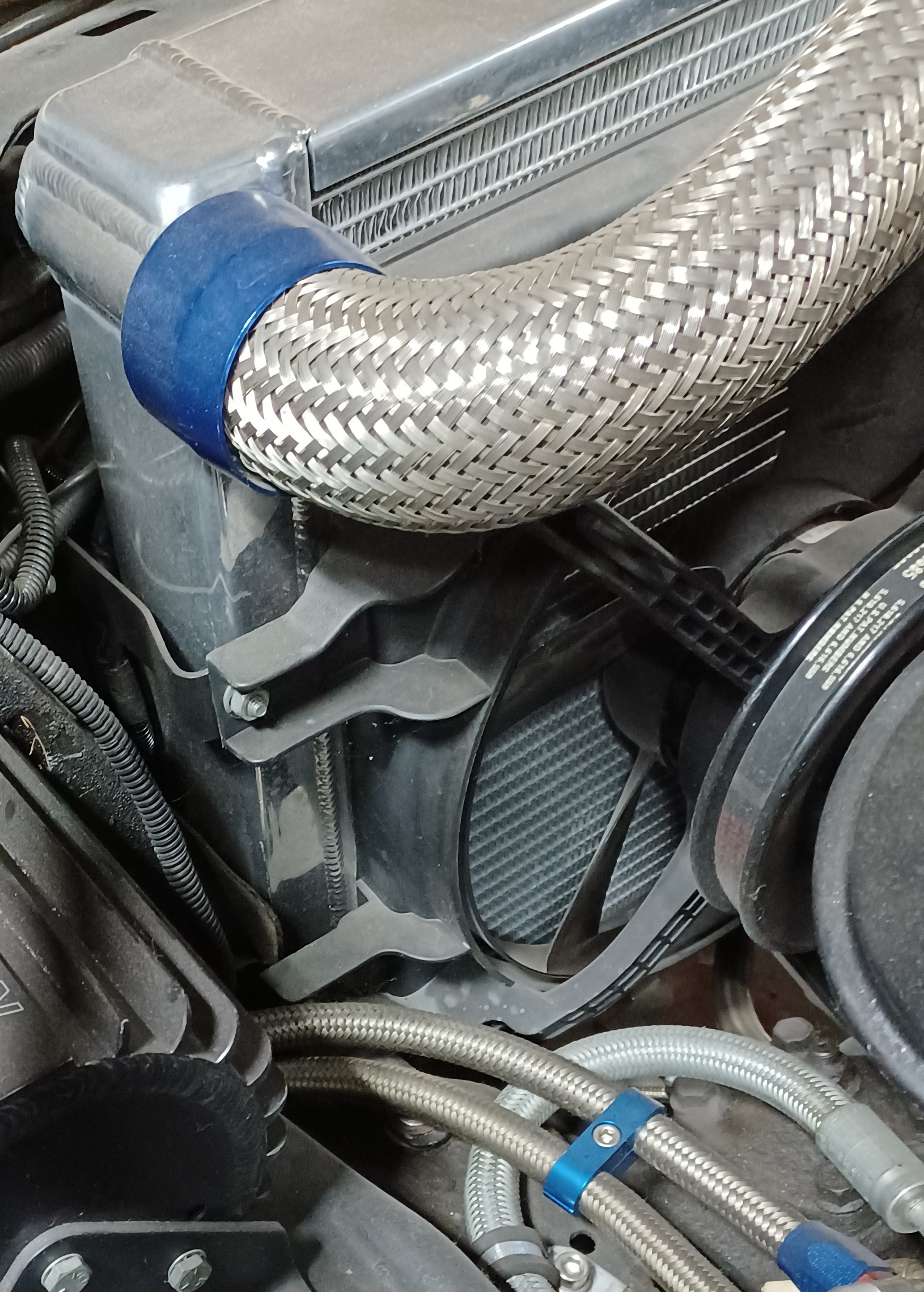

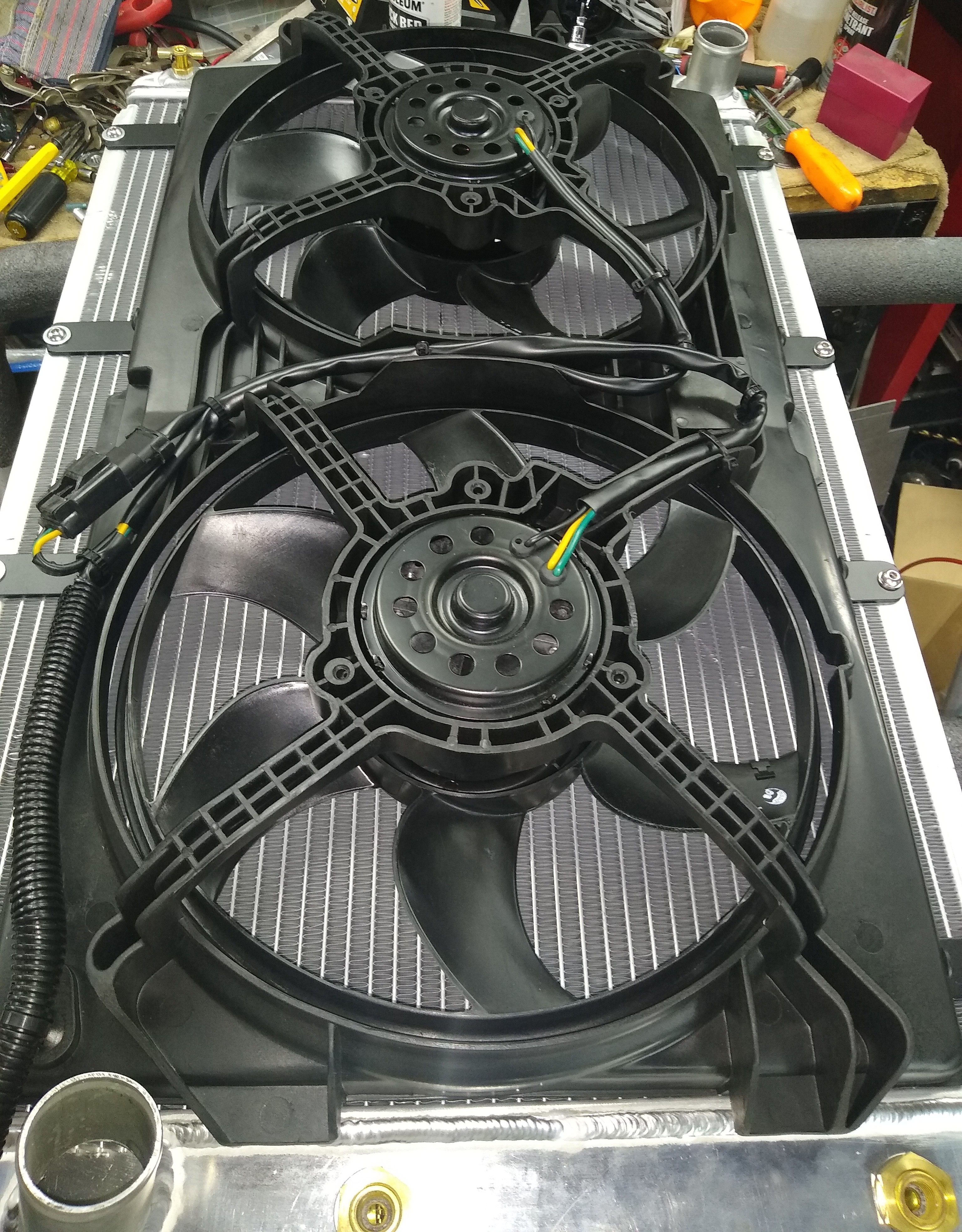

I have nearly the same set up in both of my cars and the Intrepid fans fit a 26" core with very little trimming, on my Monte I made brackets that mount the fan to the core support and on my Regal I cut off the mounts on the fan and made brackets to mount it directly to the radiator.
The dusty Monte fan mounting set up
The Regal's direct mount set up

And those keep your BBC cool? I have a 383. And how do the two speed fans work. I work at a fabrication shop so mounting isn't really an issue. I can cut, bend and weld whatever I need. I like the Monte mount you did. I might do something like that with studs for the fan side so it can come off easily.
The combination of the big Griffen radiator and the Intrepid fans keep the 565 BBC cool which I why I chose a similar set up for the Regal except that one has the built in trans cooler.
I do actually like the Monte install better but wanted to try something different on the Regal since that radiator came with the extra 1/2" open channel top and bottom so I used that area to mount them.
As I said mine never even gets to the second speed, my Sniper is the control for them. But you manually choose whatever temps you want for them to come on and come off, they are essential low and then high speed for the fans
