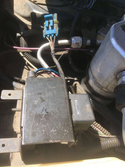

Can’t find Baro sensor
Nothing behind glove box.
Said it on inner fender passenger. Got bracket with two sensors 4 & 5 wires. Have a blue connector 3 wires with black, gray, & gray with red stripe no sensor attached never had one since I got it ran normal for years
Can you send pic of Baro would help
Haynes manual lacks
Thx

What is name of this part?
It is mounted on the inside of the bracket
Thx
That 5 pin module you posted is the ETC module.
