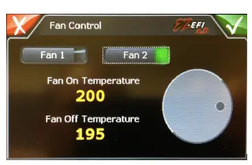

My GP is amost ready for the road to test the Fast EFI 1.0, how accurate and dependable is the Fast ECU for controlling the fan.
i've had 0 issues with it... I have to confess that i am running the Fast EZ EFI 2.0, and am not familiar with the 1.0. however you can set the temp the 1st fan kicks on at, then the 2nd fan temp and there is an input to the ECU for air conditioning which kicks them both on.
Thanks, nice to see the ECU is dependable, the 1.0 unit I have has one fan control, I guess they figure I don't have enough power to need two fans......😡
