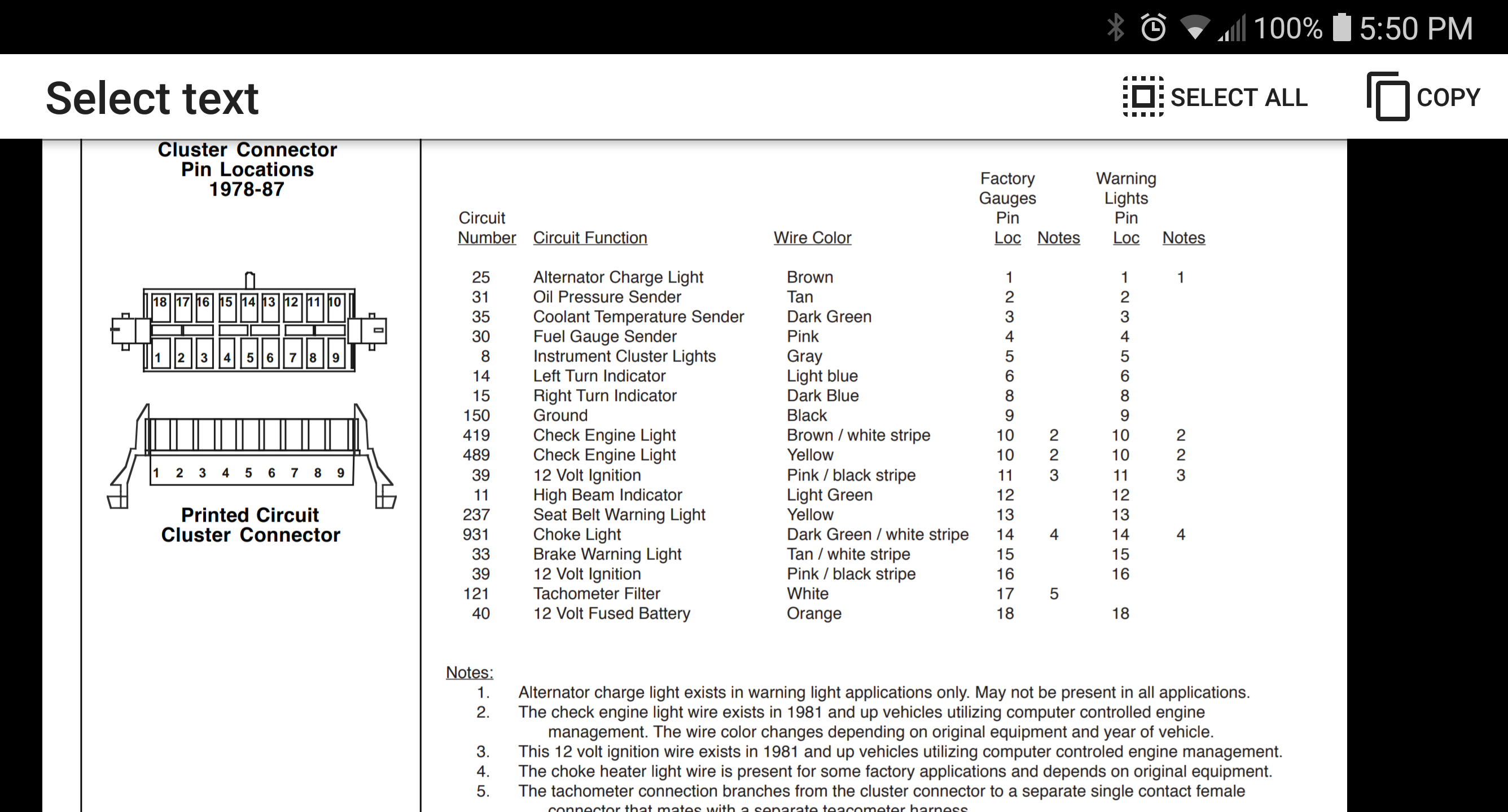

I managed to build a break-out harness for the factory gauges (volts to the alternator, oil pressure off the factory sending unit (I put a 3-wire pigtail (has power, ground, signal) and in there for future use), and the 3-wire CTS. The idea here is it allows the main harness to be removed without cutting any wires.

I goofed a little. According to this I could have added a few other things to that break-out harness (ie. CEL/SES through the brn/wht wire, and I can turn the choke light wire into the tach signal by moving the pin at the cluster connector):

Man... I am so full of sh*t. The SES wire is yellow, not brn/wht, and there are two of them! One to the ALDL and the other I learned (after much digging) blindly terminates on the PS of the dash. Yup, it goes to nowhere. In fact, of that entire branch of wires (about a 12 or so) only 3 go underhood for the TCC. WTF?!
Actually I get this car was pre-wired for an ECM... I just want it to be simple.
