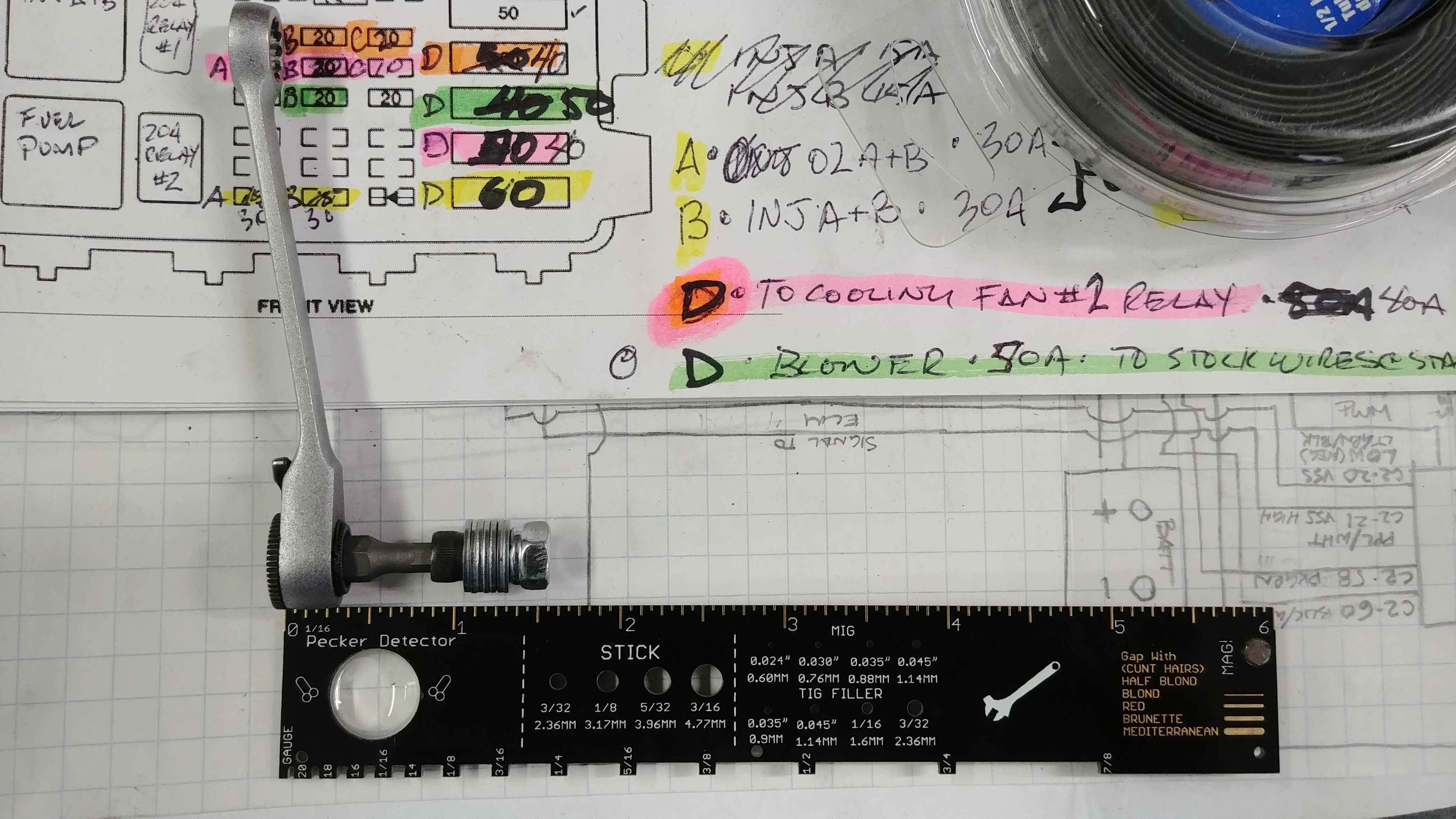

Speaking of stupidly tight things. This is the "tool" I had to rig up to install the PS pipe plug on the Holley 302-3 pan:
The oil drain locations in this pan is engineering garbage!
That moment when you realize the part for your Chevy was designed to fit a Ford: https://ls1tech.com/forums/conversi...w-holley-302-3-ls-oil-pan-preview-thread.html
The need for this pan was discovered during the development of the coming Hooker Fox Body Mustang LS swap system for users that will be wanting to use the stock Fox body K-member and power steering rack.
he installed photos depict the pan on a stock Fox Body Mustang K-member and give a good idea as to how the geometry of the Fox body K-member and steering rack dictated the design geometry of the oil pan.
And that is why the drains suck.
