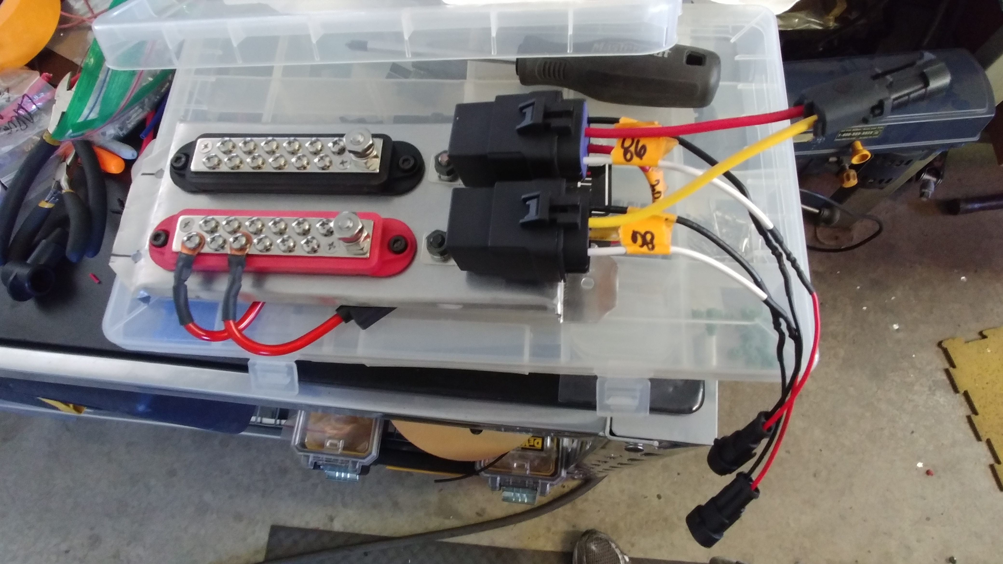

Built this. More news at 11.
Big main line fed by the alternator to the bussbar (lots of room for future expansion), system is pre-wired for two fuel pumps (currently running one 450), and a big fatty ground wire to another bussbar (shortest path to ground and whatnot).
Couple of rivnuts.
That is a long run... Repurposed a factory truck power bussbar and bracket.
I still need to make up the wire harness with leads for three fuel pumps plus a couple of spares for "future considerations" (sensors or a lead to a water pump for an water reservoir or something), and then the ground harnesses, and re-pin the fuel sender.

This sucks. I hate successfully wiring things because it means I should continue doing the wiring. I managed to get the 15 foot long harness to run the leads for the fuel pump(s) built and tested. Works. The last (?) thing I needed to terminate up front were the trigger wires for the cooling fan relay. Since I was in there I decided to add an underhood manual override switch for the fan. The fan is wired direct to the battery so that when the car is key off it will work fine (unless I trip the battery cutoff). Why not put the switch inside? Because I can command it on with HP Tuners.
