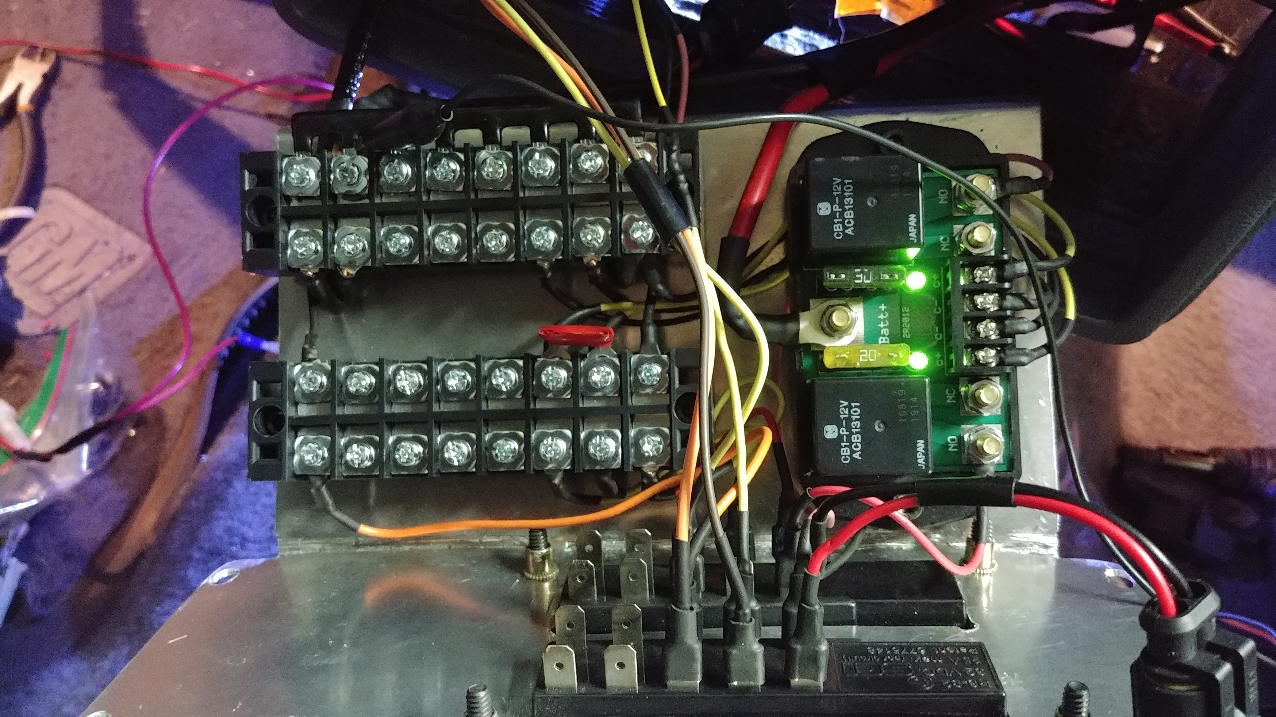

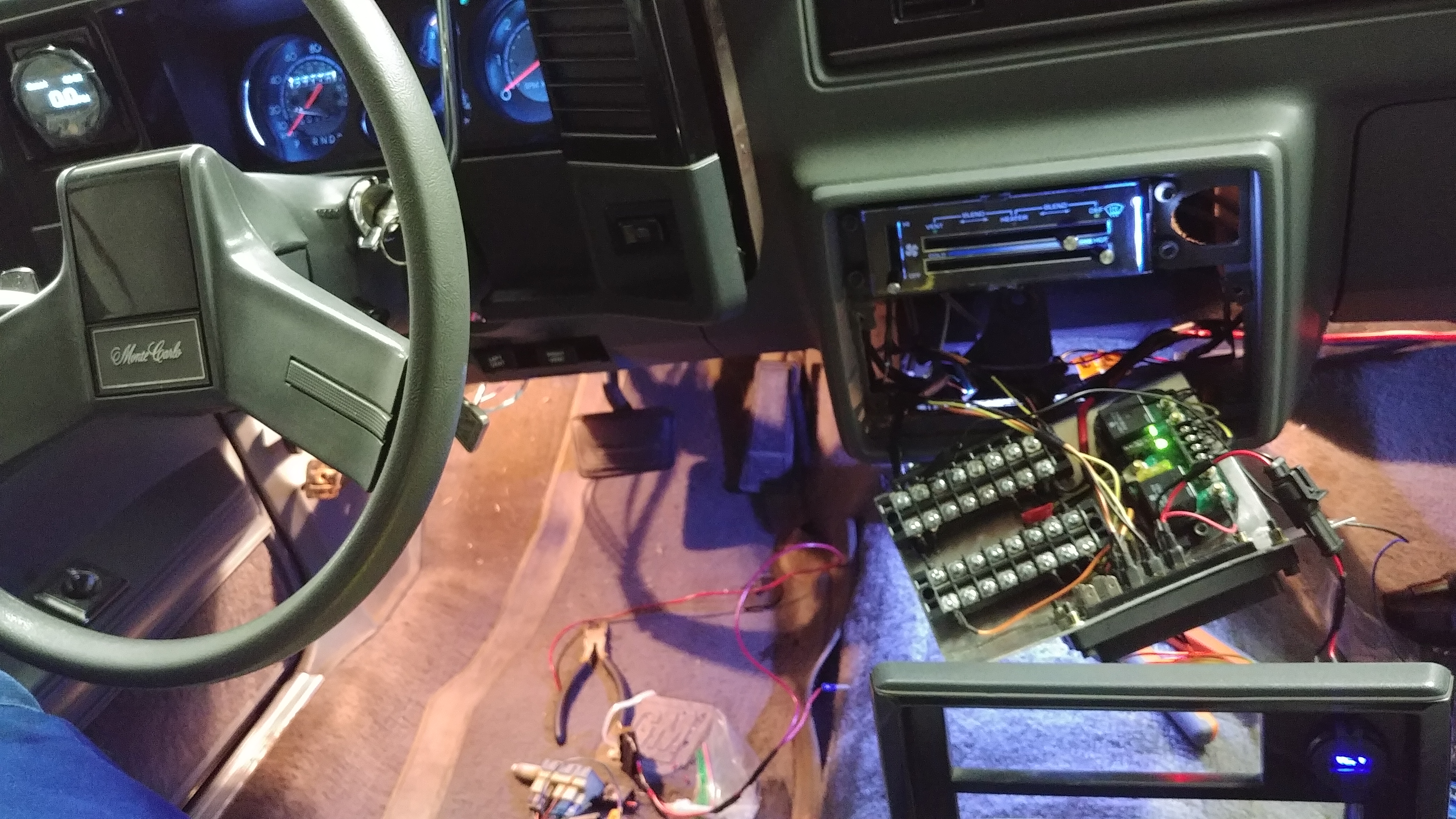

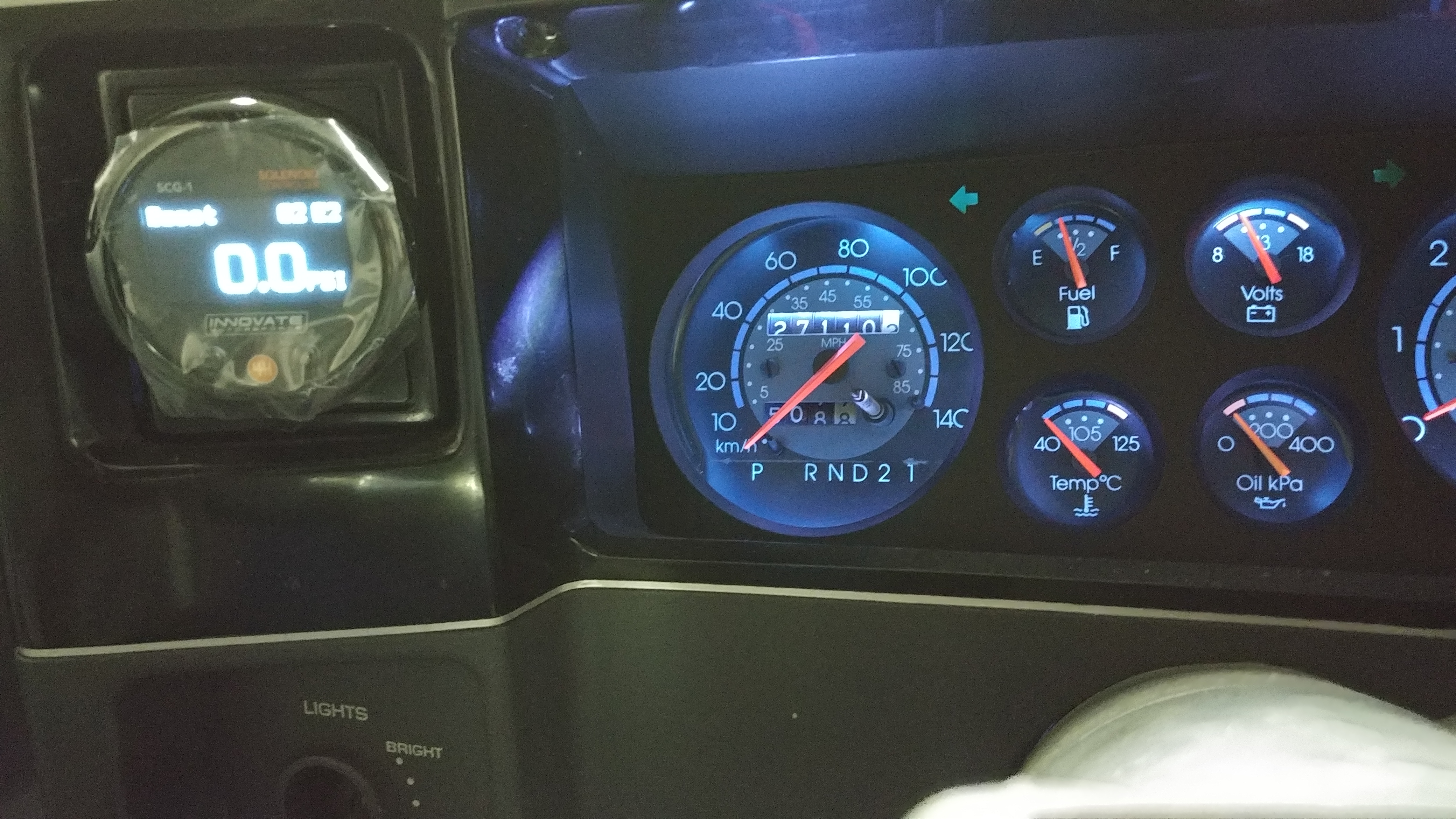

Finished up the fuse panel, ran a fat power and ground to the panel for the sake of expansion, repurposed the factory stereo power wires (that sexy key on power), dropped the old cigarette lighter thingy into the glove box for when I need a power inverter, built out the OBD II port which bolt in place of the stock ALDL port under the dash, added some LED mood lighting, and got that Innovate WBO2/boost controller to light up too.
There was probably some other stuff I forgot. Just need a few more circuits terminated and we should be good to go. Other than needing to spend money on HP Tuners credits... gaaaaah!
