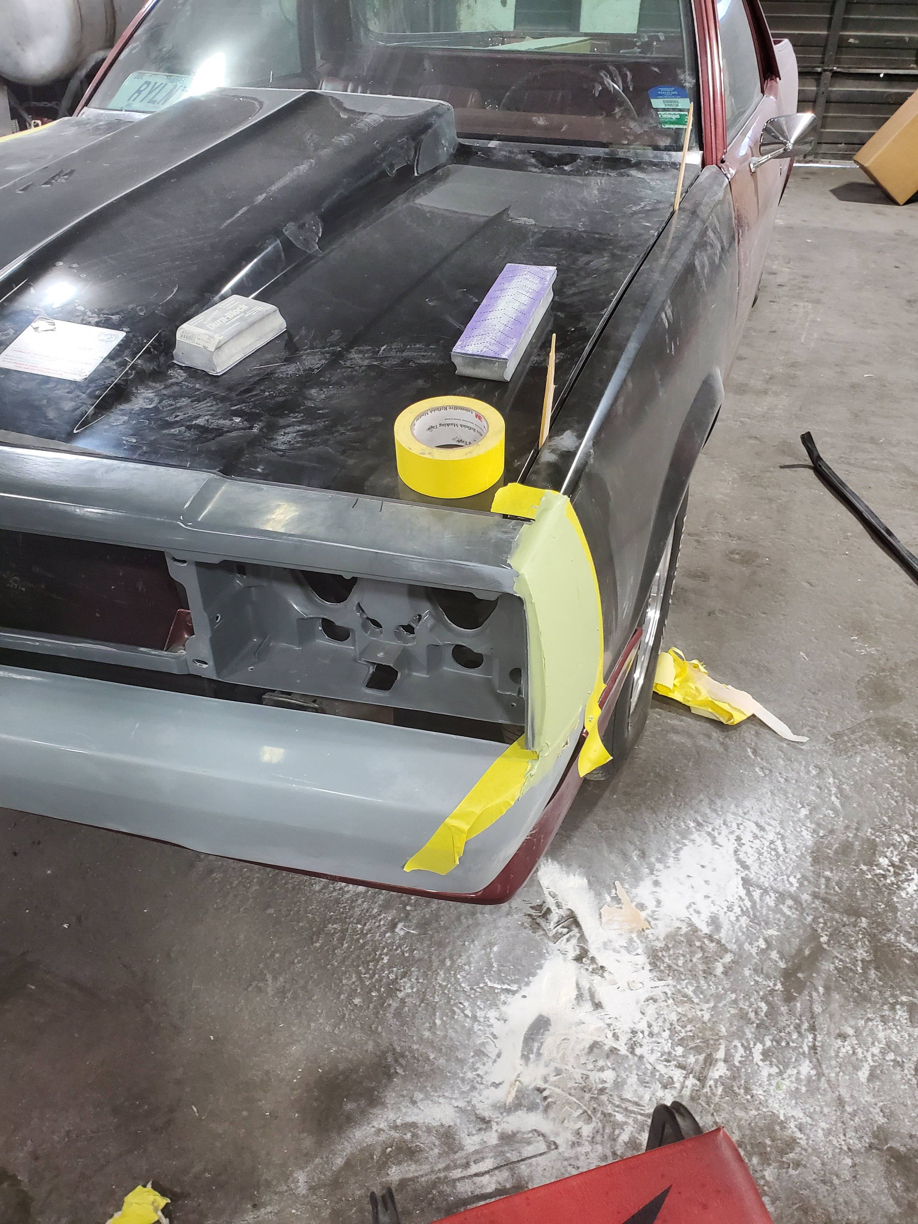

I originally wanted a steel cowl hood, I bought one from Ecklers, which cost me about 400 hundred after shipping. The hood ended up being complete junk from Taiwan. I got in contact with OPG, looking to see where they get there hoods from, and they all use the same campany in Taiwan. ( Ecklers took the hood back no questions asked) After doing some research, I found Harwood. These hoods are made down in Texas, and come at the texas price. About 600 hundred, shipping will vary. But at that point I wasn't trying to cheap out as I do not want to cause myself more work, and I wanted something nice so I had to pay up. But ultimetly only took about 3 weeks to get to me but worth all of it. Now I cannot say it was perfect, as we needed to shave down some parts of the hood, and add to others. But it has to be one of the best options
