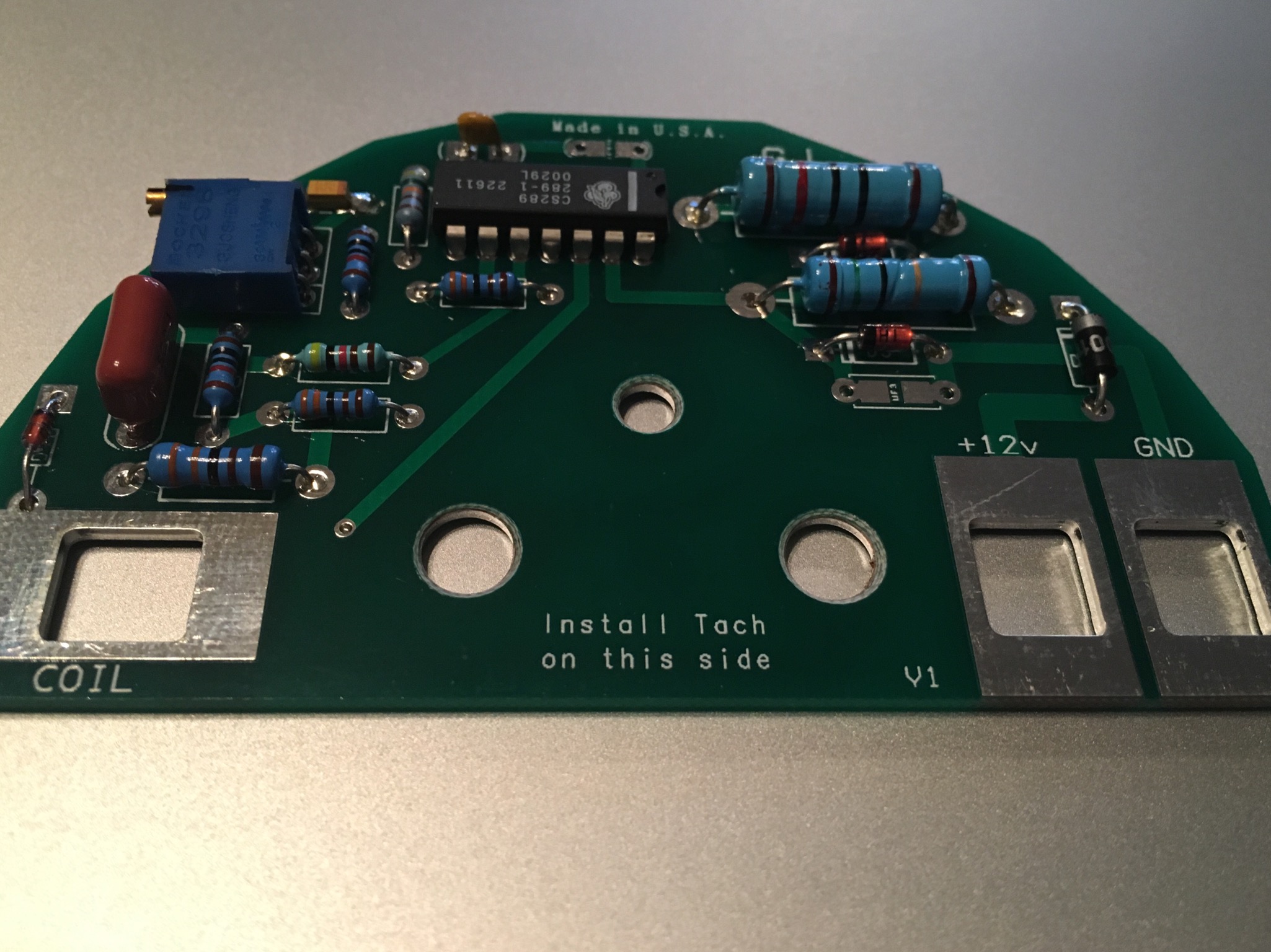

oh. I ordered a "new" circuit board for the tach from eBay. It *should* convert the V6 tach to a V8 tach. We'll see how that goes. Maybe while that's out I figure out the wiring on the oil/temp gauges and get them working, too.

Forgot pic.
Ooo and this comes in the mail just as I get her put away for the night. I Know what I’m doing tomorrow.
Should convert the tach from v6 to V8.
