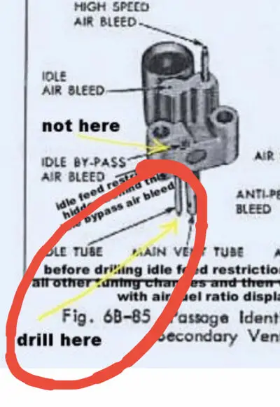

So with WOT and keeping the restriction of the choke, you stay around 5in/hg. You basically got a DIY power valve going on that's keeping the overall inflow air rich. A/F gauge would line this out very quickly.
So basically...
More fuel. Open up the pickup jet... You get a little more fuel... Stay a little bit richer.
OR
Reduce air flow. Swap out 750 to 600 Carb. Reduce primary bore size to 1.44... Increases air speed, strengthens vacuum signal, picks up the extra gas it needs, but reduces the excess air that was keeping it lean. Secondary Bore stays the same, so shouldn't be any changes there.
