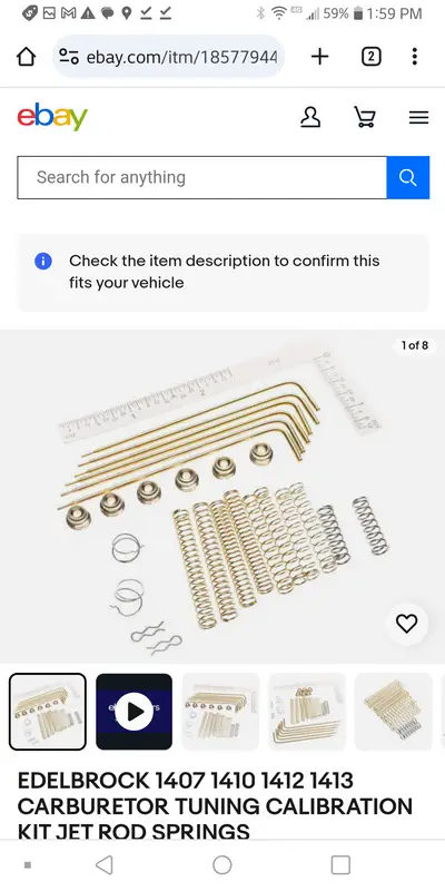

I am a little confused by the manual. Would this be my idle circuit or my primary circuit?? What should I do next to richen my off idle mixture??
