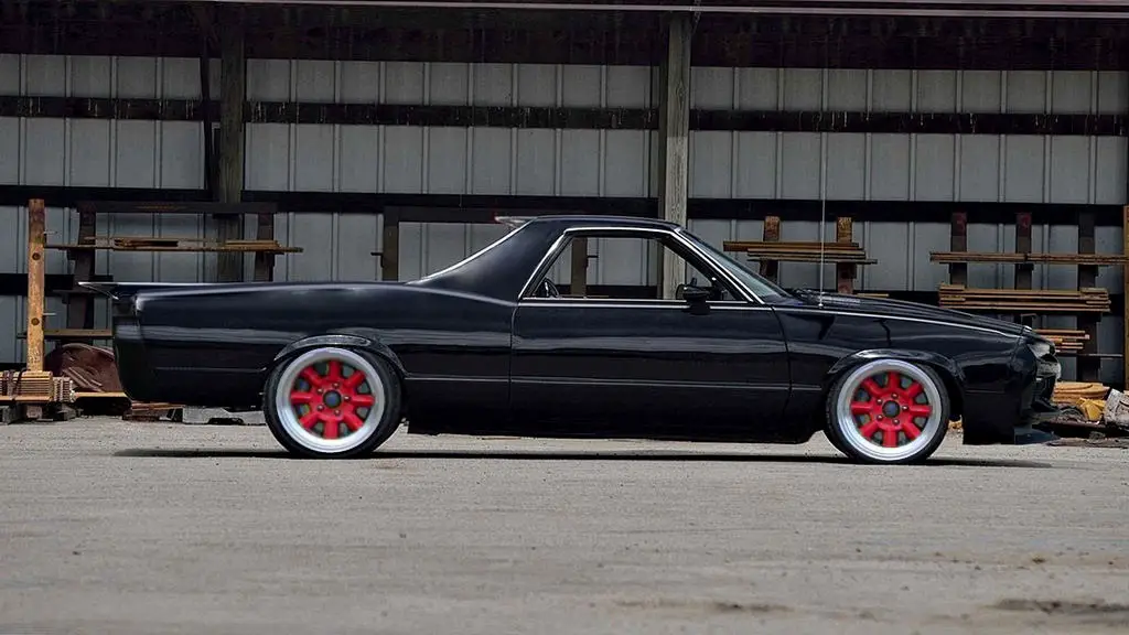

Black!!!!!!!!
You can't "Rat Rod red" the wheels on a car like that!!!!!
I know what you mean about those inner sail panel pieces. They were in the way of the wagon roof structure when I put mine together.
Your ride is looking cool as hell. My personal choice on the wheels would be the Lites w/polished rim and gold/chrome spokes on a black car.

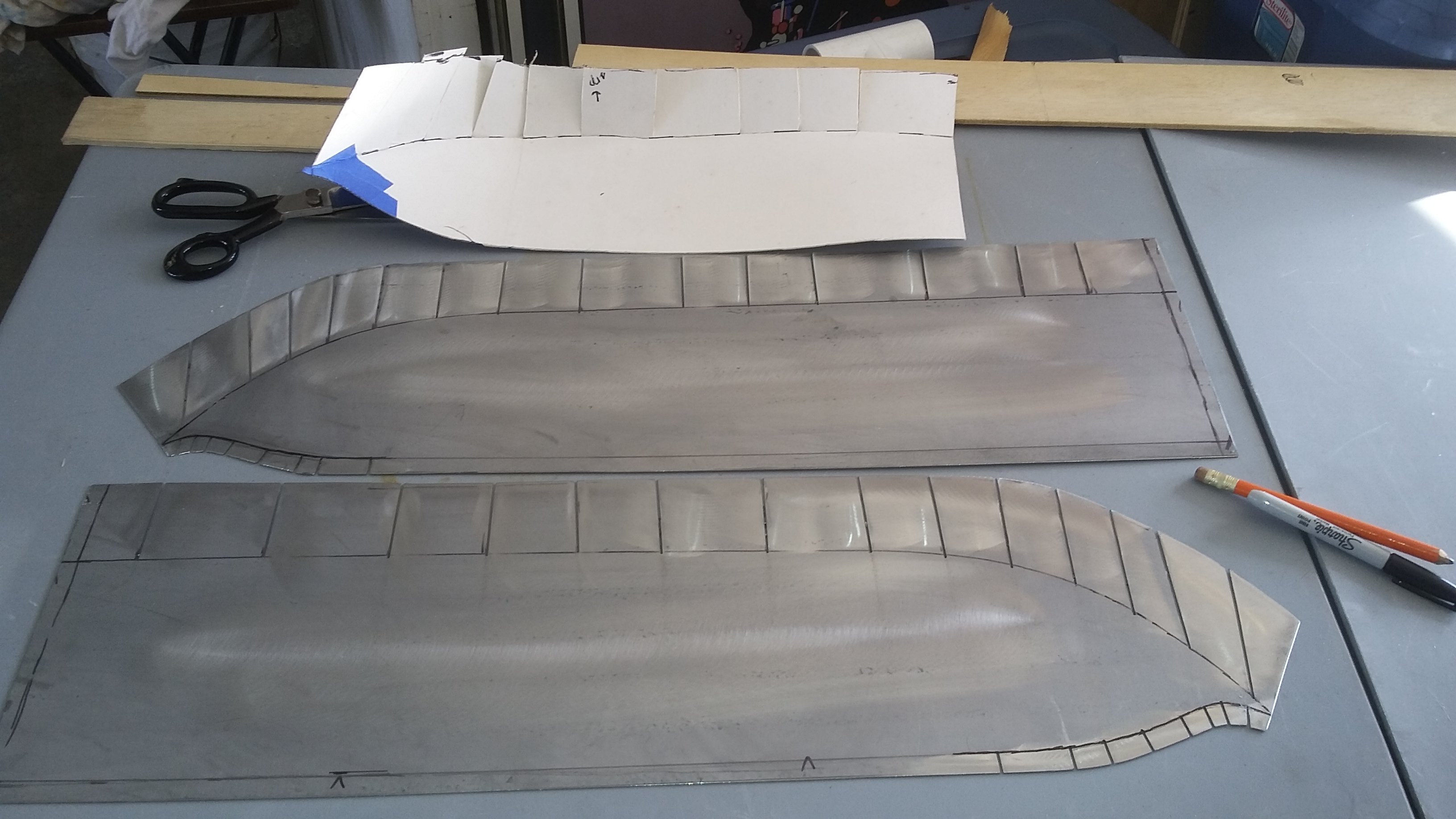

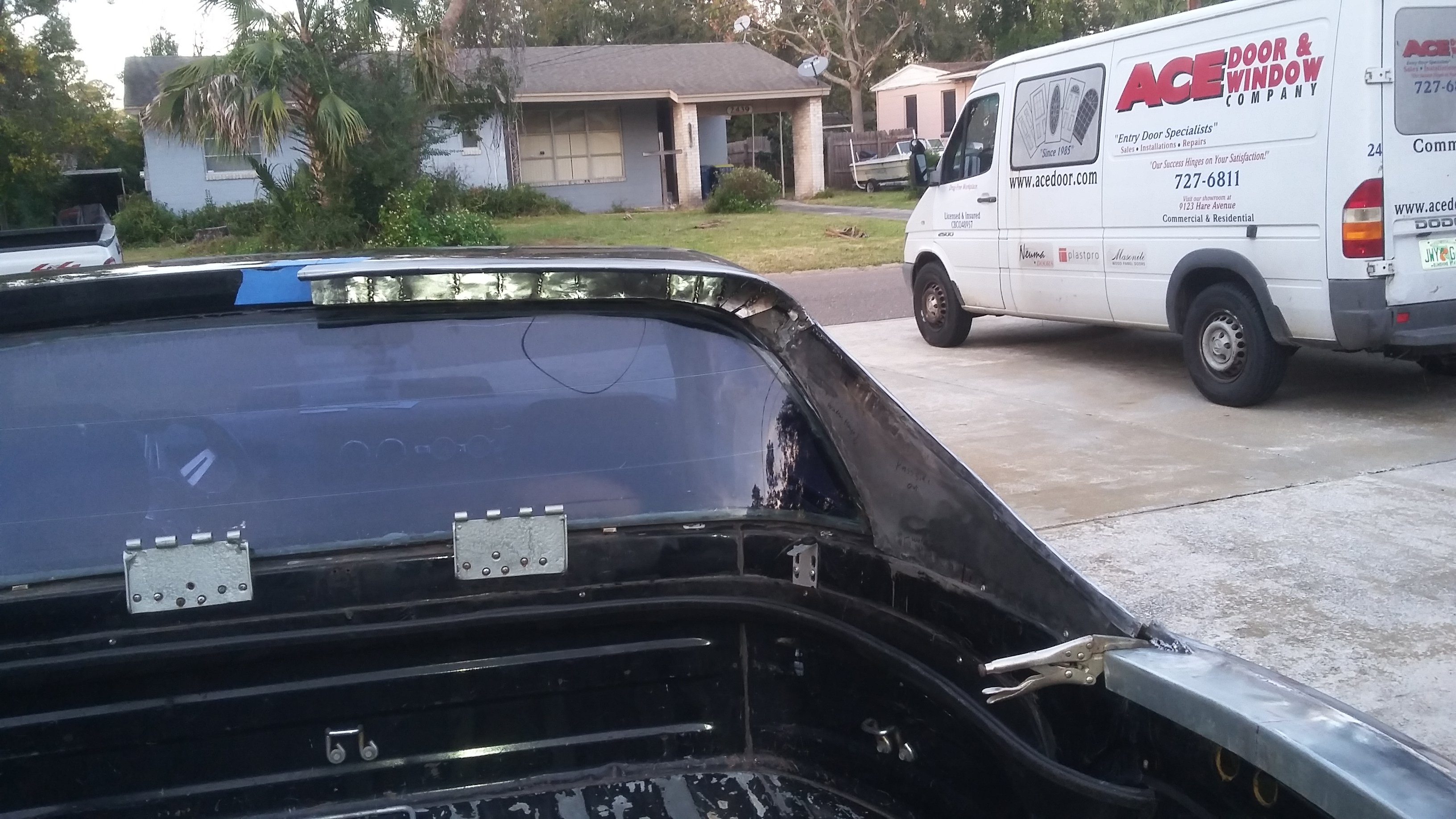

Finished template for upper side of visor & got partially done. Figure on fully enclosing bottom with sheet metal angling from outer edge to slipping into gap between glass & roof so glass trim won't be needed.. Still need to figure out how to attach, don't want any exposed fasteners. Using stock perimeter trim attaching points to help locate part.
Attachment could possibly be just bonded in place OR possibly bolted through from inside with headliner removed, though I can't remember if inner roof structure will allow access to rear upper wall? Doug?
Reactions: Rktpwrd and TURNA
Attachment could possibly be just bonded in place OR possibly bolted through from inside with headliner removed, though I can't remember if inner roof structure will allow access to rear upper wall? Doug? View attachment 102137View attachment 102140View attachment 102141
I haven't taken my headliner out to be able to answer that? I would figure even if it's in the way, use an appropriate sized hole saw on the inner structure to reach a 1/4 In. drive socket with a nut to fasten it. At 3:20 am, that's all I can think of right now.
When talking about red centered wheels, I was picturing a darker, more candy looking red. Kinda like my intake butterflies, not some orangish red.
Just as soon as I posted the red wheels pic, I got the 2nd one & I think my heart skipped a beat. A guy in Switzerland on the camaro 6 forums did the wheel swaps for me, so thanks to Chris vr6.

Guess I'm happy with visor shape up top, think I will just bond it on when done &epoxied.
