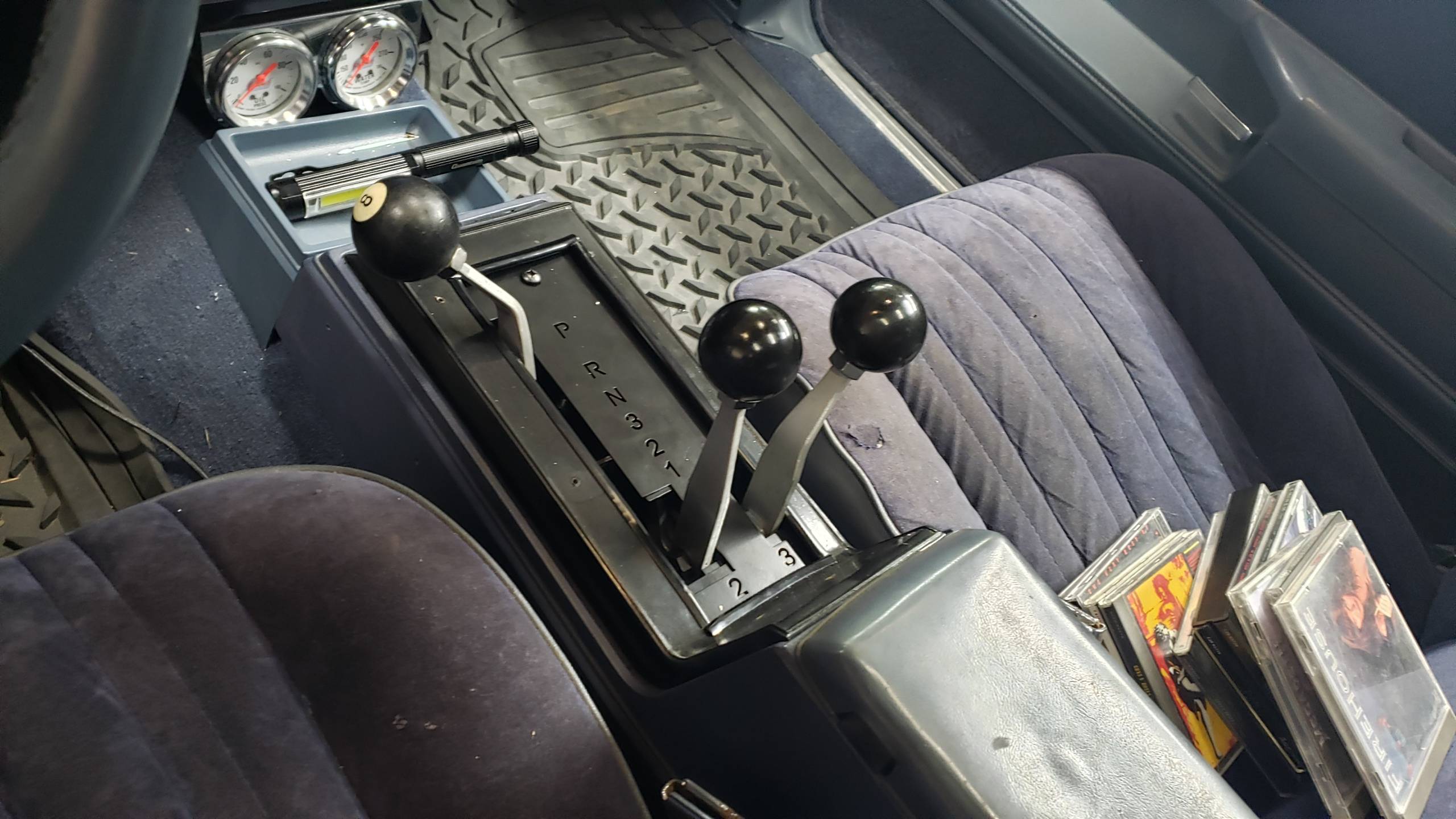

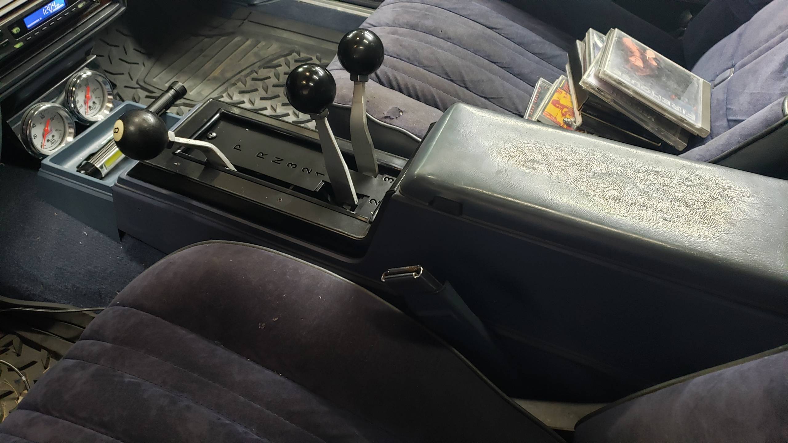

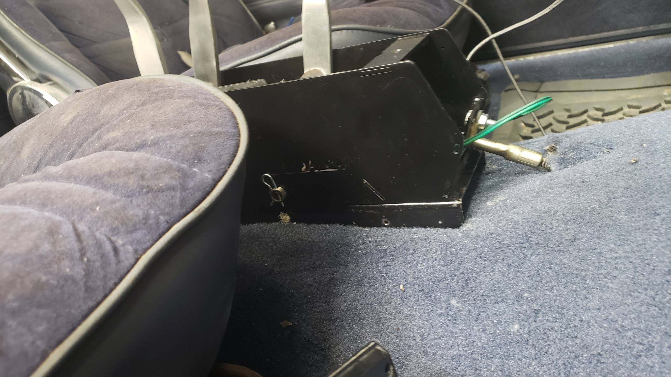

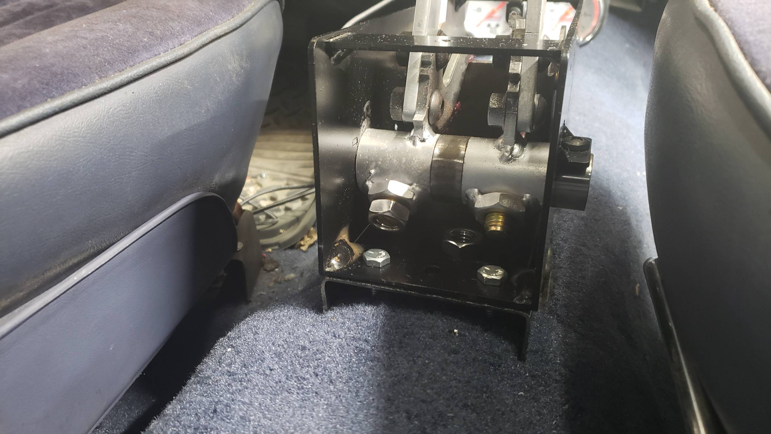

Got the shifter installed today. Because of the shifter mount i had welded in i had to shim the console up a bit to make it look right . Back up lights are hooked up and functional. Cable is adjusted. I need to get some small gauge wire to run for the led light in the indicator still.
I also heard back from holley, the the flowtech afterburner headers are not discontinued just severly backordered for materials.so some day the new exhaust will still happen.
i realized also today that if i ever get an actual cutlass console I'll have to cut my shifter mount out. I found nice regal console but it is flat not raised for an armrest area.

i realized also today that if i ever get an actual cutlass console I'll have to cut my shifter mount out. I found nice regal console but it is flat not raised for an armrest area. View attachment 194617View attachment 194618View attachment 194619View attachment 194620
Not sure if you knew, and it's first time since you posted a ways back it clicked in my head skimming to the update post, but....
You know that a regal console uses the same bottom half and general level for the shifter plate as the cutlass one right?
You could do the busy work of brackets and geometry to install with a regal console and then just swap in the top 1" (I guess more if you count armrest) onto it when you found a nice top half later...
