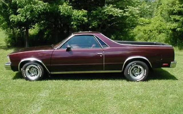

1978 El Camino, Factory buckets and console, 1982 Monte Carlo tilt Wheel. Motors a 84 305 H/O. rebuilt and upgraded 1978 Quadra jet on a factory aluminum intake.. Stock HEI with lighter springs Accel coil and Taylor wires. Flowtech 31104FLT ceramic coated headers, 2.25 true dual exhaust with a X pipe out to the bumper. Champion aluminum radiator w/ dual electric fans from a 1999 Malibu.1969 TH350 gone through, 2100 stall converter, Fair banks shift kit. Rebuilt and upgraded 7.5" 3.23 gear and a posi. . Stock front suspension. Stock rear suspension with polyurethane bushing. American racing rims 15X8 w/ 245/60s on the rear the front is 15X7 w/ 215/65s.

Nice but i was just referring to the fuel setup lol
