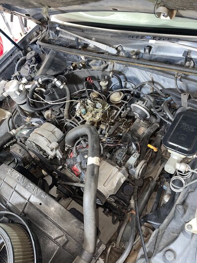

Doubt question but can’t seem to find my fuel lines on engine . I see them from the fuel tank after that they are tucked in and can’t see them. Anyone have diagram

Sorry no diagram but it’s there behind the radiator hose in your pic, goes down to driver side of the timing cover where the fuel pump is mounted. From the fuel pump, yup it’s all in the DS frame.

Should be at front of carb. You need a 1 inch open end wrench and a 5/8 line wrench. Be careful not to twist the line off.

The fuel filter is in the big fuel line fitting at the front of the carb. Be careful about crossthreading it into the carb.
