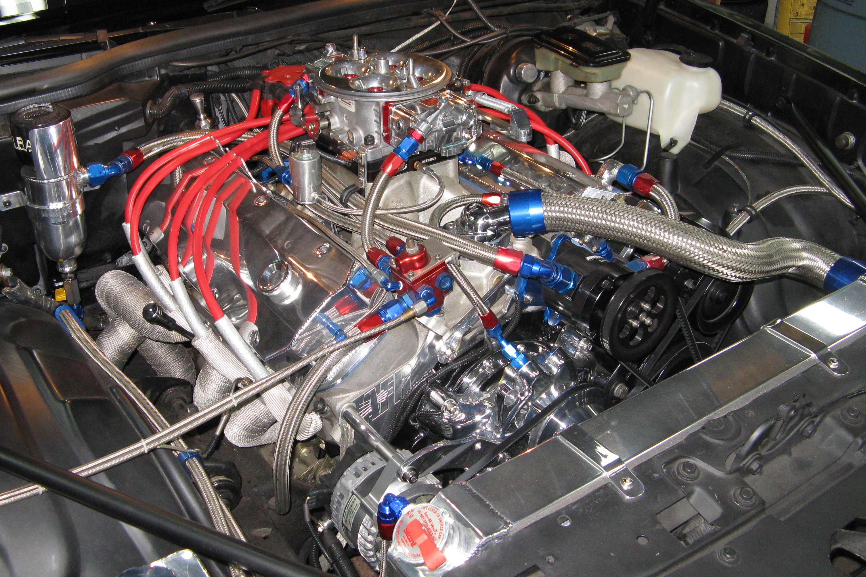

IMO get factory style stainless hard lines and connect with rubber over rear axle, at carburetor feed line and at pump. I am not a fan of AN lines only becuase they are a pain and realistically are rubber anyway. That being said if you spend the money...nylon AN lines and newer teflon lined stuff thats meant to handle crap in our gas or even alcohol/methanol are great choice as well!
