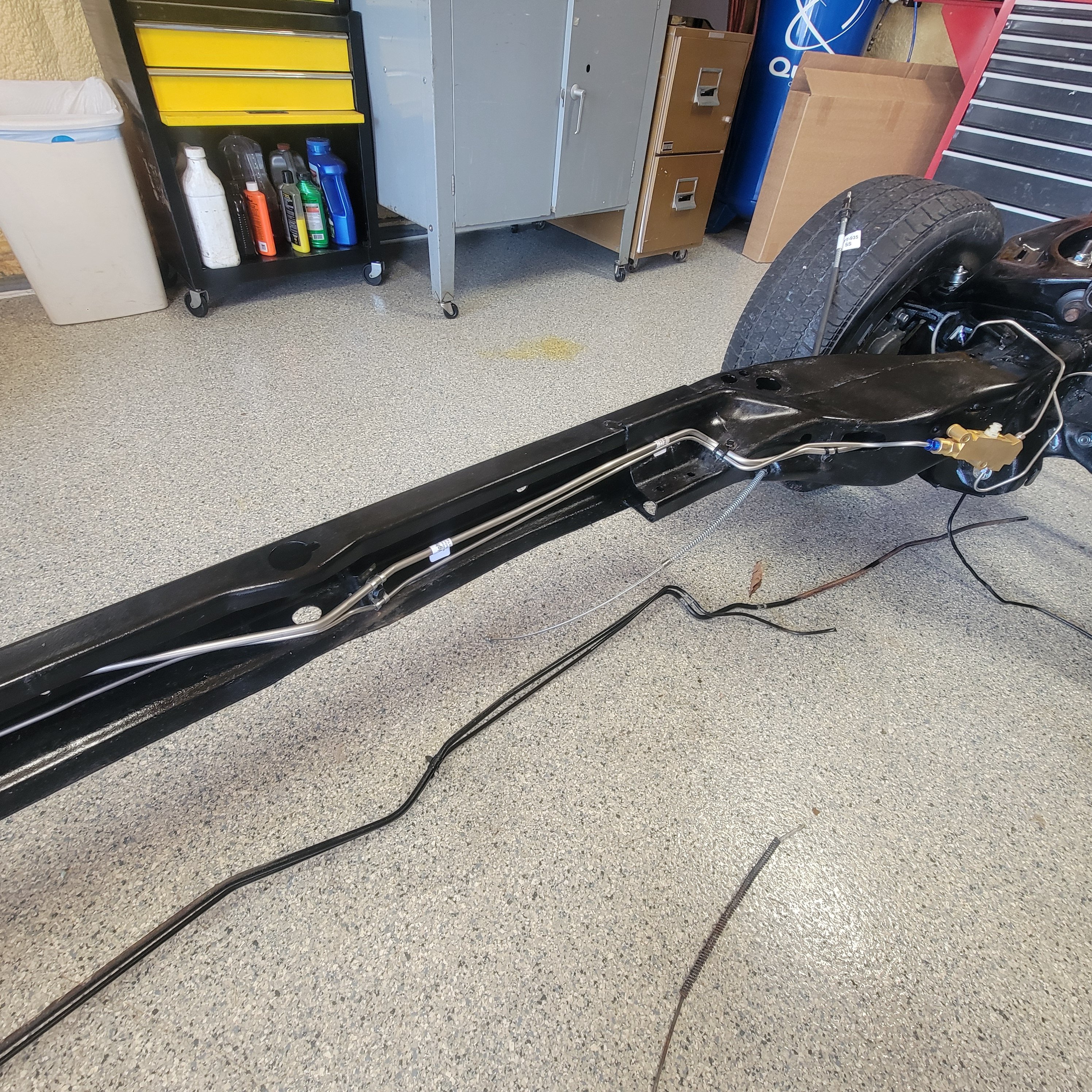

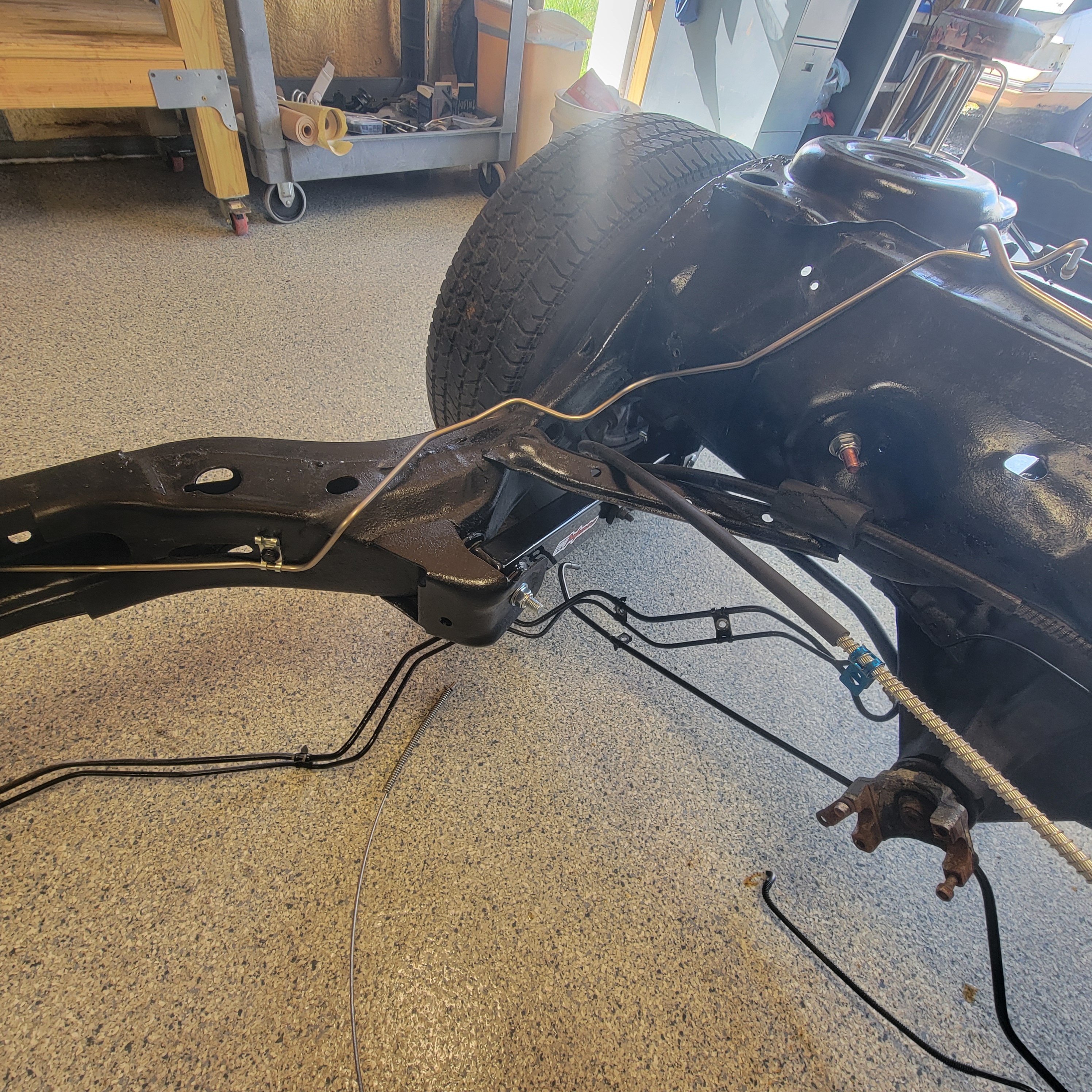

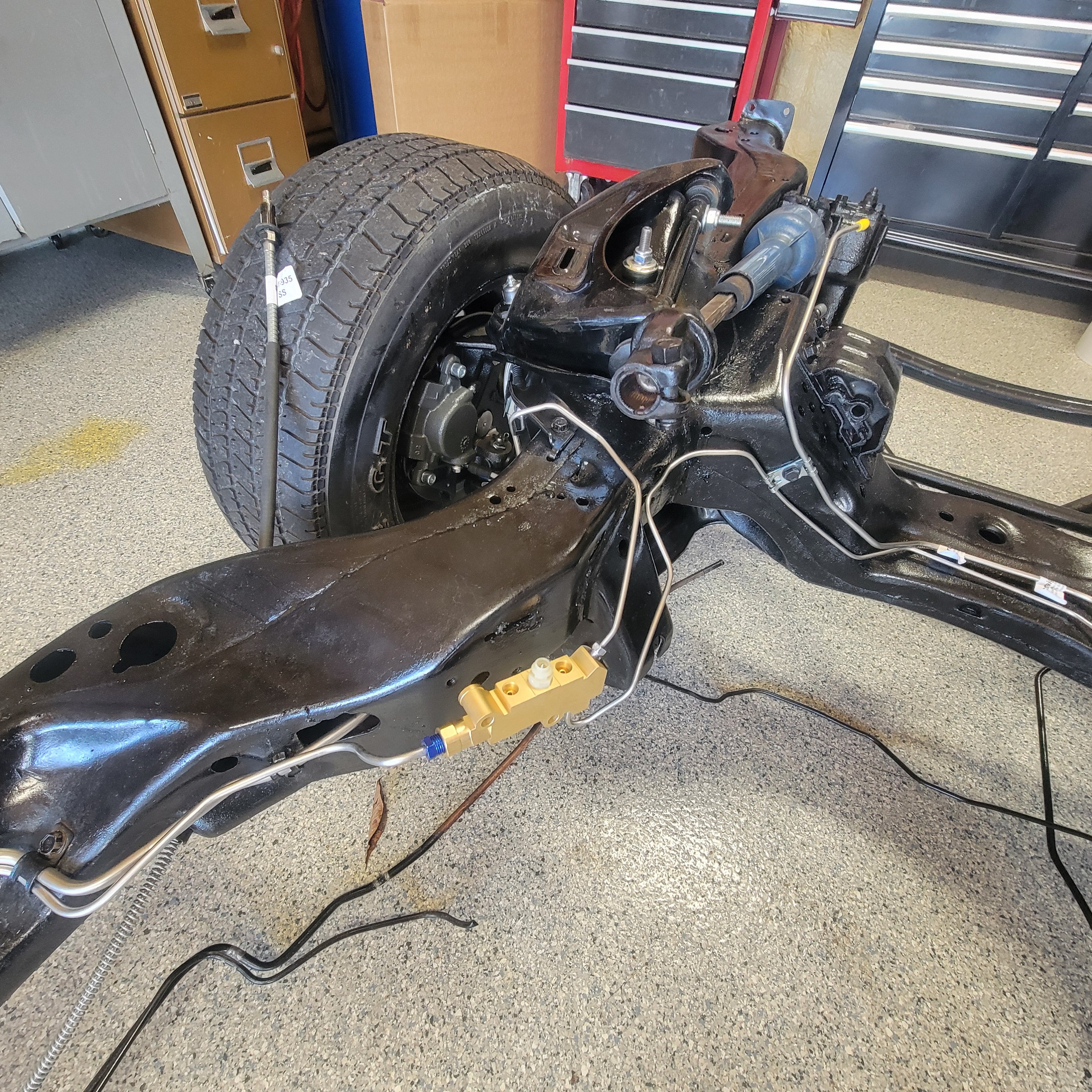

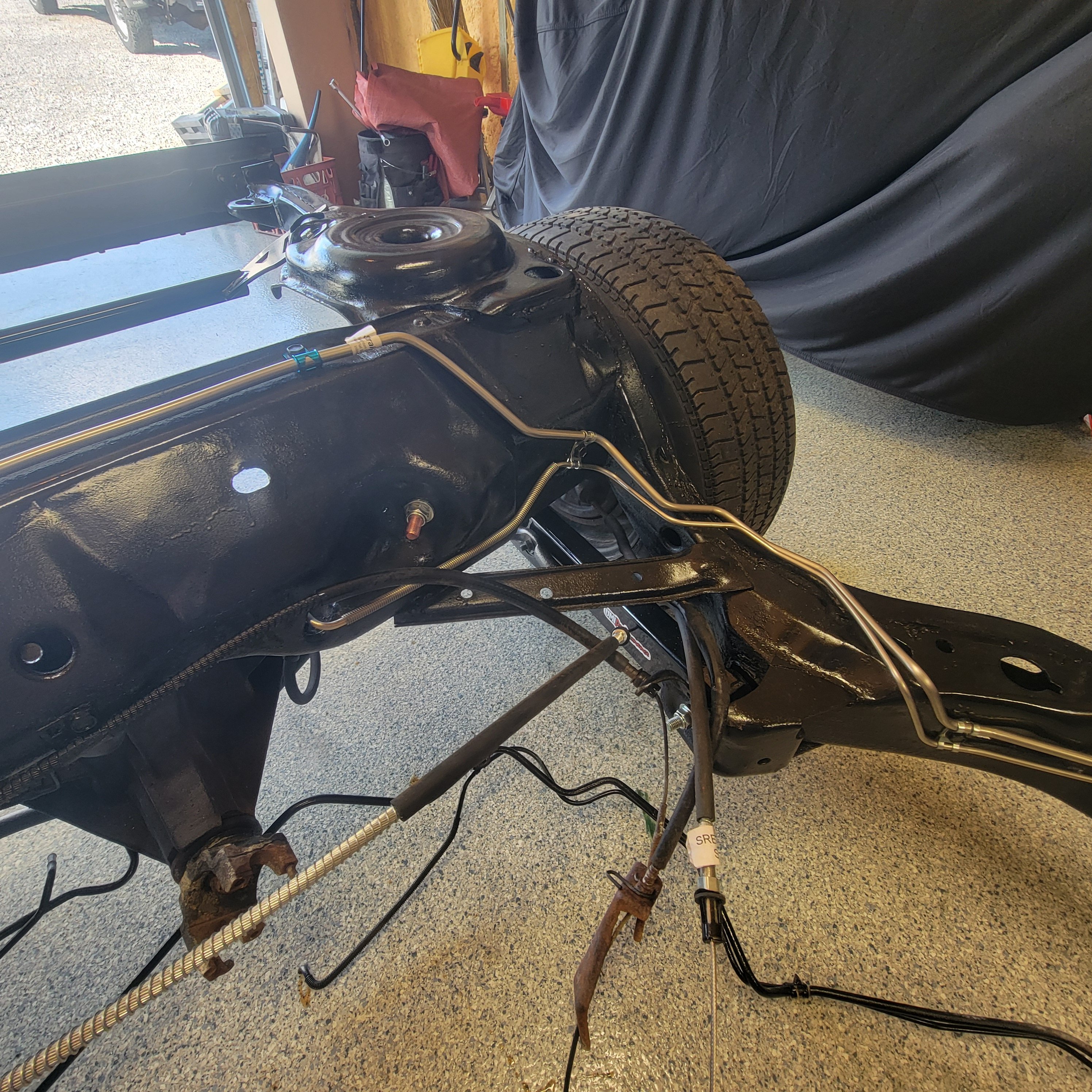

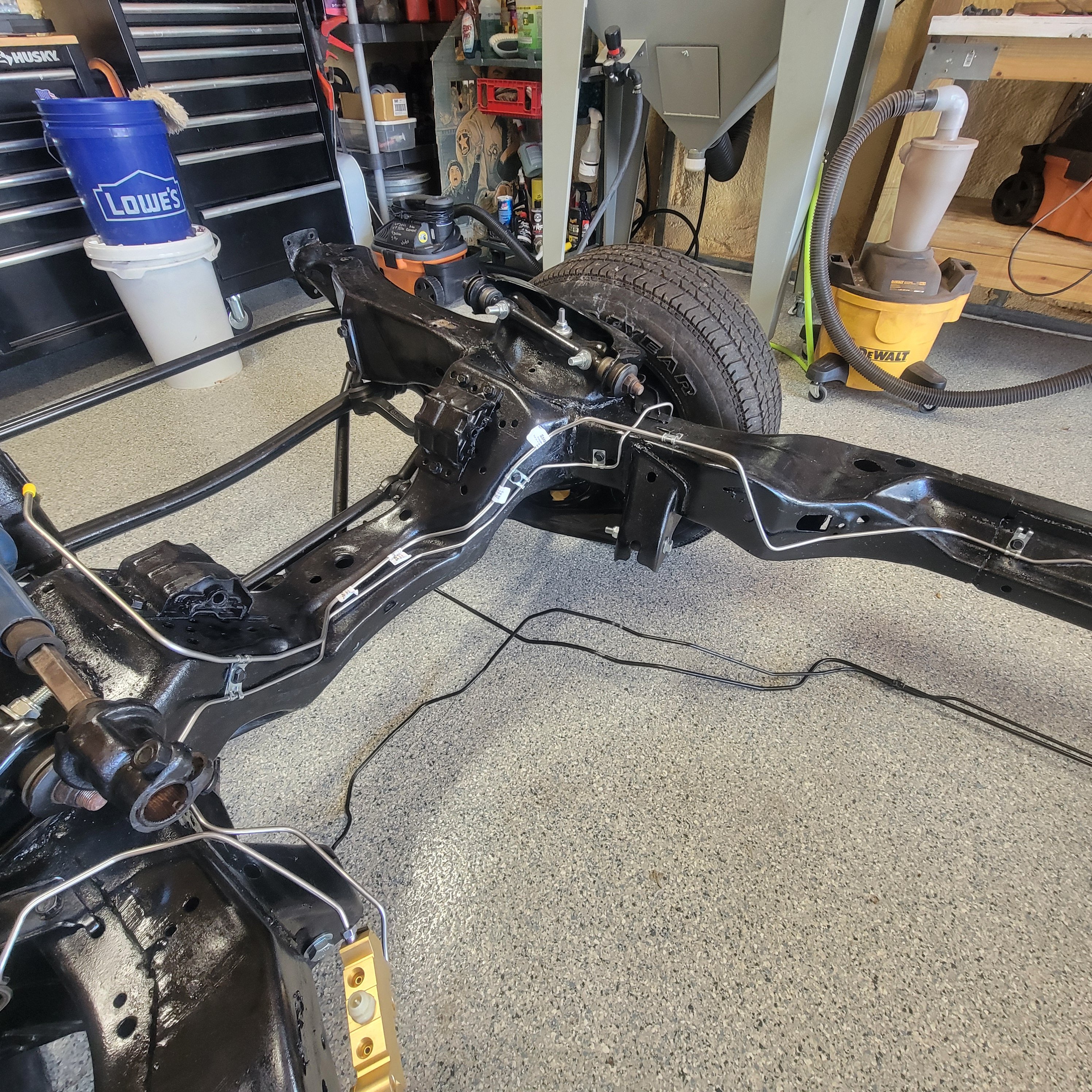

Finally had time to get these installed. All parts not listed/available for the Lemans were ordered as if I was working on a 79 Grand Prix.
Everything matched perfectly.
I must have forgotten the 5/16 vapor line, so I ordered that today (for Grand Prix)
We'll see if that fits.
So, all lines for the Lemans/Grand Am are available...

Well, the vapor line wasn't what I was hoping for. I did find a local builder that will make it for me. Other than that, all fuel and brake lines are available through inline tube.
