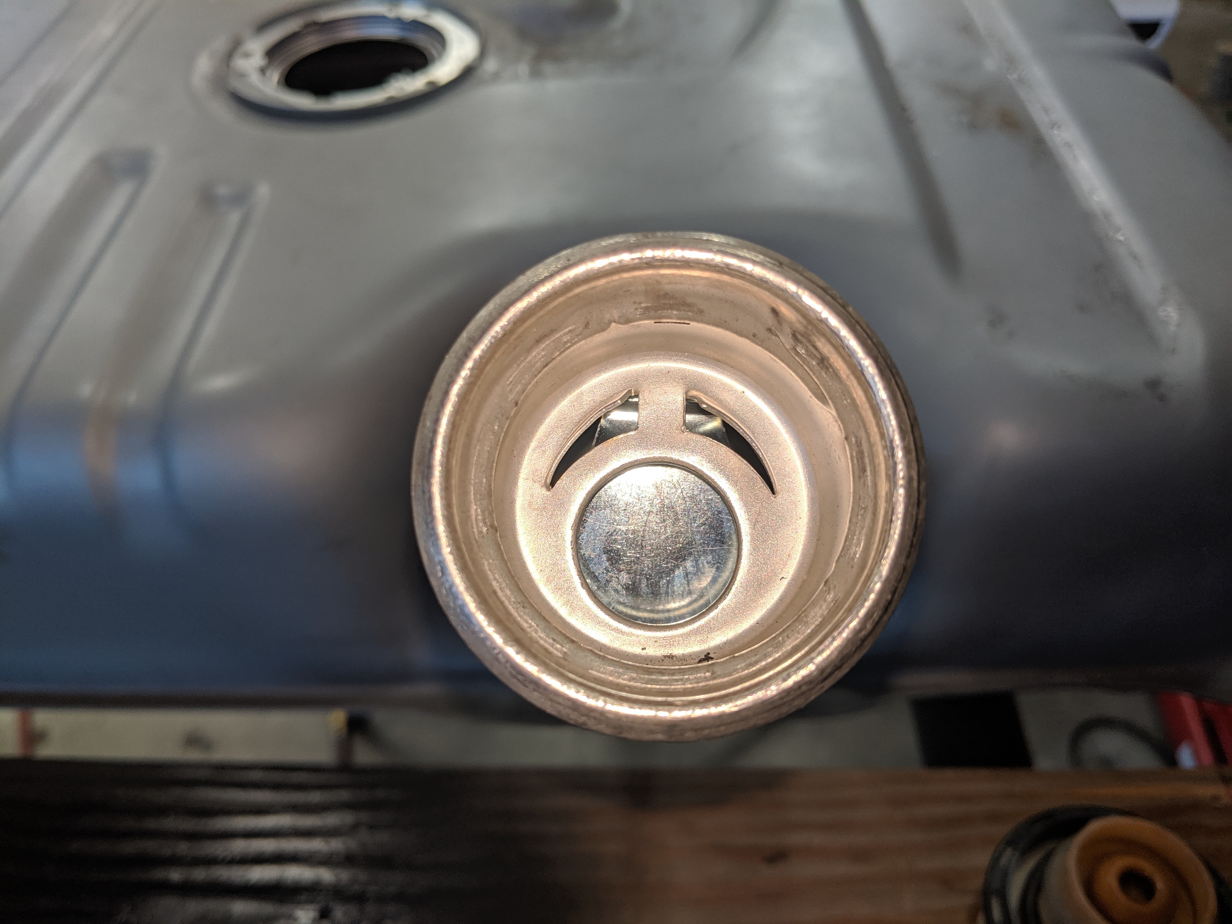

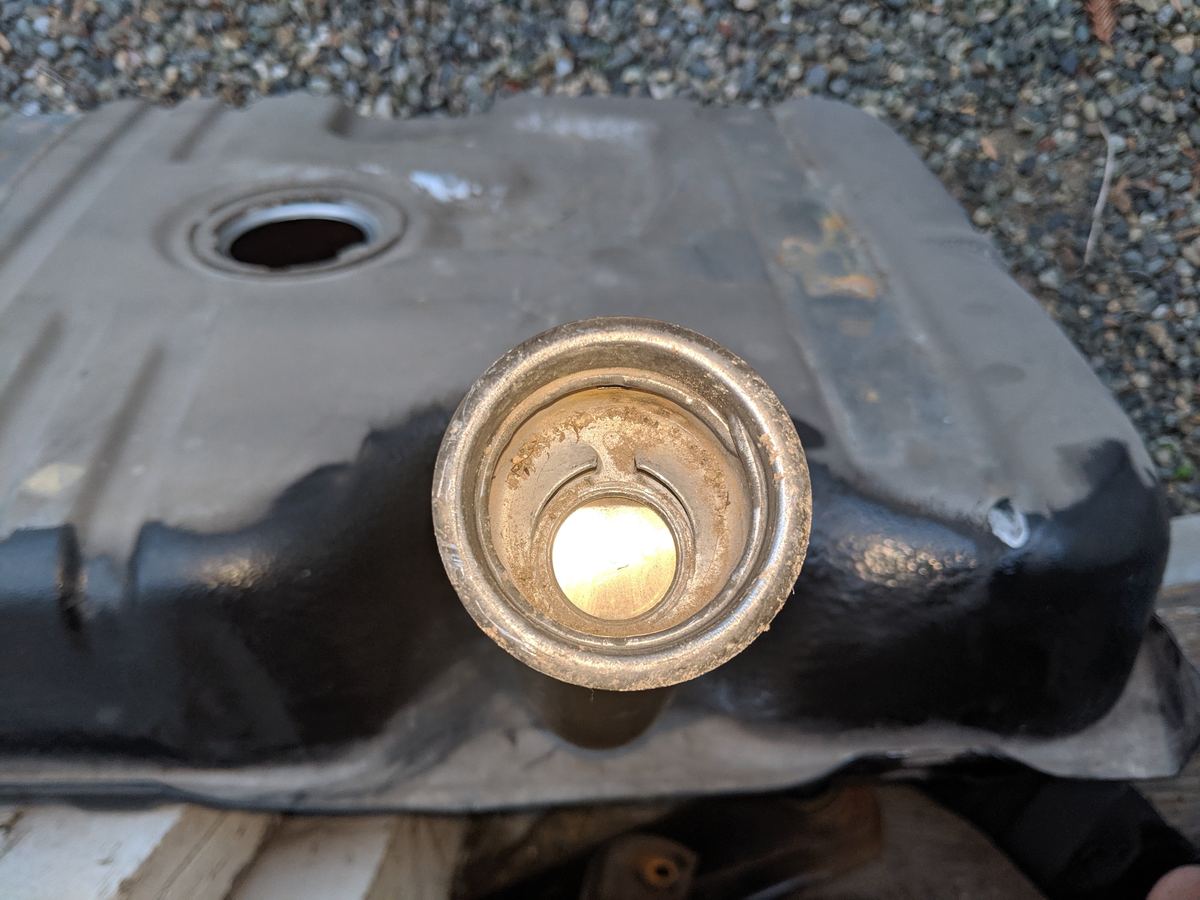

8 years ago but it was just put in the car in Feb.

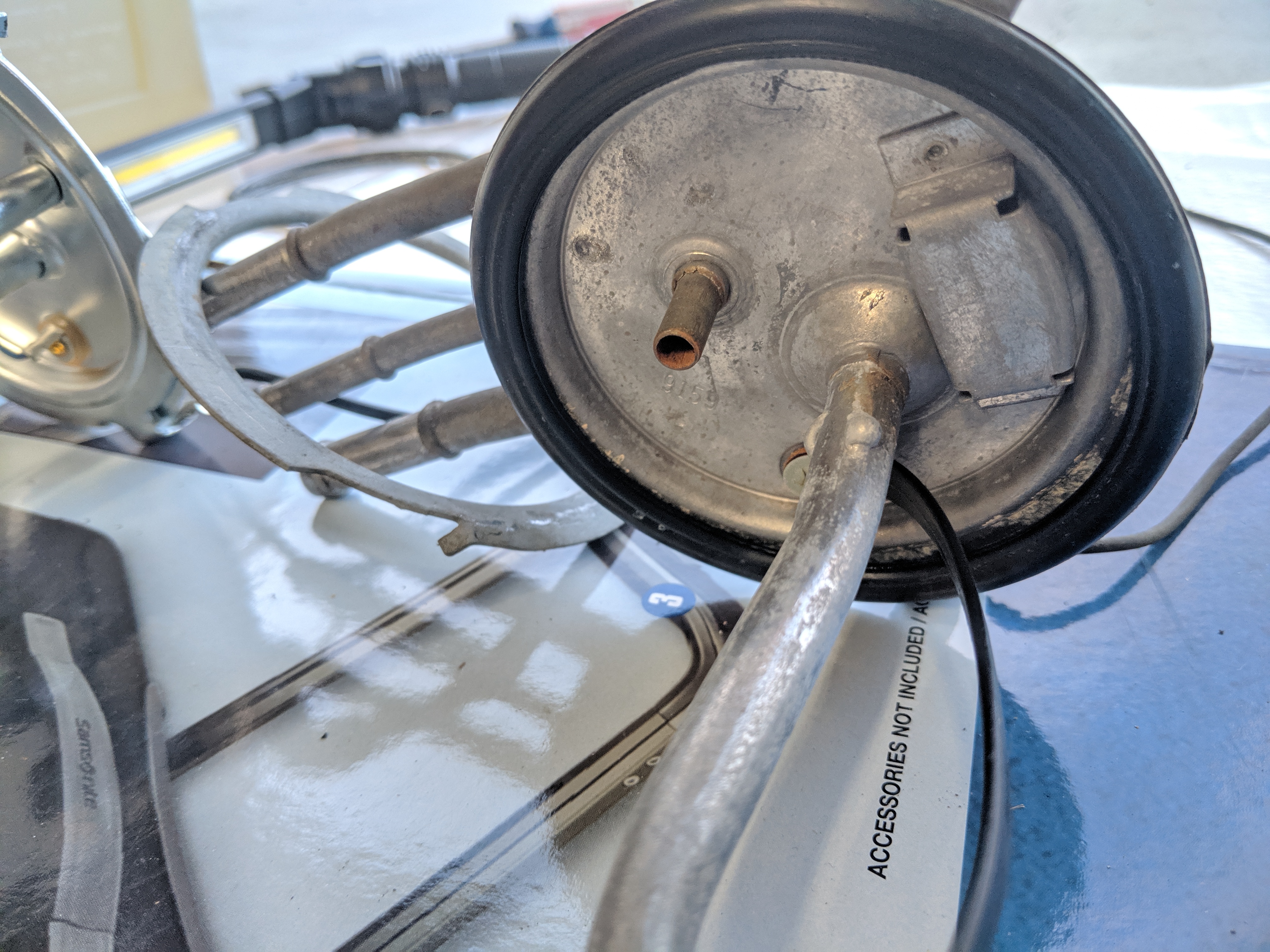

I also noticed that they've added a roll over valve to the new sending unit, and the vent in the neck of the new tank new is actually larger.
View attachment 113558 View attachment 113559 View attachment 113560 View attachment 113561
Like how new? Mine is less than three years old and it spews fuel all over if you get in any hurry. The only time I'm grateful for the peanut sized fuel tank in these cars.I was told by Spectra they have corrected the problem with the newer tanks
