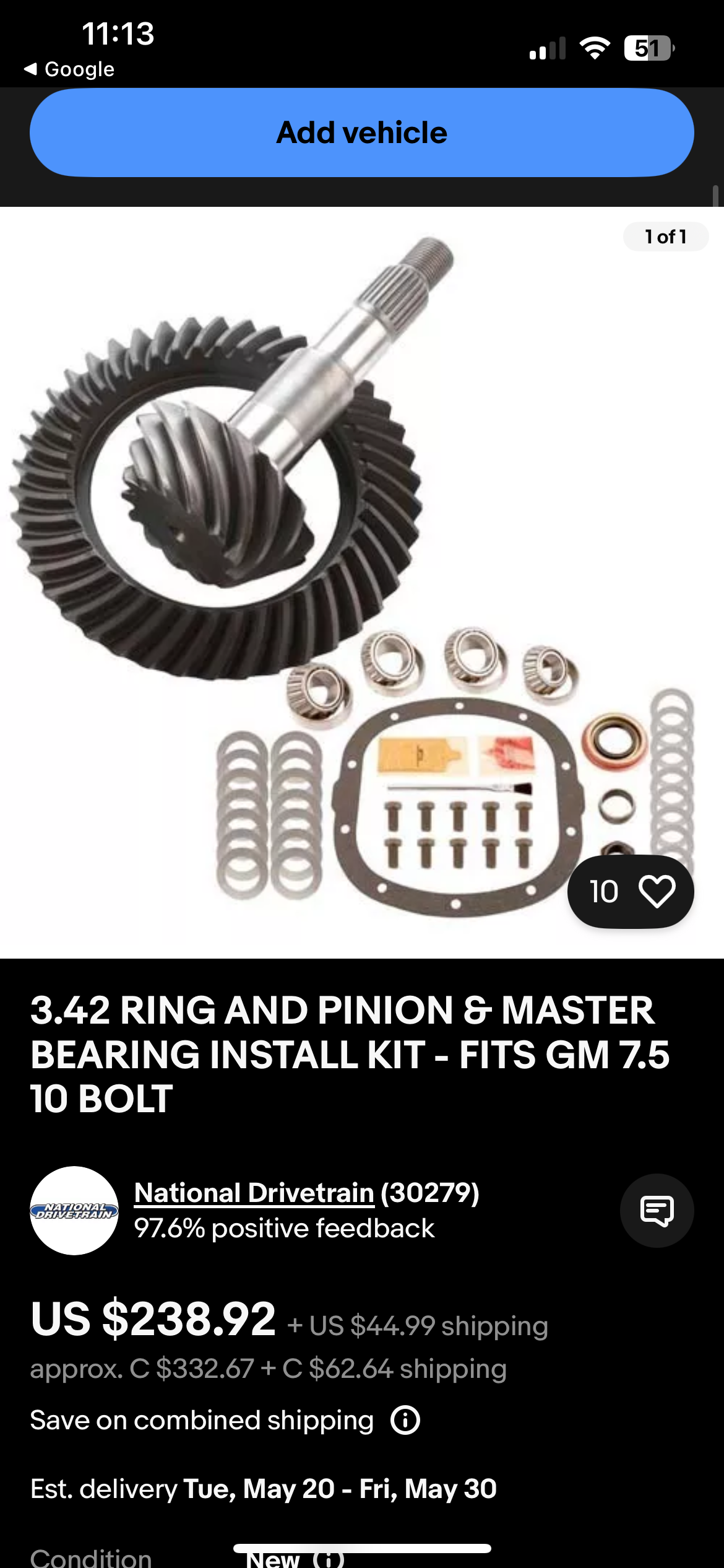

The thing that’s holding me back is that I’m really on a tight budget with this car, not meaning I can’t afford it but if it’s worth it I could, but for now the 2.29 might have to do
How about this?
Wrong for the axle he has, that's for an 8.5".
If funds are limited, look for a gear set that fits the carrier you have (3.08 and numerically less). Once you are into a 3.23 and up you'd need a new carrier. If you can turn up a cheap set I'd put a 3.08 gear set in and not look back, esp with 3 spd auto and a budget...
I just realized that, I’m pretty sure this is what I need, that 2.29 ratio is going to be garbage on acceleration, and this won’t change the gas mileage that much

With the kit I’m looking at all that matters for fitting is that it’s a 10 bolt 7.5in 26 spline, that’s so it can fit my housing and axles the rest in just installing which I would need to figure out with the shims and what not
staying with the 26-spline is going to be the main issue. that really limits what you can swap in/out unless you buy new
What do you mean new? The whole kit I showed accommodates 26 spline, I shouldn’t have to swap out my axles
