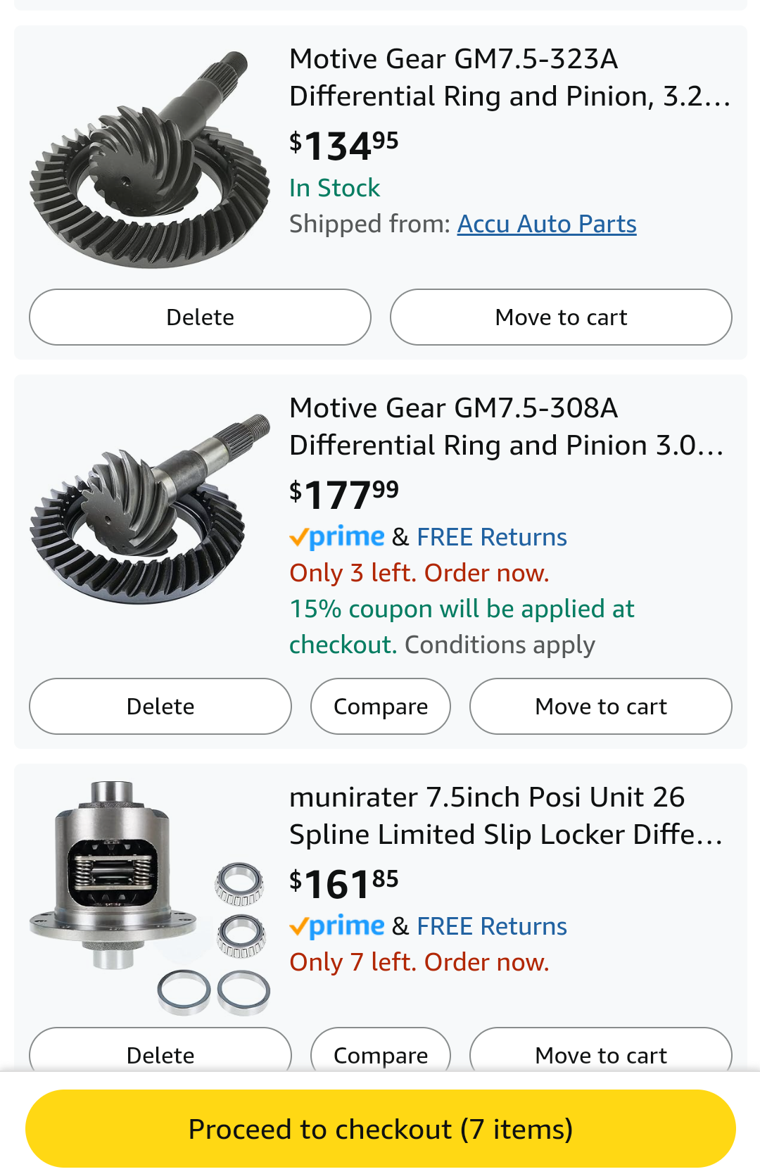

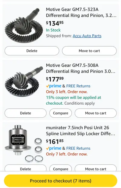

If on a super tight budget then grab these and an install kit (2 gear choices shown). The Chinese posi is for 26 spline axles so it'll drop right in, and it's available from 20 different sellers on Amazon as well as eBay. Motive makes great parts and has at least two performance levels that I recall- the parts listed are the cheap ones and their others are $100 more, Richmonds sometimes whine on the street, U.S. Gear and Yukon are about equal, and sometimes 3 of the above brands show up in each other's boxes (same manufacturer):
