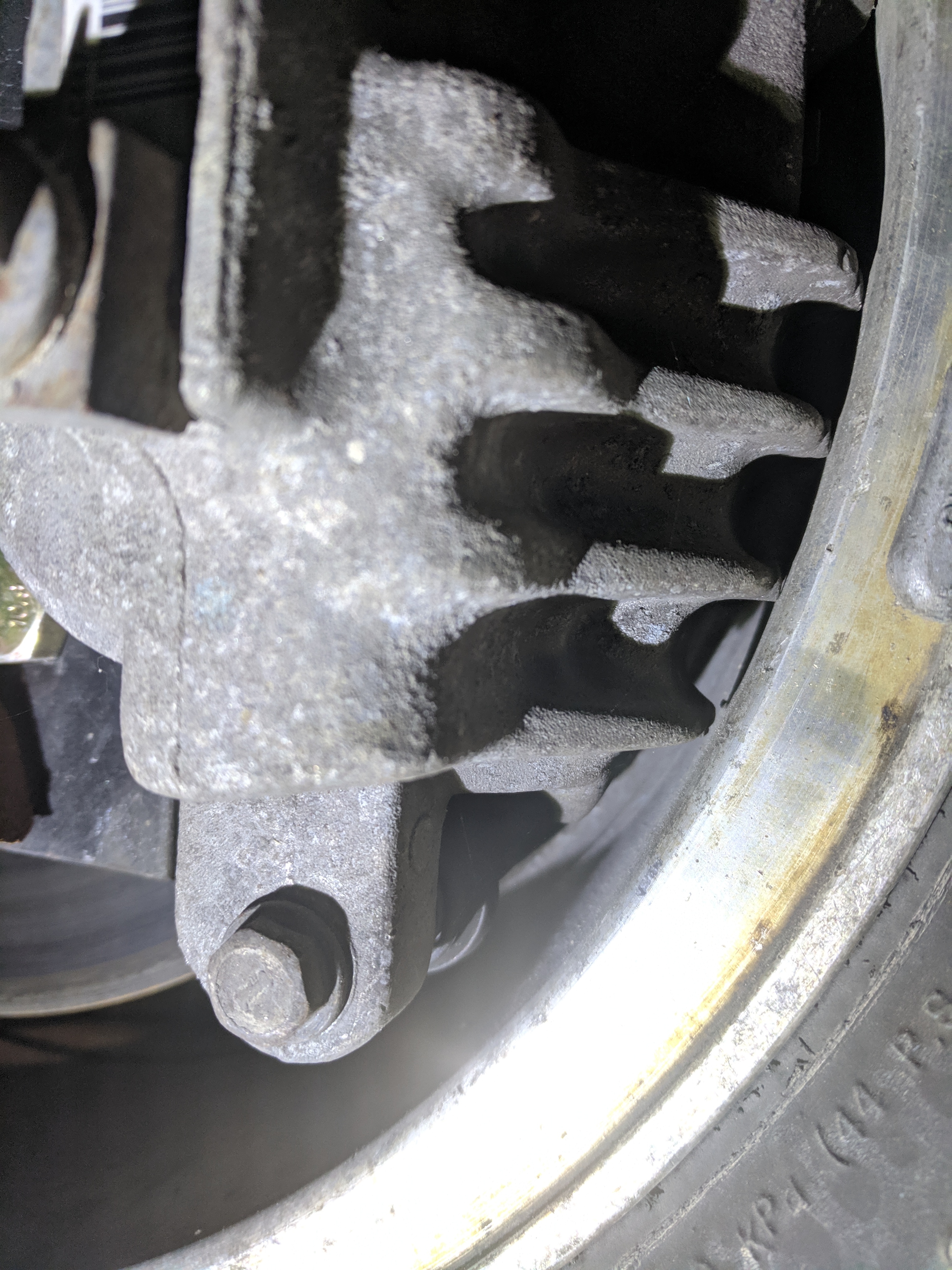

I don't think they will fit without spacers and the LS1 brakes with spacers is super sketch. The broken stud on my LS1 brake picture was done without spacers. Wheel adapters might stabilize things, but the LS1 brakes already space the wheel out almost 3/8", so a narrow front tire is required if a spacer is used.
Ok I found my proof! Lol.
That is a t type vector on ls1 caliper setup, no spacer. I called BS that it would fit too but a local g body guy had ls1 brakes on his MCSS with the stock wheels and he said it cleared with minimal grinding on the fins. He claimed most any 15" aluminum wheel would clear and I tried my t type and by God he was right.
The tire would only turn 20 degrees before the slight run-out in the wheel started rubbing but a 2 minute shot with a flap wheel would clear.
You can grind the ribs down, .050" and they will fit, but the problem I had when I first installed them was with my new pads, the outer face of the caliper wedged against wheel web. I had just painted the calipers and scraped large chunks of paint off and the caliper couldn't properly float.
