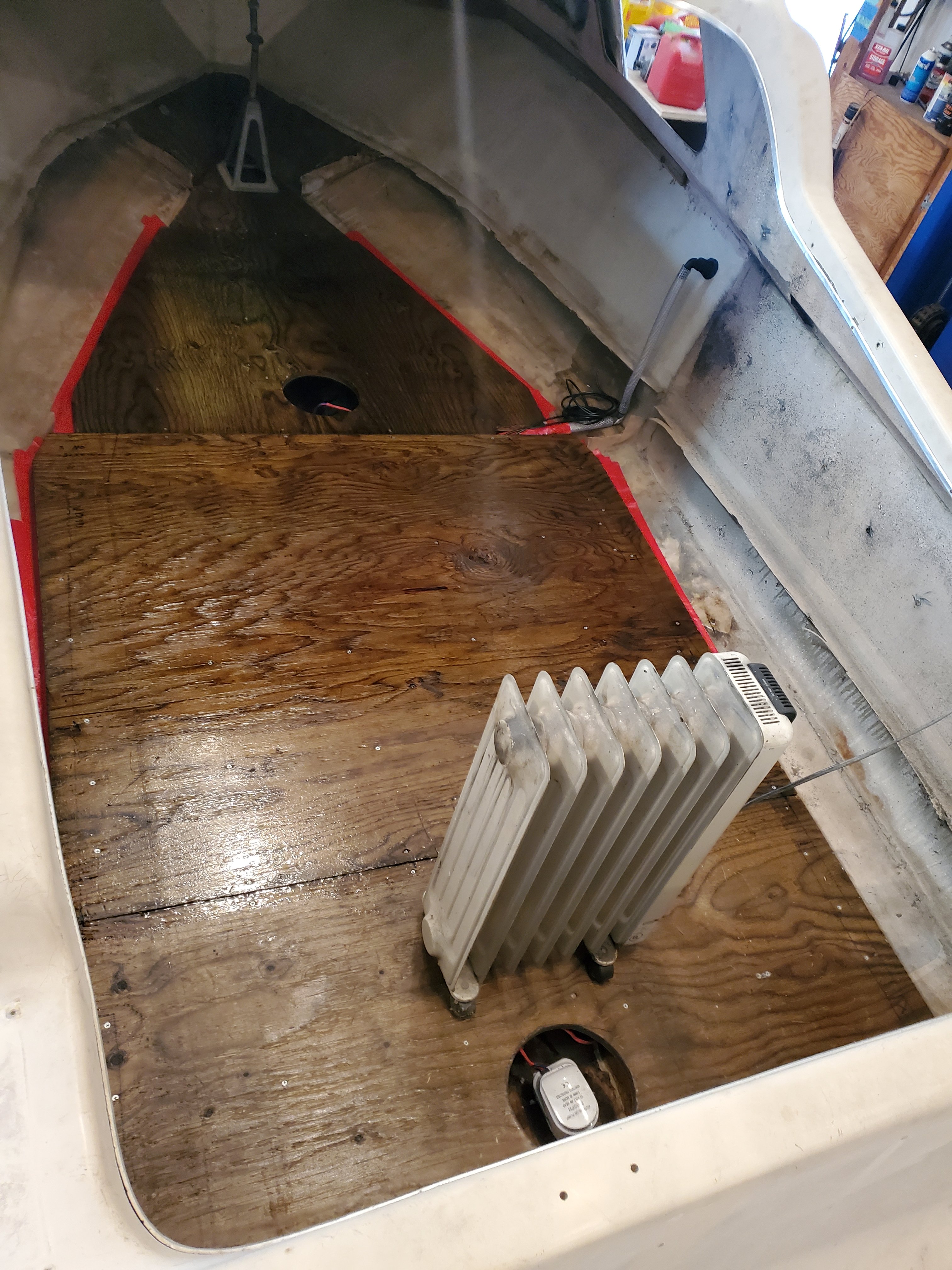

All the floor structure has been laid in. Everything was coated in resin after being glued and screwed.View attachment 251086
Bilge pumps are plumbed, pre-wired, and placed. There are access covers that go over the big holes.

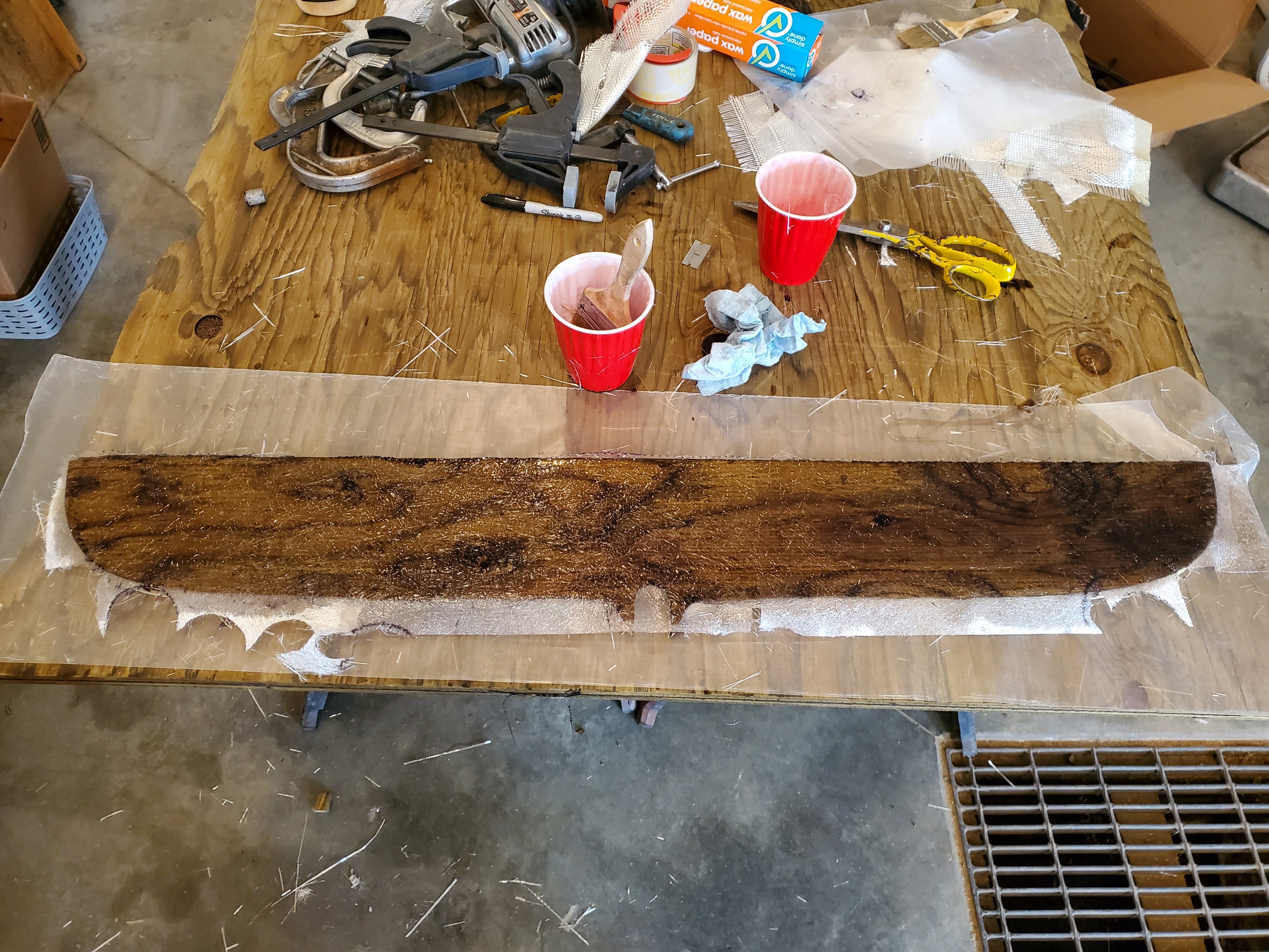

The transom was actually a lot more solid than I had expected. The portion that needed attention had already been replaced (poorly) some time in the past. The new piece has 2 layers of mat on the exposed side. It'll get clamped, glued, and screwed after it sets up.View attachment 251088

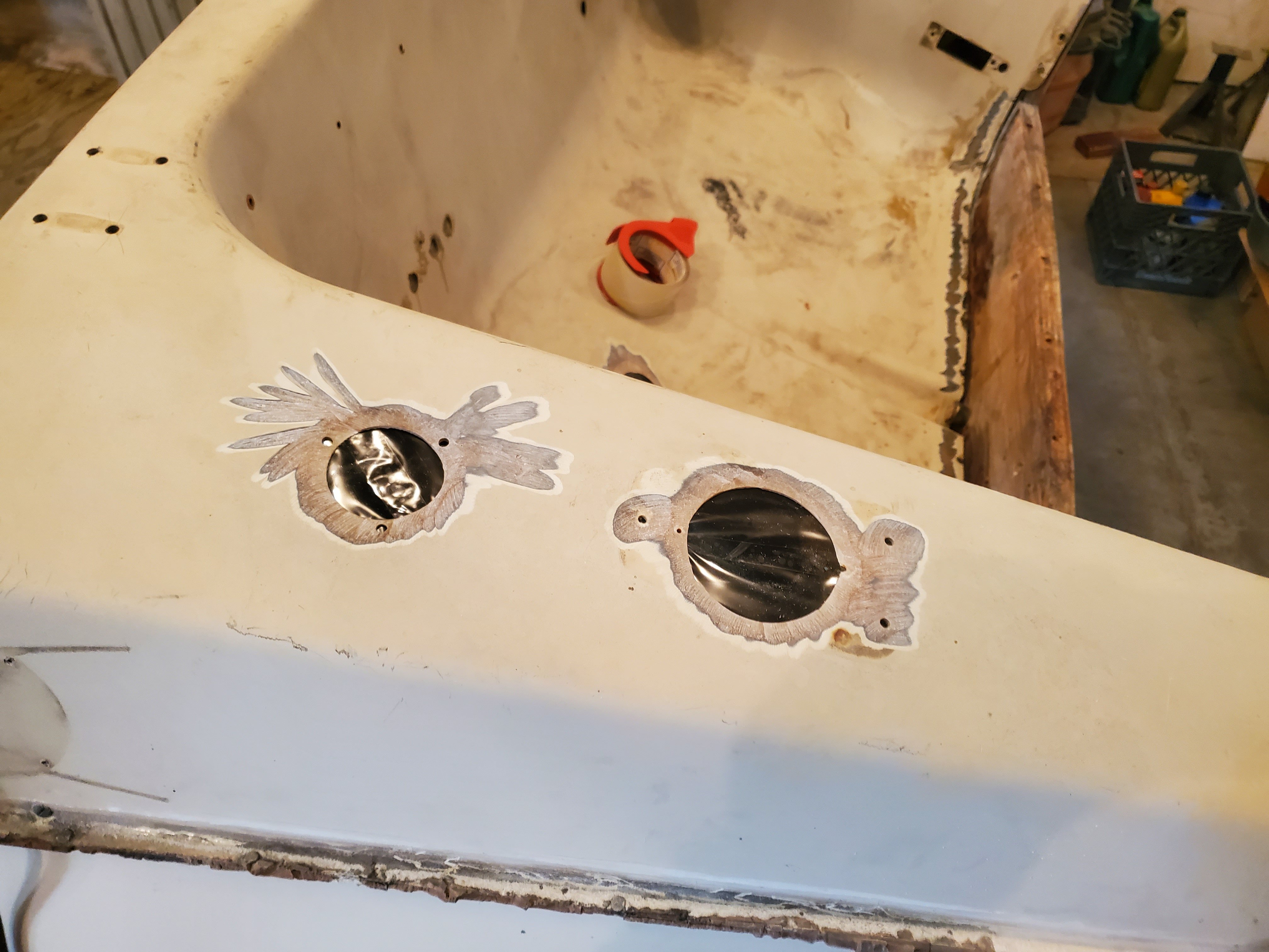

I started roughing in the patches on a bunch of unnecessarily added holes. There's a lot of this phase left to do.
View attachment 251089View attachment 251090
After the big holes are patched, there's many hours of tedious grinding and filling spider cracks in the gel coat.
