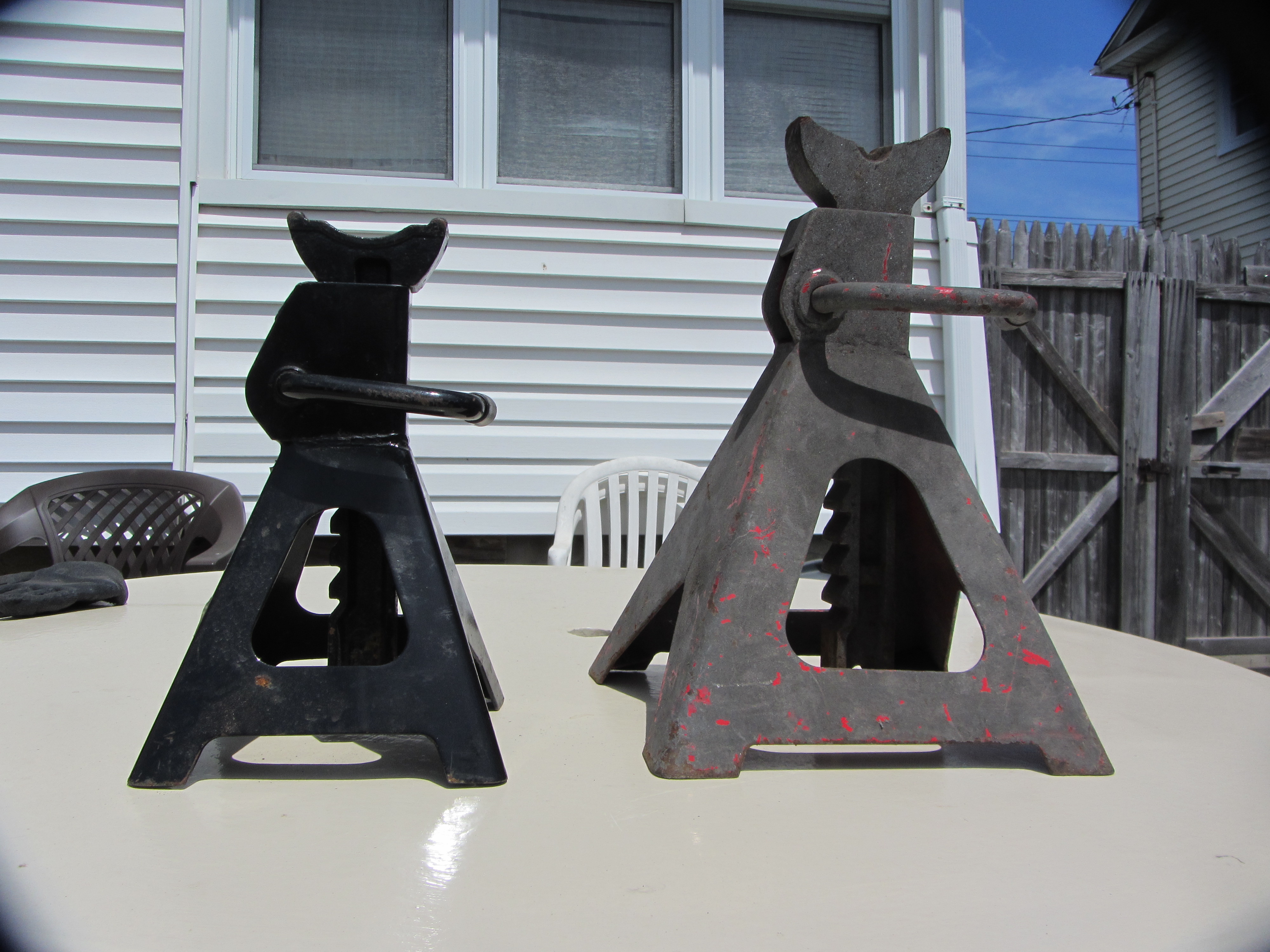

Thanks for the pics TURNA. Look what I have- the 6 tons are the old ones but the black 3 tons are from Sears. They are a ringer for the bad HF's. None of the release levers go as high as the bad HF's.

I checked both of my sets and they're both Pro-Lift brands. (Just sticker differences, most likely?). The model numbers don't match so I'm not sure if I need to worry about them or not. They seem well engaged and it takes a good amount of lift to unlatch them.

My Torins have slots and keys to lock the stands in position. They are different from my HF stands.
