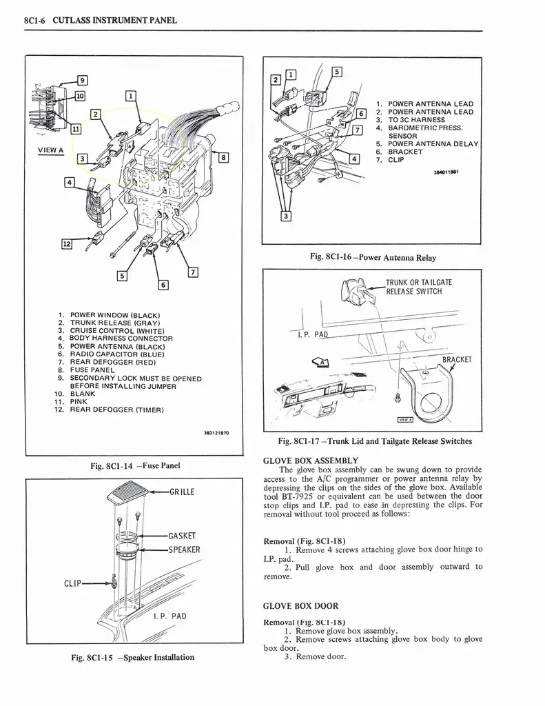

Hi everyone, I have a 1985 cutlass that had a soldi body but crummy intirior and wiring, so I found a rusty body and frame 88 with buckets console and a nice intirior, I took the Dash out and didn't take any pictures of where the wires plugged in [stupid me] and for the life of me I cannot find where the female plug for the curise control 12v constant plugs in.... if anyone knows or has a done laying around that you can see where it plugs in I will forever be in your debt. I have a picture of the plug I will try to up load it. But it's just a single red wire with a 1 off connector on it.
