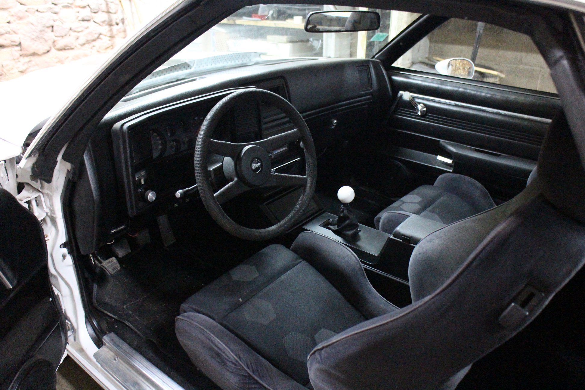

When you have time, please post more photos of the upgrades. Tell us in particular the details of the interior upgrades. Very nice work! Especially given how much it costs to ship parts over to France!
