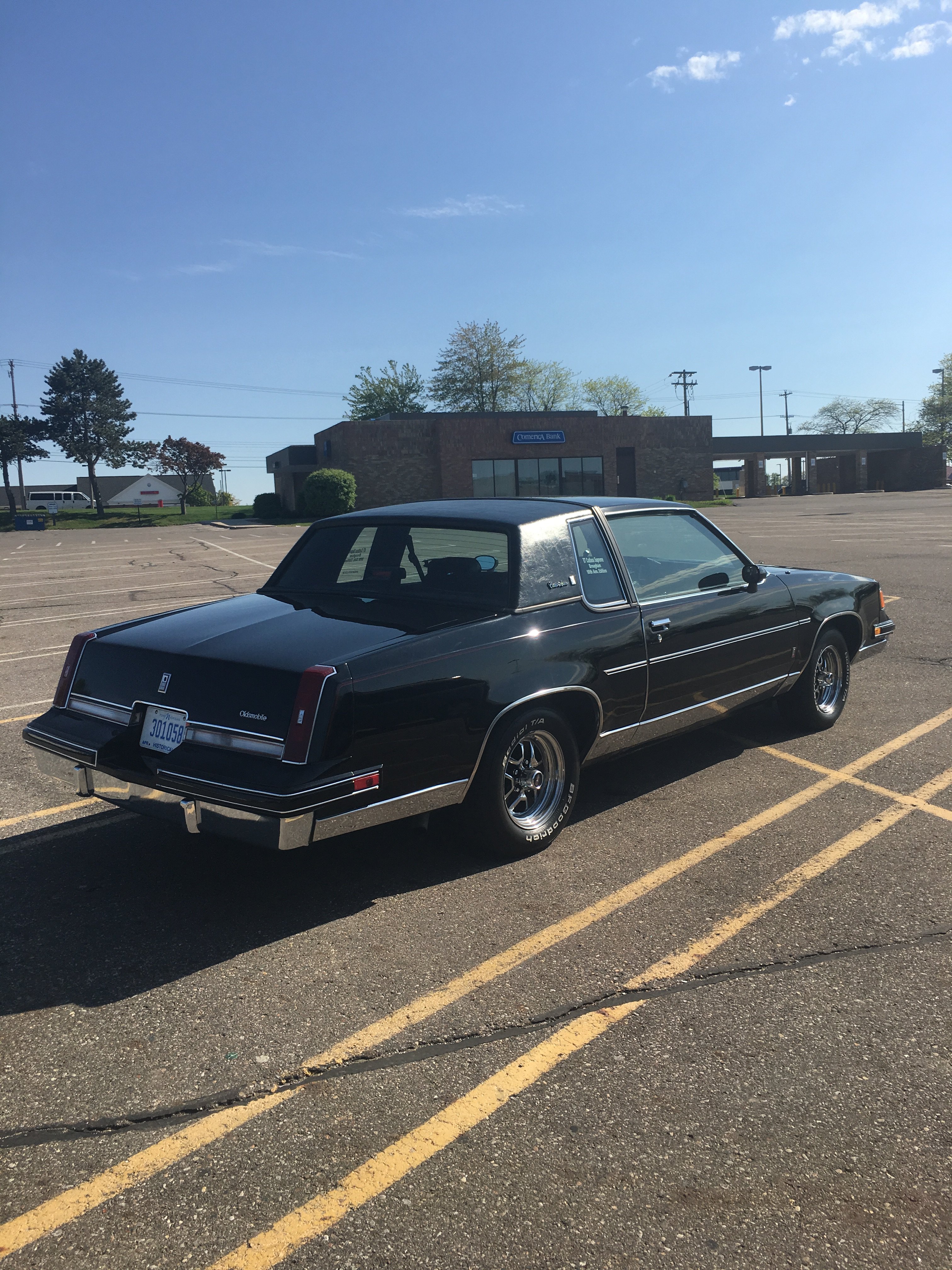

I'm new and want to LS swap my 87 Cutlass
Welcome to the site from Houston. That's a pretty Cutlass. Check out some threads in this section. This is a good place to start looking for ideas...
