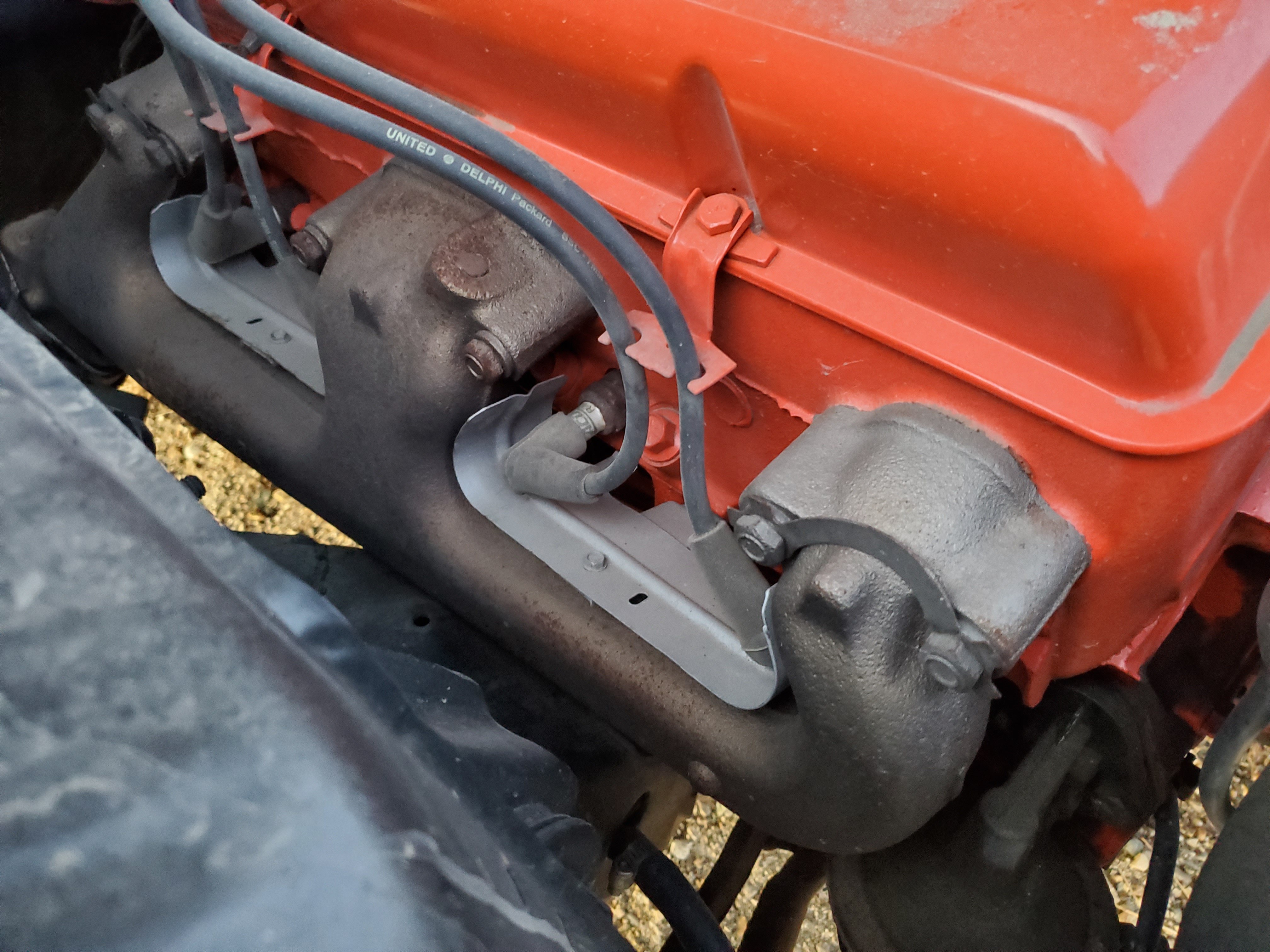

I've had pretty good luck with the VHT Flameproof header paint. I think there are also varying degrees of ceramic coating, and the stuff the header manufacturers use is on the bottom end of the spectrum. I've seen stuff that people have coated on their own that looks 1000x better than a precoated set of headers from a retailer.
X2 on VHT. I use the "cast iron" finish on manifolds and it holds up pretty well. Turns a bit goldish as it ages. Eventually the rust will win though. I preheat the manifolds on a radiator style heater and give many light coats.
And after 3+ years of driving and sitting outside in all weather conditions. Would fair better used on an occasionally driven and always garaged vehicle.
I used VHT on the heat shields too.
I apologize if this clutters your thread. I'll remove/edit if you want. Just wanted to show the aging process.
And after 3+ years of driving and sitting outside in all weather conditions. Would fair better used on an occasionally driven and always garaged vehicle. View attachment 127151
Not cluttering the thread at all, appreciated actually! I'll probably be referencing it later! The pictures just make it easier to find 😆
