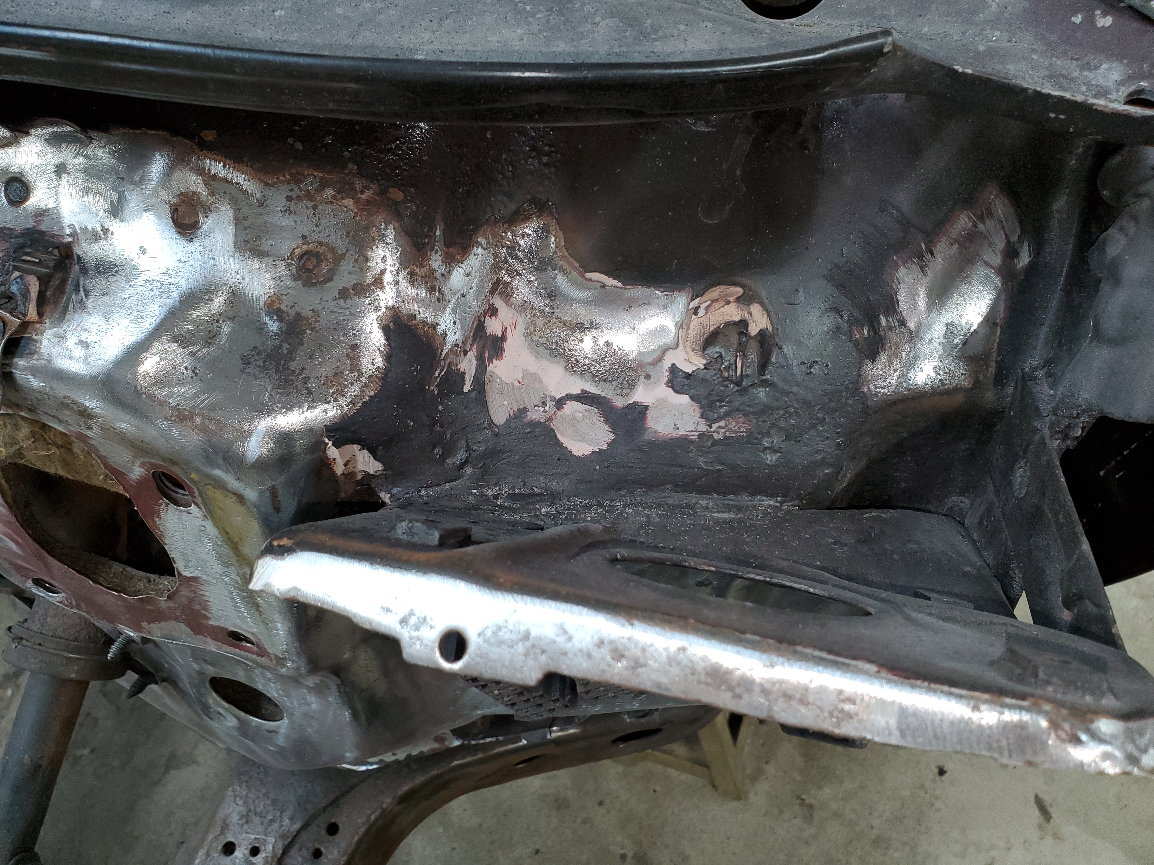

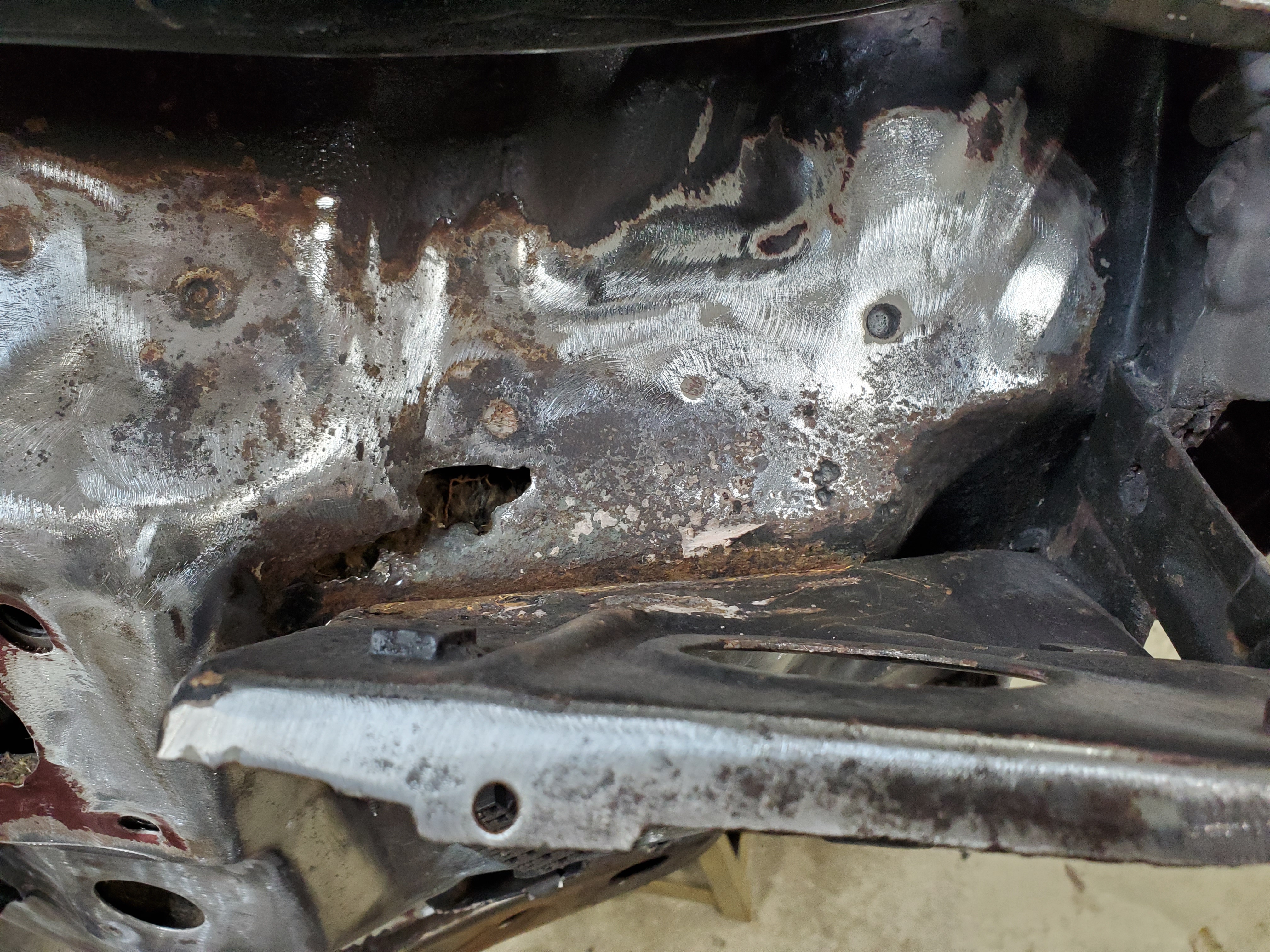

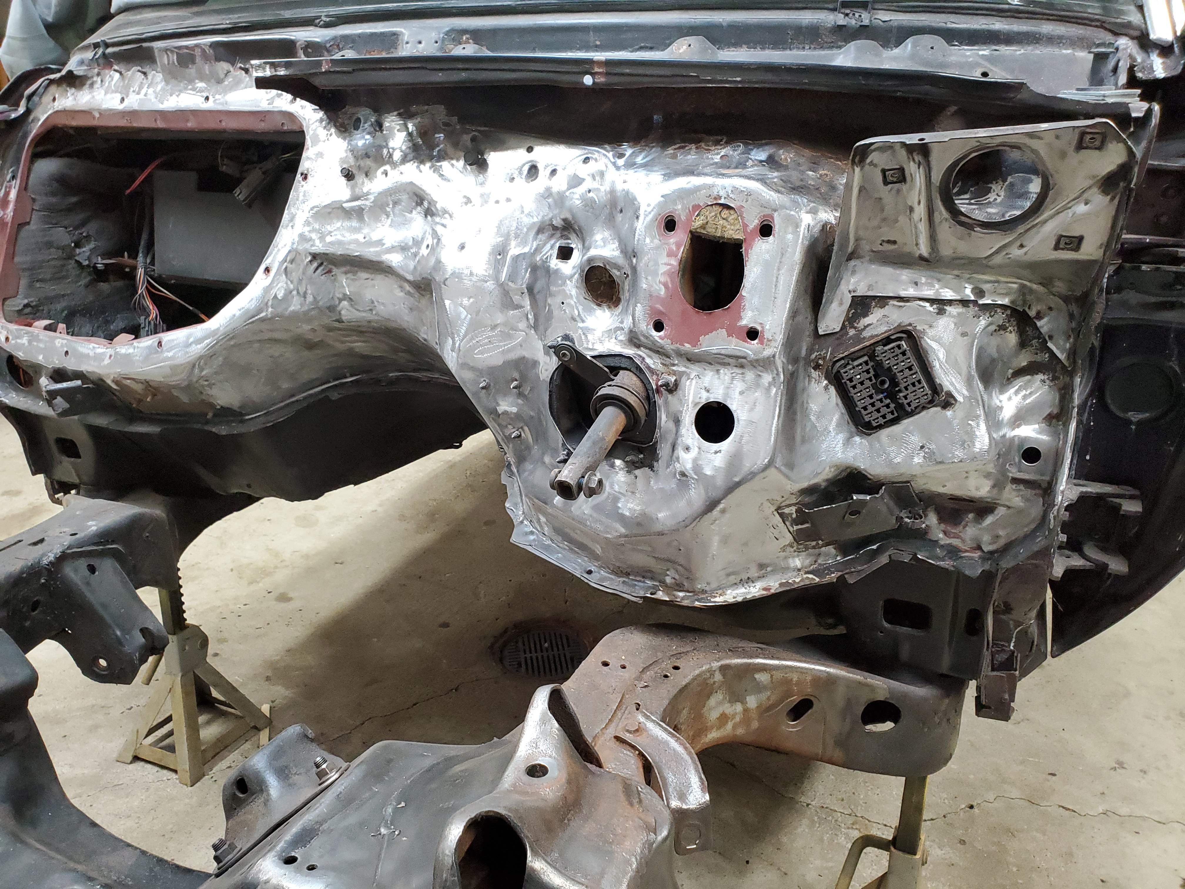

Got a little more done today, I would've liked to have done more but there just isn't enough time in a day. First I had to get my propane bottle refilled so I wasn't working in the cold. After that I got back and heated up the garage. Then I picked up with the die grinder where I left off. I mostly worked on the drivers side, and definitely found some ugliness.
That doesn't look like factory seam sealer-
Ah, I was right! Don't think that was factory-

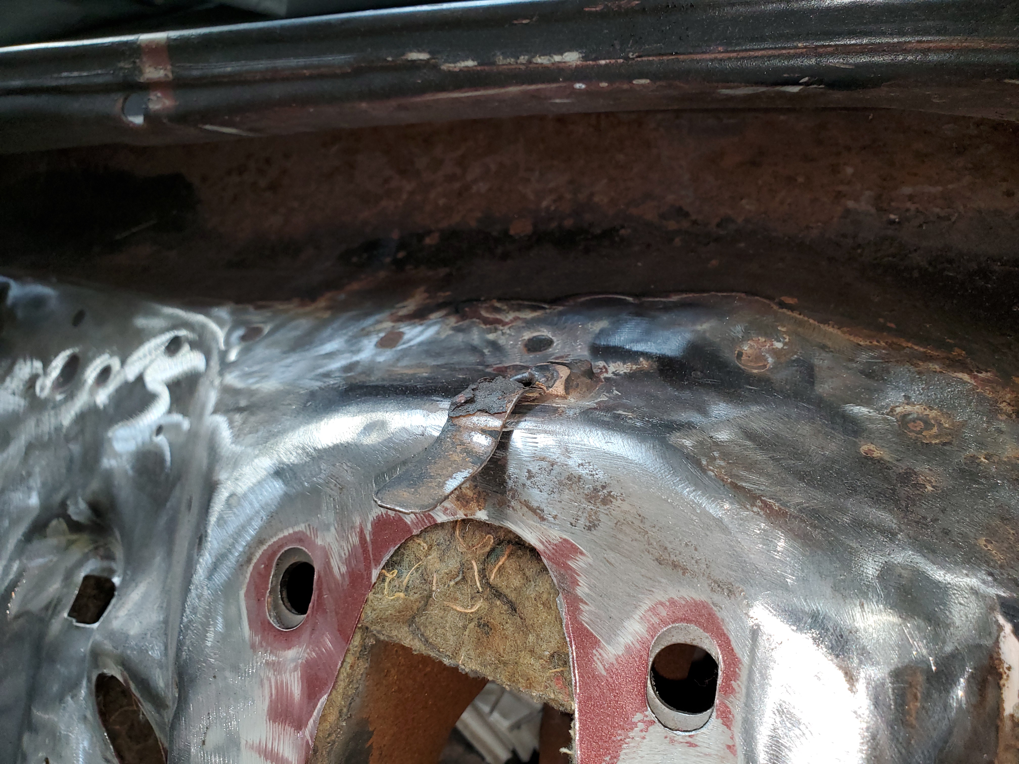

I've owned this car for almost 8 years and I'm still finding surprises. Fawk! I don't think I've ever seen another one rusted in this spot. Not sure how I'm gonna handle this. The correct way is probably to drill out the spot welds for the wiper motor brackets then cut out the rust and weld in a piece cut from another car. That would mean drilling and welding into my paint. Grr....
It would be in the door jamb where it would be unlikely to ever be seen once the fender is on, but it still sucks. I'm open to suggestions on it.

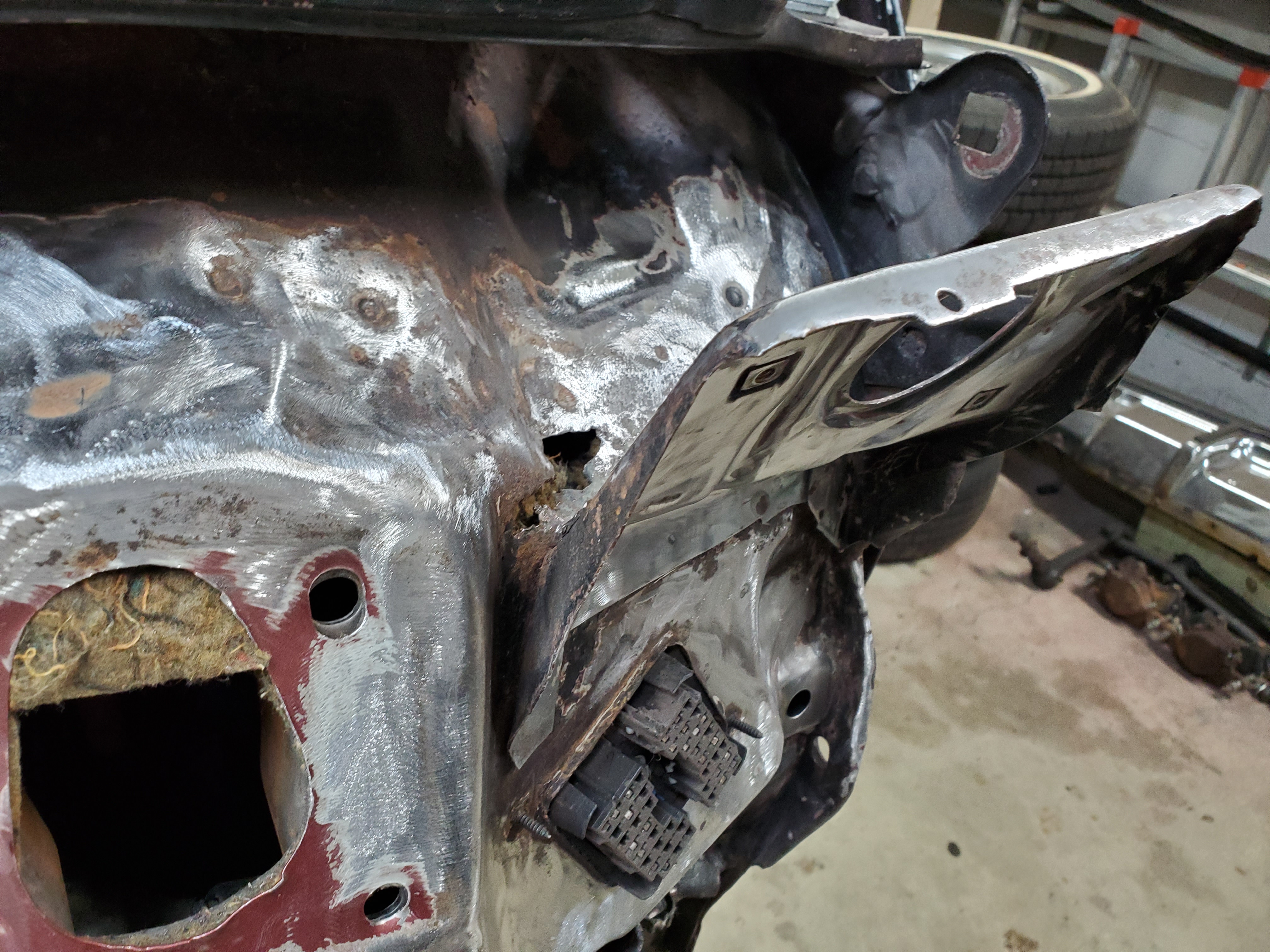

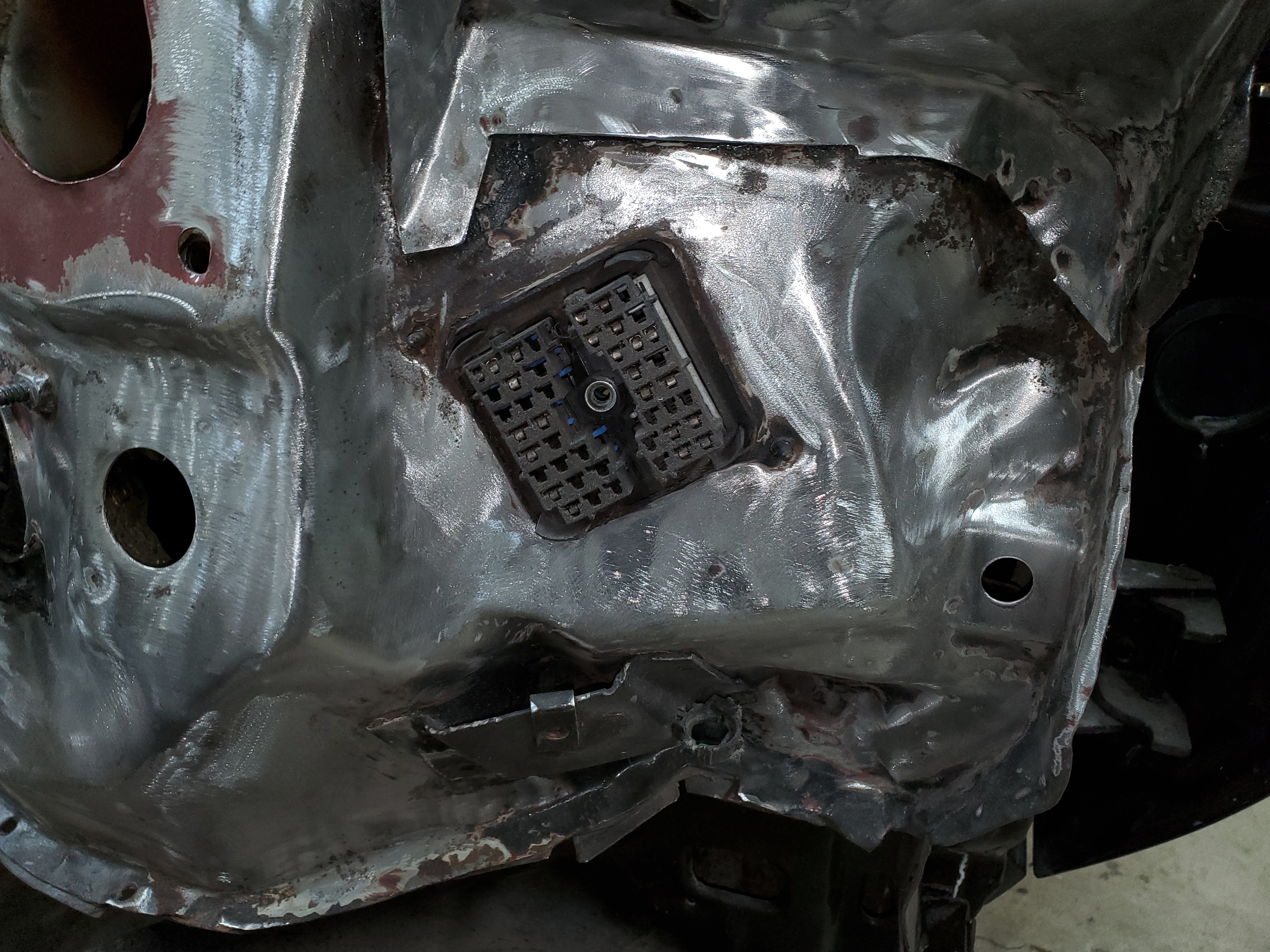

Here's some other pictures from today-
Got rid of that tab above the brake booster. Still not sure how to get all that shitt under the cowl without the cowl coming off.
