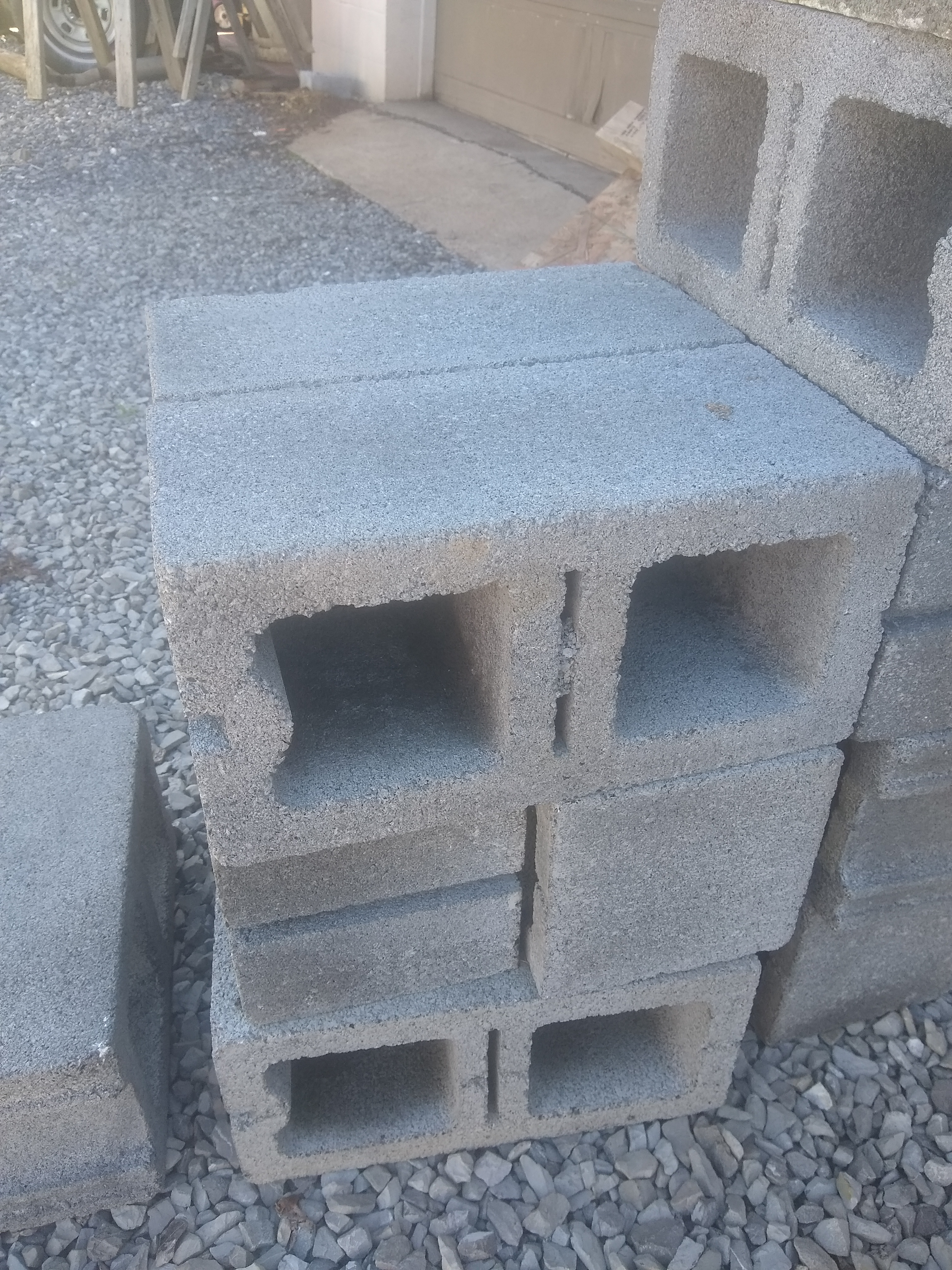

Are concrete blocks still the best thing to set the car up on? I'm thinking this setup but taller.
I used blocks under my elco body. I had to go high because the space I was working made me take the frame out in a 45 degree angle.
I stacked mine like this...
Takes more blocks and more space, but I liked how stable it was to work around. Single blocks just felt wobbly to me.
With the amount of floorpan work your doing, I think you'll appreciate the extra stability.
That would definitely be more stable than single blocks. I may use single stacks judt to get the body high enough to get the frame out of the way, then before I go any higher I'll build up double stacks like you've shown.
Looking good. Glad to see you back on it. When you stack the blocks Id make the holes face the sky like a house has them. Thats where cinder blocks get their strength. I used a piece of plywood on top of my blocks to disperse the load. The weight of the car probably wont crush sideways blocks but I didnt wanna chance it. Keep up the awesome work.
