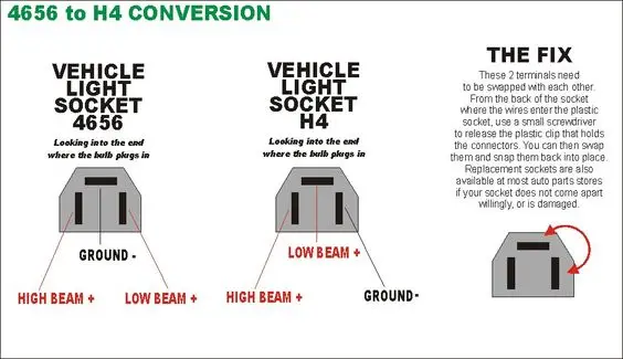

The website link was confusing. It seems that they just make one type of bulb. Just buy a second set of the same. Use the instructions in the video to repin them to configure your lighting the way you want. You could have four low beams for...style. With a bit of extra wiring. The three-pin plugs are available as repair pigtails. Not sure how much current these draw at full on.
Reactions: Icantfindmyrice
Alright thank you
I had to re-pin my 80 Monte Carlo. See if this helps you out.
you are using H4656 and H4651 from the factory and the H4 is what most manufactors use as a wiring guide.
If all your leds have 3 prong just bend the top balde out of the way for the H4651 / 2 pin light or cut it off if your OCD like me.
Thank you so much this is what i ended up doing and it worked

Repinning of the factor plug is required.
