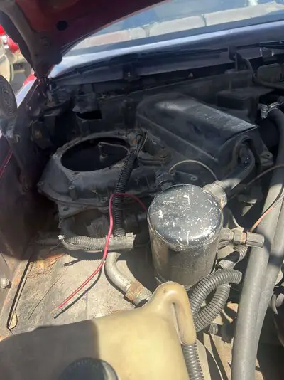

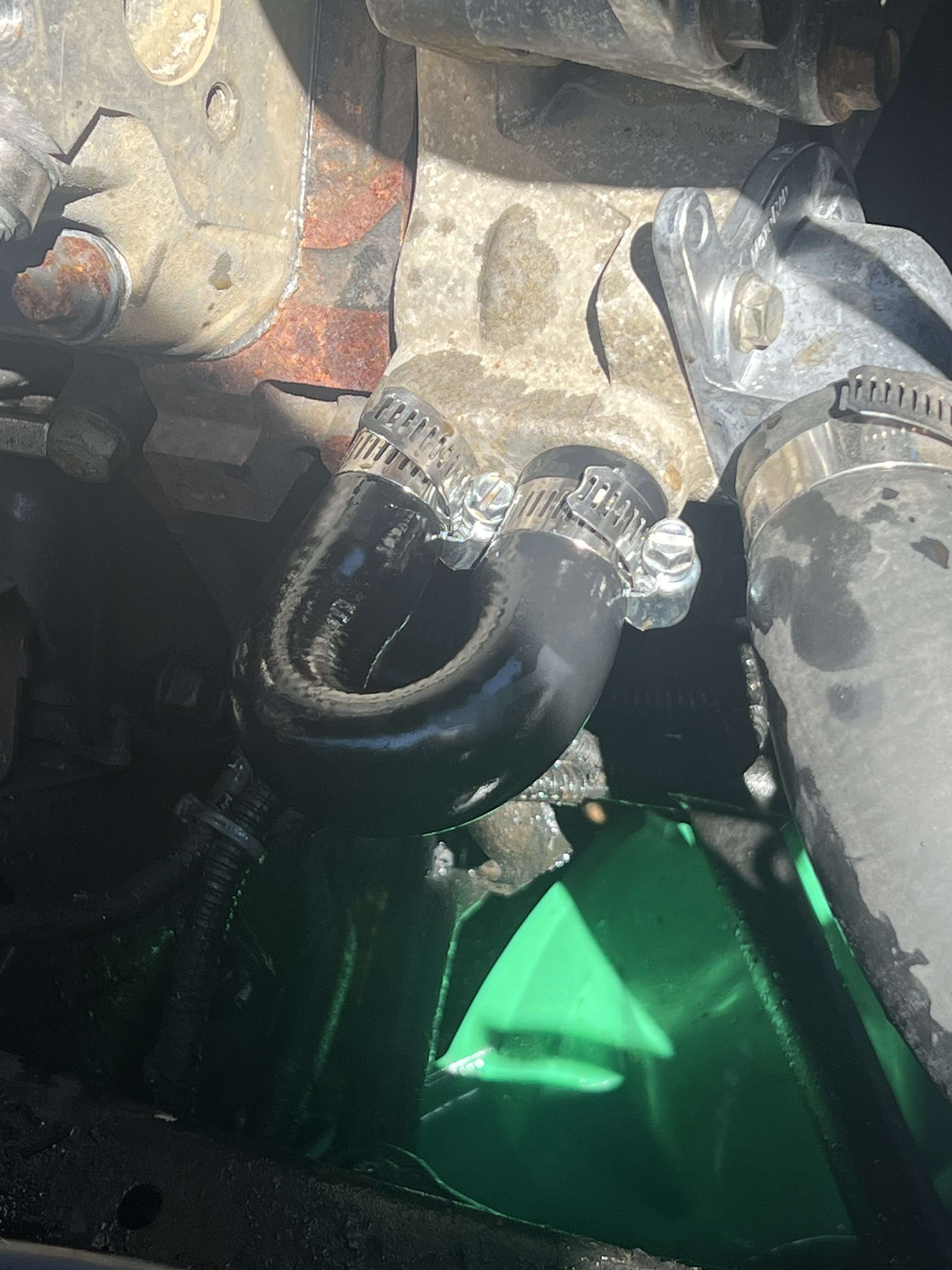

It’s been a long time since I posted I since sold the 6.0 turbo to my brother and I am keeping the 4.8 to turbo I am in the middle of removing the heater box and ac stuff does anybody off hand know the dimensions so I can have a block off plate made I also did a heater core bypass

I don’t have the dimensions maybe someone on here does but once you remove the the heater box you could measure the opening and go from there.

There's a bunch of people that sell the plate. Probably cheaper to buy than the time to make.
To make your own, get a piece of cardboard and lay it on the open hole flat, poke the holes through with the proper overlap. There's your template.

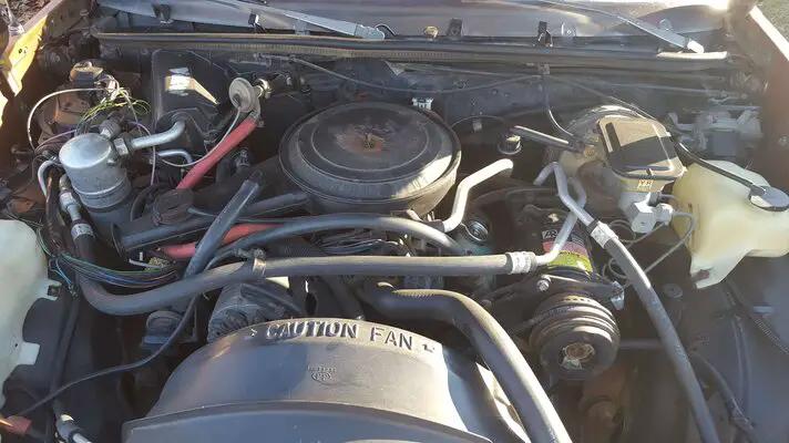

My car had AC and that's the plate I used. As you can see in the pics. Sorry the engine in partially blocking the plate
