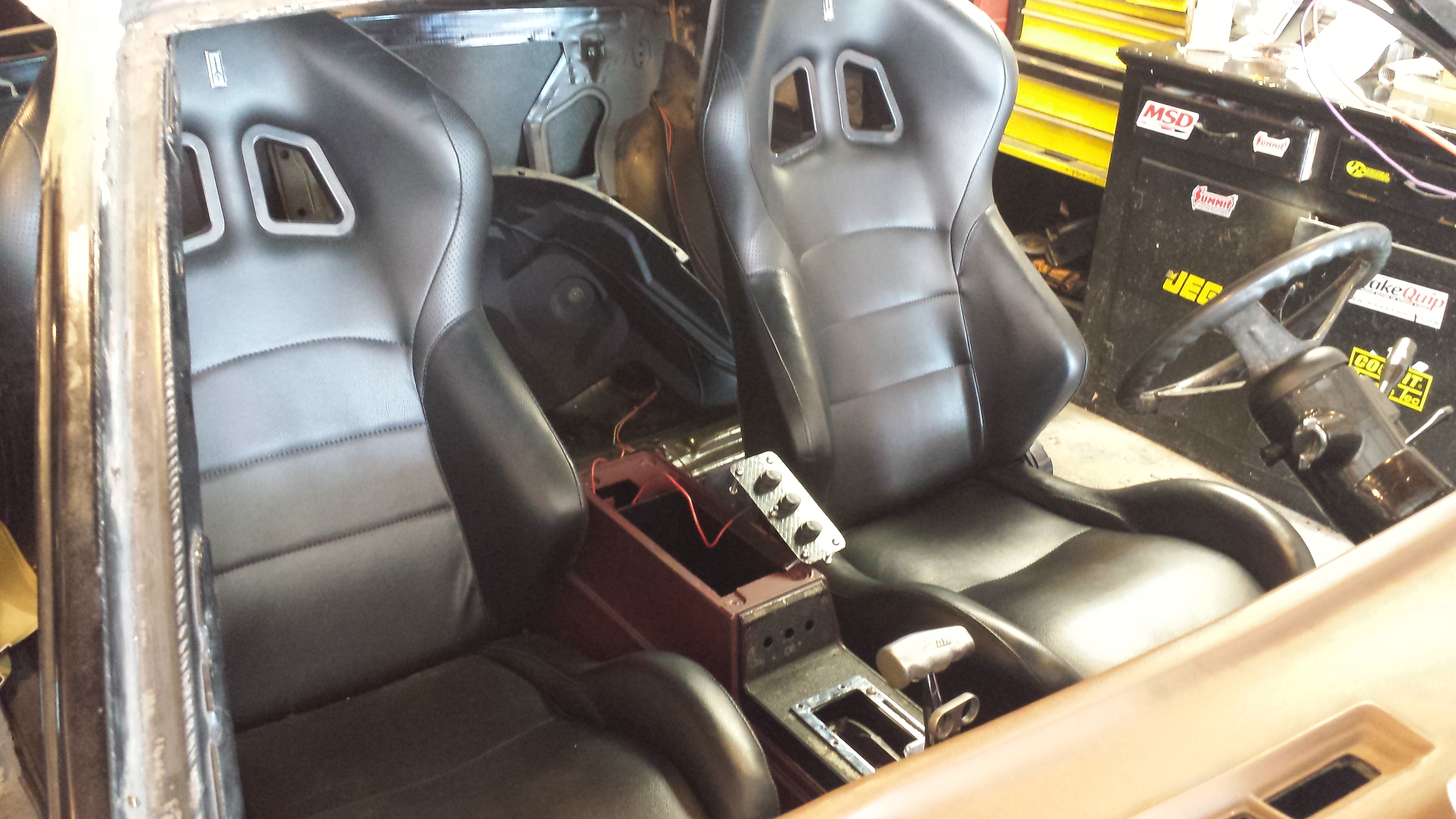

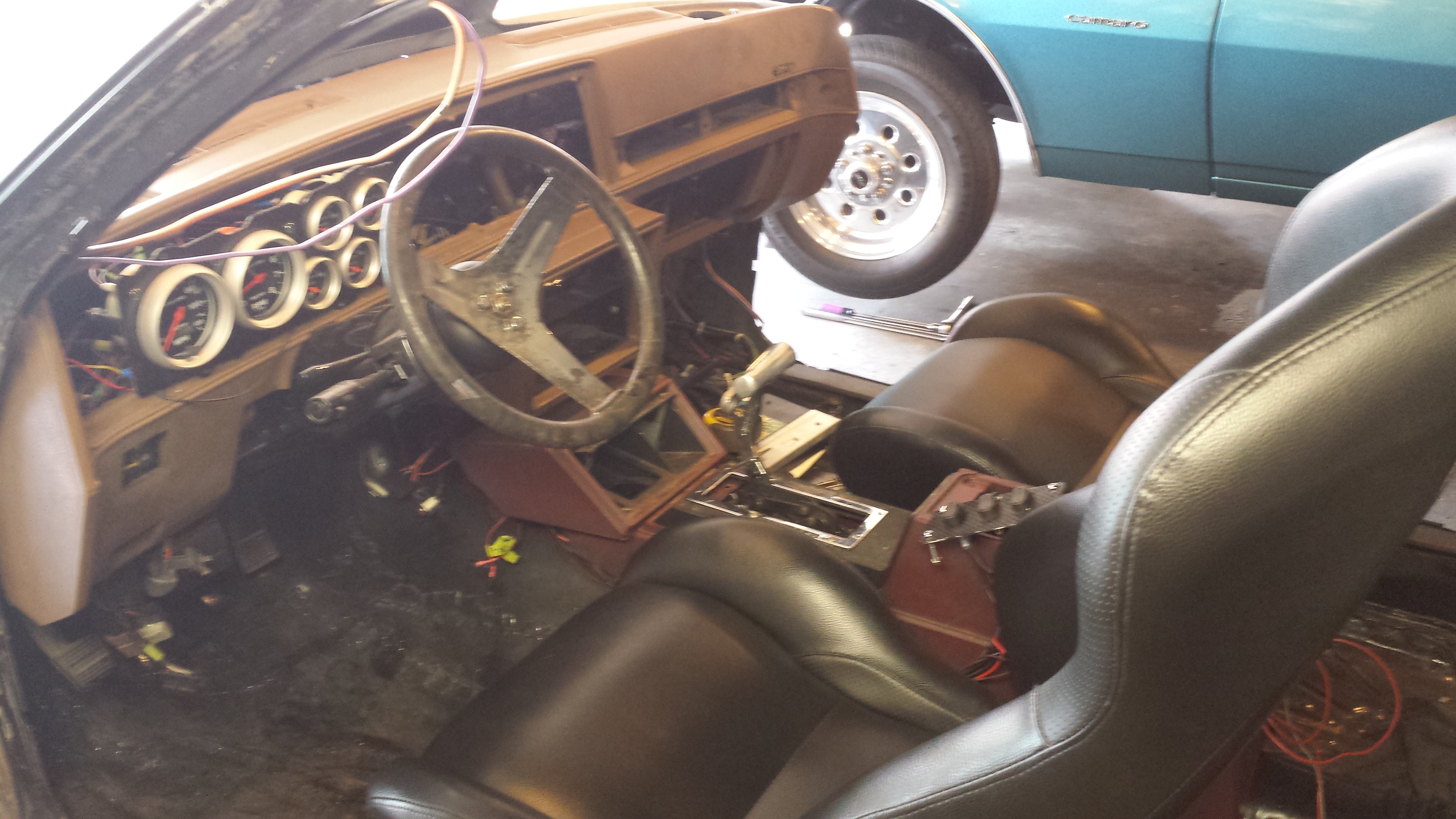

On the shifter, maybe add spacers under the back of it. I found a mint monte console for $13 at the local scrapyard so i cut the brackets and riveted them onto the hump in factory location in my cutlass. Added about 1" spacers and my hurst now clears. Good lookin monte by the way!

On the shifter, maybe add spacers under the back of it. I found a mint monte console for $13 at the local scrapyard so i cut the brackets and riveted them onto the hump in factory location in my cutlass. Added about 1" spacers and my hurst now clears. Good lookin monte by the way!View attachment 44227View attachment 44228
Yea I'm still debating raising the shifter if i cant find a solid deal on a regal console. I just don't want anything in the way of the shifter especially when I plan on drag racing the car.

I hear that man! After putting the spacers in and dropping the console back down i hammered thru the gears to triple check it. However, maybe a little different that you have the pistol grip. Keep us all posted!
