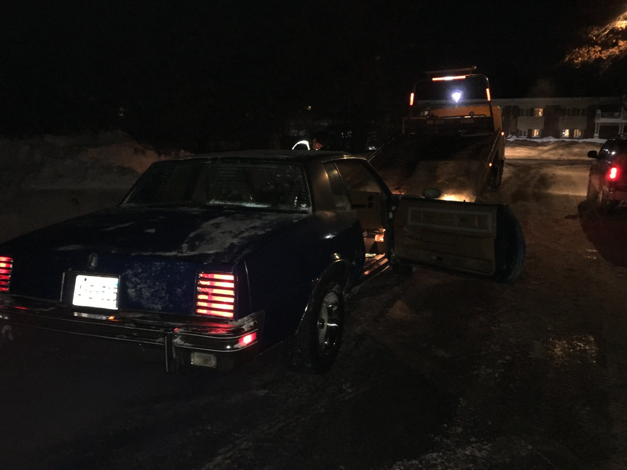

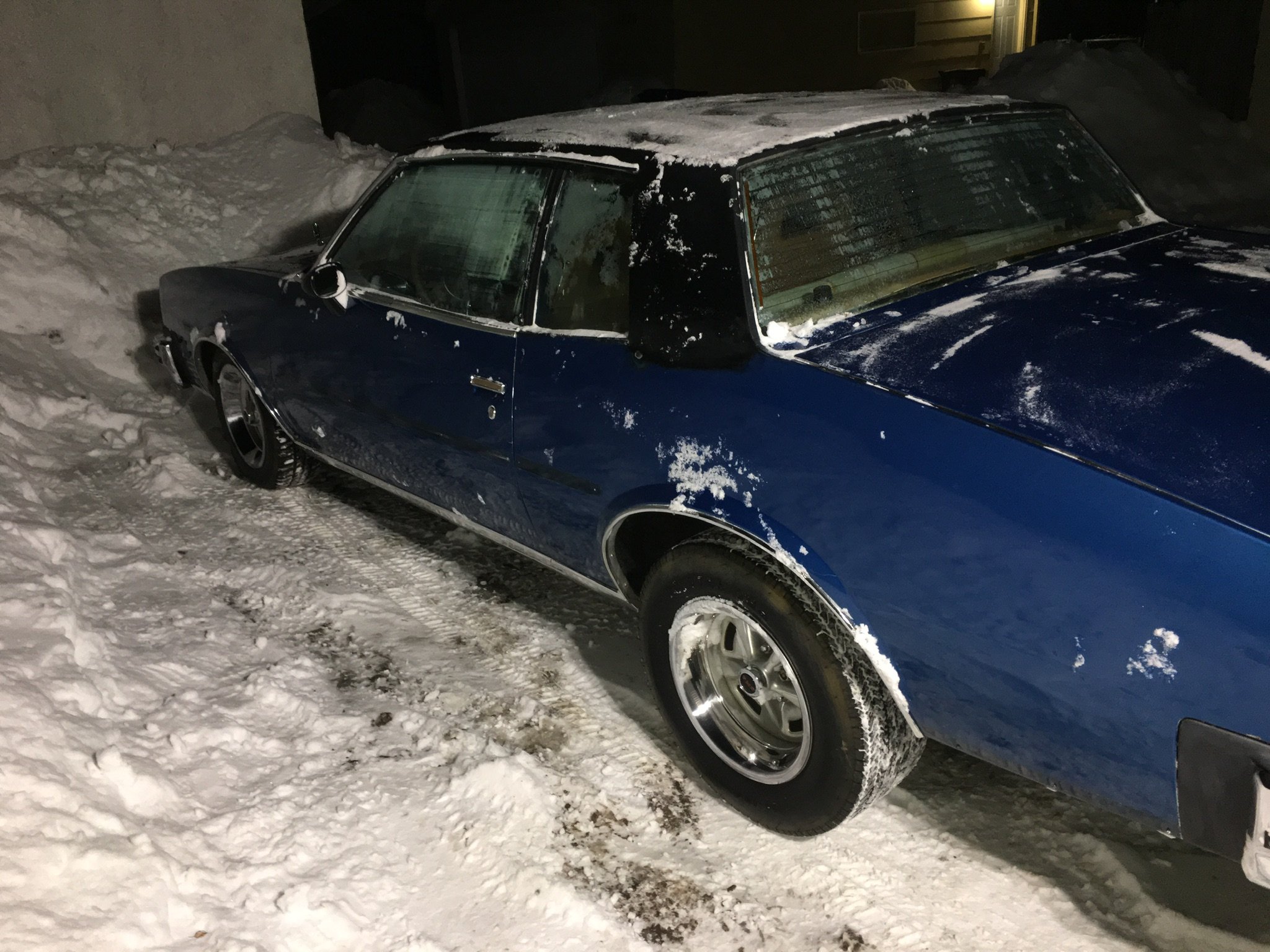

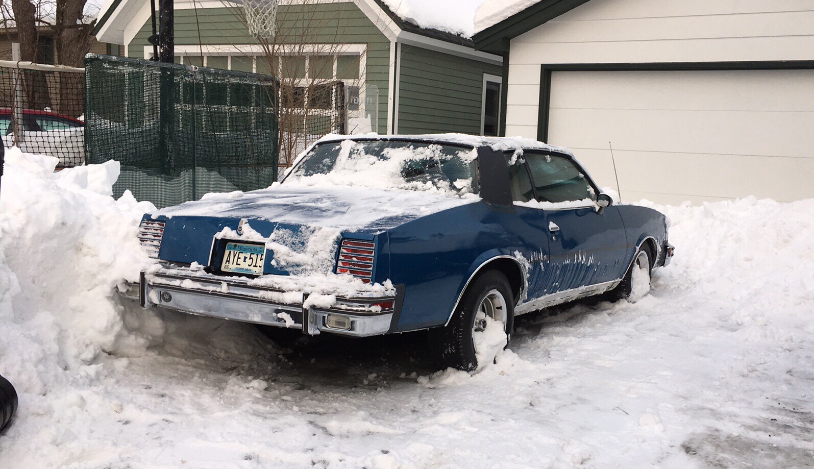

These first pics are from the day I picked the car up in a snow bank I had to shovel myself before the flatbed driver showed up. The car sat all winter and fired right up.View attachment 114389View attachment 114390View attachment 114391View attachment 114392View attachment 114393View attachment 114394
Car looks much better uncovered with snow. Welcome aboard and good luck with your build!
