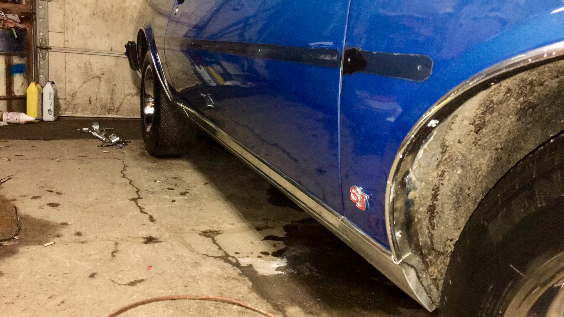

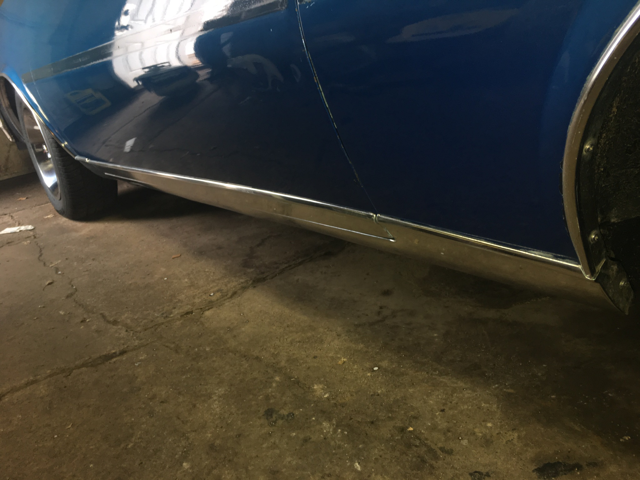

Thanks, the car looks a lot better in the tiny photo than it is; someone put a gallon or two of Bondo in the car and it's starting to fall out.
I actually have two complete interiors so I don't need them, and I don't know anyone else with a GP.
Nope, no bondo in that car. Someone put a real shitty garage paint job on it. Been over that entire car with a magnet and nothing. If you look at some of the pics I’ve posted of trunk. You’ll see how clean that car is.😉
