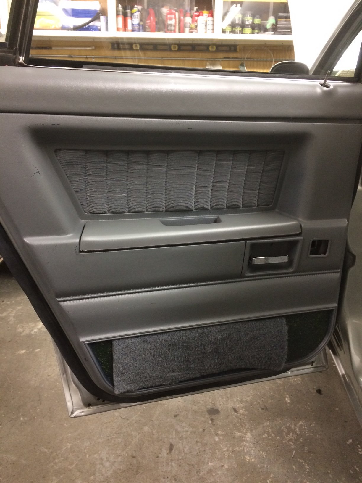

Just so I'm kinda clear on this, the photos of your interior parts are the SEM Presidio Grey? I like that it's light but not too light and can be combined with a bunch of material colors for seat reupholster.

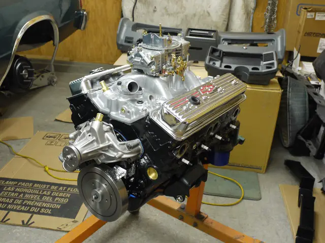

Made a little progress. Most of the serpentine stuff is now on the motor. I still have a few more details to take care of like the fuel line at the pump and I need to order a bolt from GM because I didnt want to use a stud in a through hole. LOL

I finally have the rear interior panels back in the car AGAIN. I dont think theyre coming back out. (I hope) It took a little while to figure out a solution to the rear glass fiasco. Turns out it was a fairly easy fix after I saw how another car looked without the glass installed. Jim and Jack, I'll fill you in.
