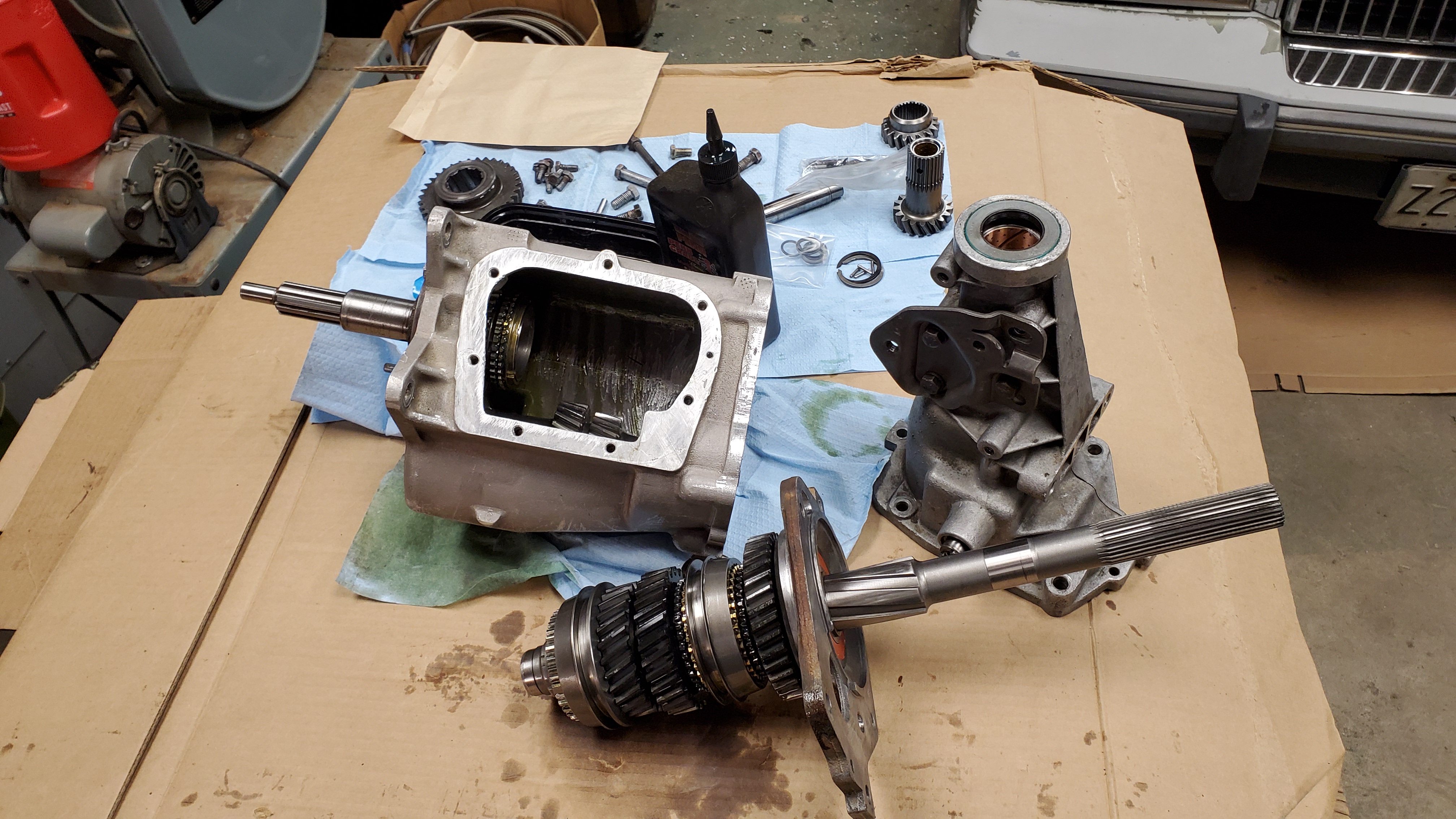

This is about it until I get the input to output shaft bearing cage. Then, it can all go back together. I dressed and faced the other reverse gear- can't find'em, grind'em!!!!
OUCH!! The iron mid-plate was one of the pieces that I threw into my own Muncie build because the countershaft had gone for a walk on the previous owner and he decided to go auto-stick. Surprised that the Auto Gear piece did not have the hole for the 3/8ths bolt drilled in it. Possible that the sleeve did not seat due to a burr on the shaft or on the sleeve itself. Dremel tool is your friend. Think most of what is now in my own 4-speed came from either Auto-Gear or from Texas. Like I commented some time back I did go with the higher tooth count 1st gear and matching counter cluster c/w 1" shaft. Oh, and a Hurst Comp-plus. Did look at that supercase for Muncies that was being offered. Nice and beefy in all the right places, particularly the ears. $$$$$$.

View attachment 137752View attachment 137755

Thanks! T-10 or M20? It's a toss up, isn't it? Do either have new gears in them? After eating all the teeth off 1st in the burnout box, I went with new. I have a low mileage M22 set, I'd make a deal on. I only took it out to get a steeper 1st. Doesn't the T-10 have a 2.88 1st?

4 speeds are all an exercise in compromise. 4th is usually 1:1, so you pick your rear gear for your desired highway speed. I ordered a 9" with 3.70s, then decided I had to have straight cut gears (for noise mainly). I bought an M22 gearset, but didn't realize how bad the 2.20 1st would be out of the hole. I switched it out to the 22W gears with a 2.52 1st to get closer to the 10:1 launch ratio rule of thumb.
