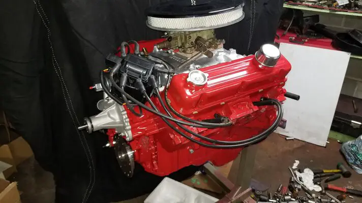

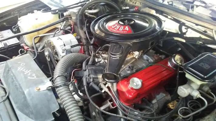

Therefore, not so easy. The easiest would be a 350 Buick; the problem is finding one. That being said, us Olds guys like to see 403s and 350s in Cutlii. Then, you can bolt up to the trans, but you need different engine mounts.The easiest, cheapest, most common swap would be a Chevy 350.
I believe you would also need to swap the transmission to match the Chevy bellhousing bolt patten.
1982= no CCC?. You could probably just stab a stock 8:1 350 Buick in there, get a CCC quadrajet off of a 305 or similar and it's computer use the 231 distributor with a V8 cap
Didn't see his was an 82. Still, it could be done lol.1982= no CCC?
