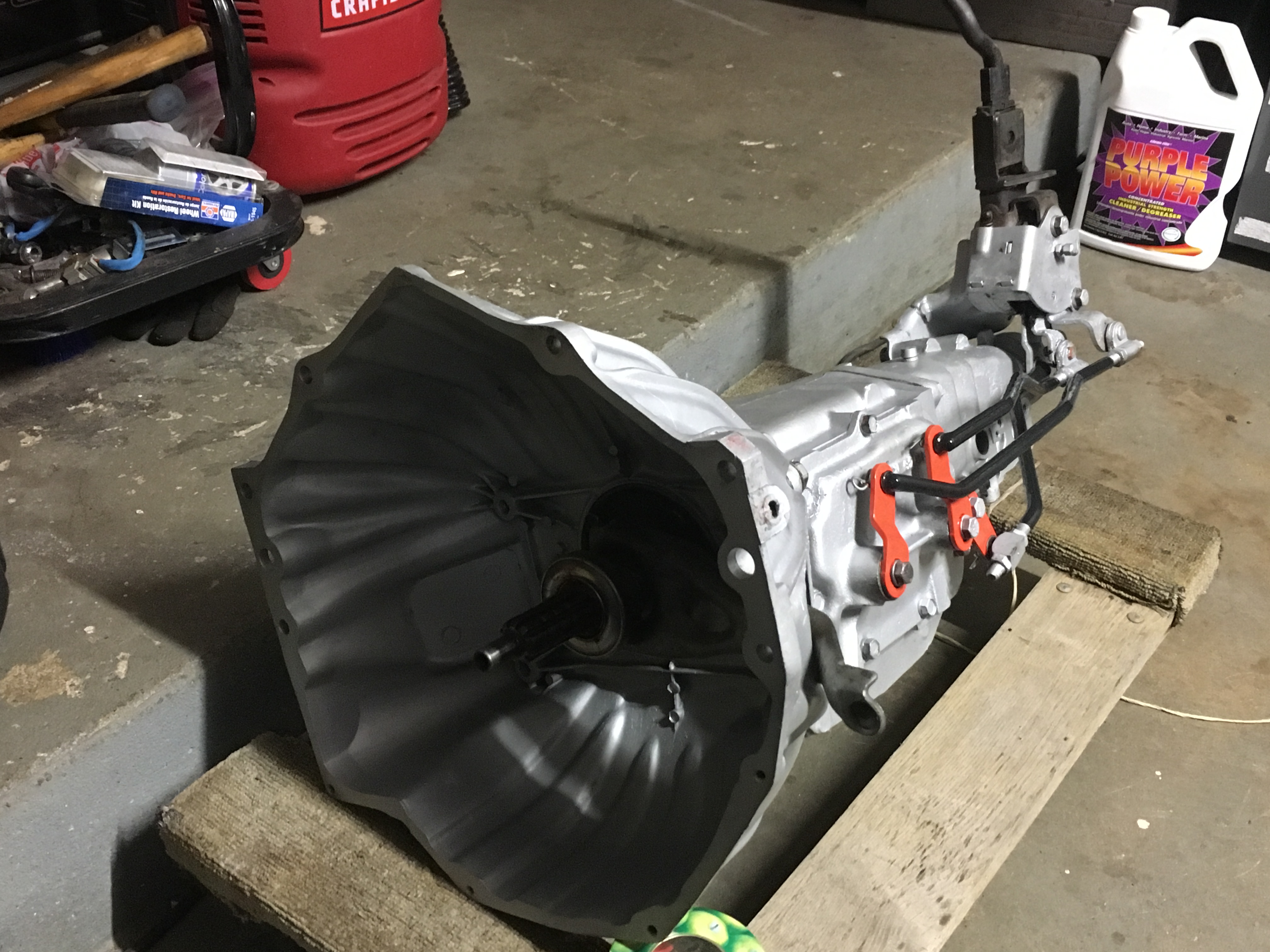

I don't see a g-body bell housing in your pictures
Reactions: ItsnotaGN
That doesn't look like it that clutch fork will hit the floor of the car like thisView attachment 71664 the g-body fork is curved on the end for clearance and the pivot is lower in the g-body bell housing
You have me thinking now... I'll be honest I wouldn't know being that it's not mounted yet, but I was told it was an early 70s gbody housing... in going to have to look into that

I have a new one in my garage I was going to take a picture of it for you but I have no idea where I put it. The fork you can buy repop the Bell is not so easy to come by that's why I went hydraulic with my olds plus it's bbo and the headers were all kinds of in the way

Early 70s is A-BODY like Chevelle they don't work
So in your personal opinion what do you think is my best bet here?
Well you already have everything except the proper bell and fork it's a Chevy so it's probably not too hard to find the right bell mine is olds so it was like he's teath. Also a g-body bell will only except the smaller clutch and flywheel if I'm not mistaking I read something about a after market scatter shield being available for a Chevy powered G-BODY eBay maybe? It was a few years ago I went threw this
