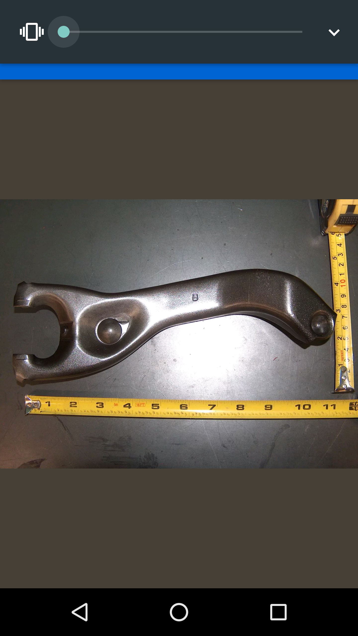

I'm not saying buy this just look at the fork and the position of the pivot
Welcome & nice Malibu. There is a housing for the 11" clutch, was used on ElCamino's & Caballero's (station wagons?) with 350/4 speed in '78. The p/n is 464697. Think the BOP is easier to find that this one.

What a bummer, but good to know... thanks Clutch, I'm gonna have to figure things out now...
I hear you I just didn't want you to bolt it in and find out the hard way

Thanks for the input pagrunt...
Being that I have already purchased a 10.5 clutch and flywheel,

thank you sir, and yes I have found my new home lol... in one day alone I found out about a very important hiccup in my project. I am currently bidding on a new housing as we speak so hopefully we should be back on track if all goes well
