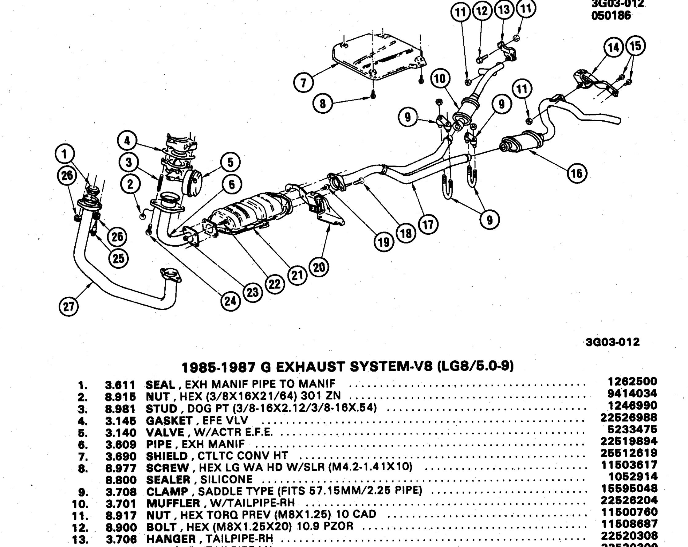

99% sure if it's an exhaust leak, it's in 1 (or more) of 3 places. 1- donut gasket where the cross over pipe bolts to the passenger side exhaust manifold, 2- flat exhaust gasket on TOP of the EFE valve on the driver side (bottom of exhaust manifold). And 3- the exhaust manifold to head- they did not come with gaskets from the factory and if there's any warpage, it'll leak there. An exhaust gasket would need to be purchased and installed if that is the case which may alleviate that issue.
Donut is part #1 in the diagram below.
EFE gasket is part #4.
If the exhaust pipes are leaking due to holes, then you really need to get those replaced.
Even though this is a VIN 9 dual exhaust system, from the cat forward, it's got the same pipes. Don't be fooled by the moron who approved this drawing. The EFE valve components #2, 3,4,5, and 6 are on the driver side.

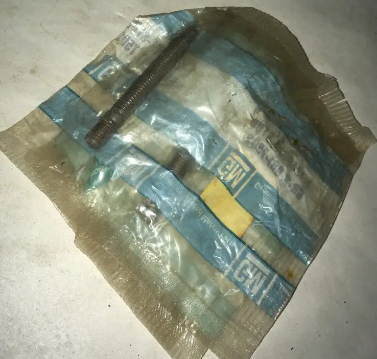

The exhaust pipe that connects to the bottom of the EFE valve does so without a gasket. It's a bell shaped bottom to the EFE valve. Just be careful with those studs and soak the living heck out of them with PB Blaster or equivalent. You bust them studs off and you'll be crying like a little beech. Nuts are 9/16" socket size. Nut p/n is 9414034. If you need to replace the studs, they're p/n 1246990. Pricey too, if you can find them. They have a small "divider" as it were where one part screws into the exhaust manifold about 1/2" and then bottoms out. Then you have about 2 1/2" of stud sticking out the bottom. I've heard of people using a 3" all thread 3/8"-16 size and gnarling up the threads about 1/2" from one end and screwing that end into the exhaust manifold. Anyway, if you want GM ones, they look like this.

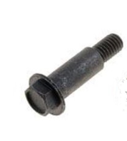

You know there are two springs on the donut gasket flange with special stand off bolts used for that, right? It appears you don't have that on yours in your pic. Just noticed that. Not a huge deal, but things outside of factory stock makes me wonder if someone hadn't worked on that car before. It basically allows for expansion and contraction by having spring pressure keep it in place rather than grinking down on the bolts. May be why it cracked the donut. Maybe. Anyway...
In case you wanted to get back factory stock with the donut gasket mounting:
You need (2) springs, p/n 587575
as well as (2) bolts, p/n 411405
PM me. I may have a couple of these spring bolts and springs for a nominal fee, if you need them.

That exhaust diagram is totally whacked. I kept looking at it then just a few minutes ago, realized that something wasn't quite right.
I still don't get where there's an exhaust donut on the cross over pipe. I distinctly recall the crossover has flanged ends. There should not be a donut on the crossover. If there is, something doesn't seem right.
There should be 3 bolts/springs on the down pipe to the cat converter. THREE. The donut should be on top of the down pipe to the converter.
