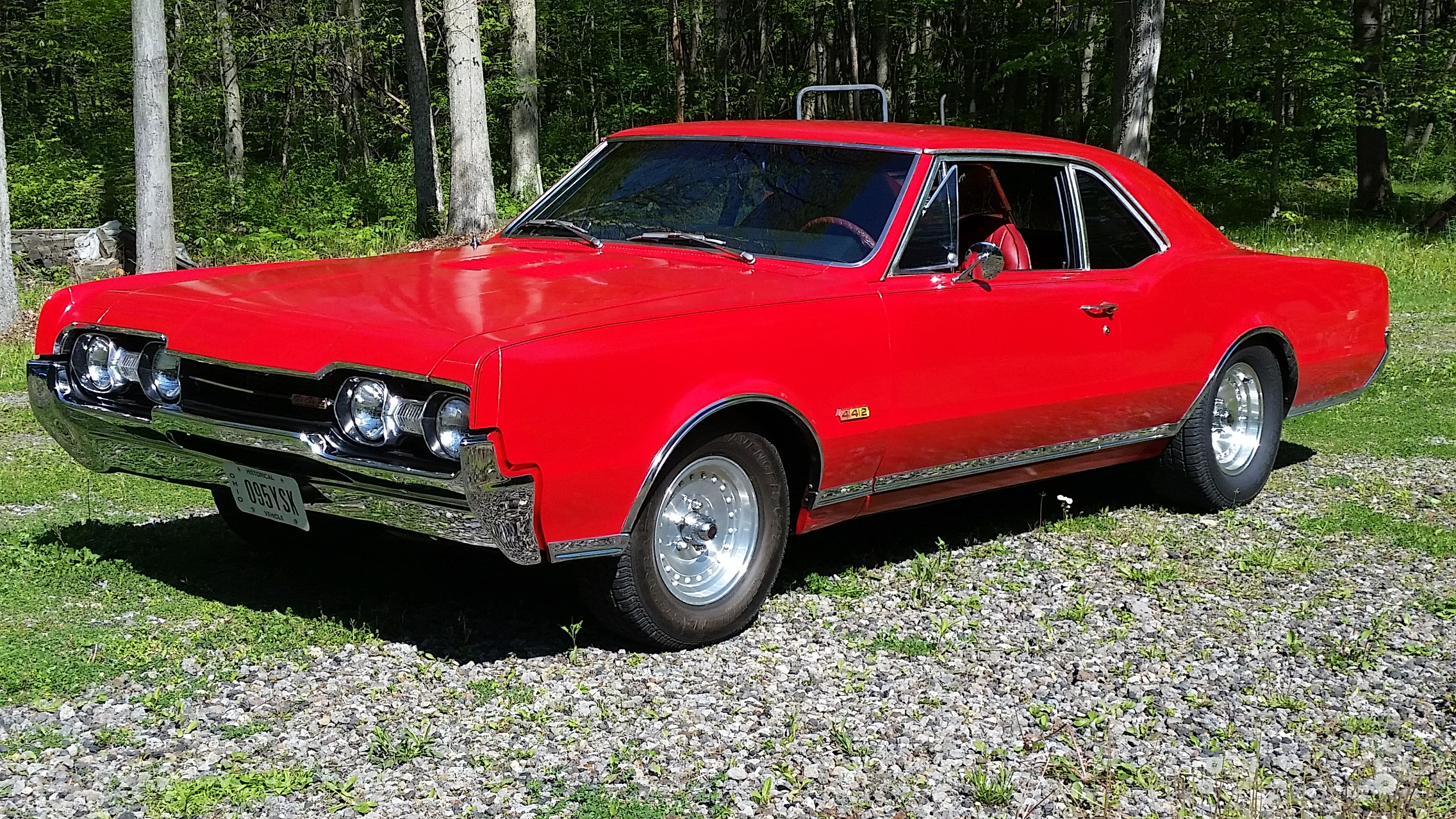

I'm still waiting. I'm at a standstill. The car is a factory 4-speed that was converted to automatic. I fixed the leaking turbo 400 yesterday, new pan gasket just so I can drive it. It's a J-headed 455 right now. Even finding a turbo 400 pan gasket only was a pain. O'Riley, Autozone, Advance Auto, none had either the gasket or new filter/gasket. Luckily the NAPA store had new filter with gasket. The Counter Guy is very knowledgeable. I told him I'd take it even though I only needed the gasket. He said, I'll sell you just the gasket and order a gasket to put back in with the filter. $5.33 out the door. Doesn't get any better than that. This is the car. 20170513_101722.jpg

I'm still waiting. I'm at a standstill. The car is a factory 4-speed that was converted to automatic. I fixed the leaking turbo 400 yesterday, new pan gasket just so I can drive it. It's a J-headed 455 right now. Even finding a turbo 400 pan gasket only was a pain. O'Riley, Autozone, Advance Auto, none had either the gasket or new filter/gasket. Luckily the NAPA store had new filter with gasket. The Counter Guy is very knowledgeable. I told him I'd take it even though I only needed the gasket. He said, I'll sell you just the gasket and order a gasket to put back in with the filter. $5.33 out the door. Doesn't get any better than that. This is the car. View attachment 111311
