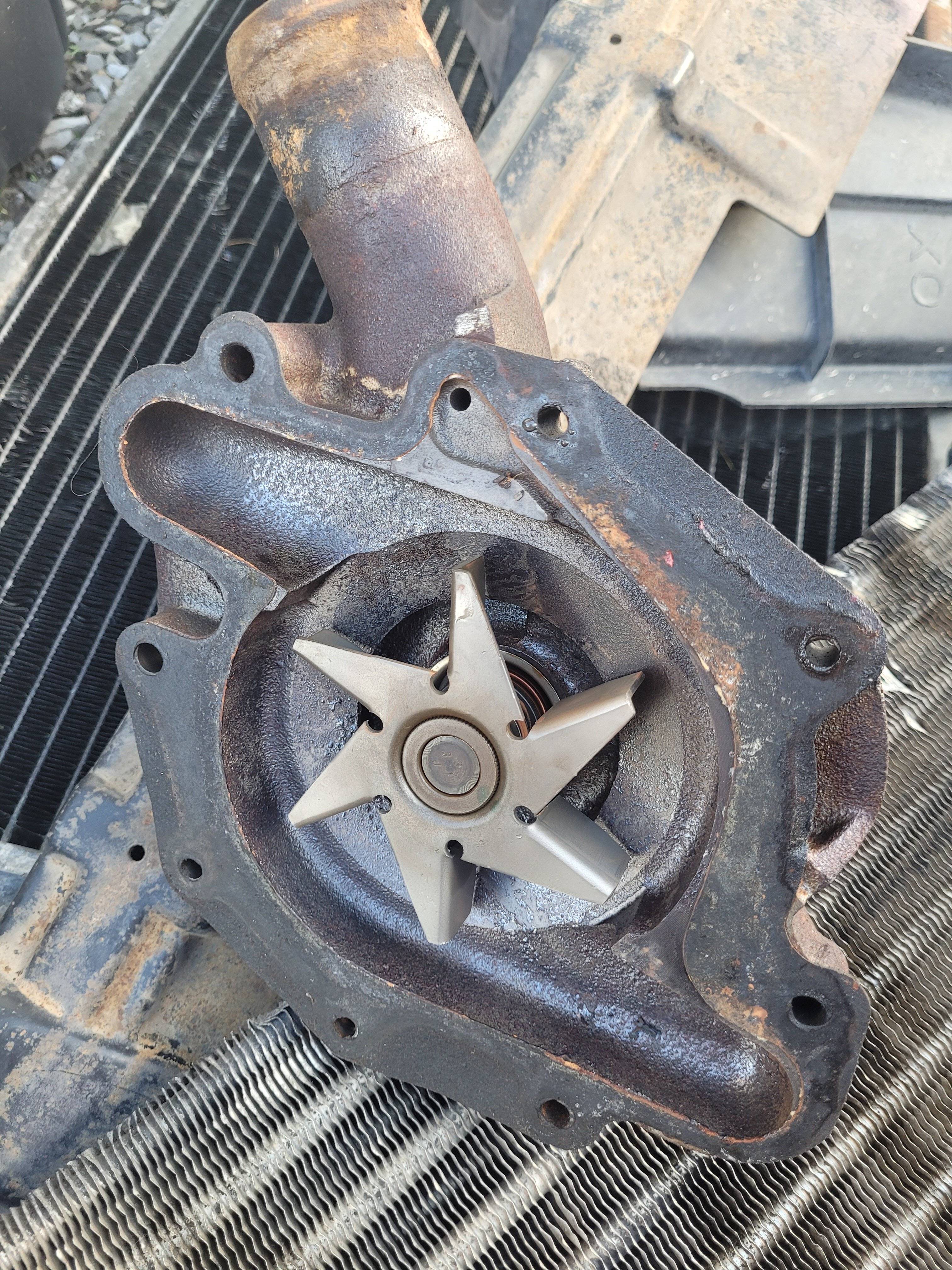

Here's a closeup of some of the old junk, including the fragged cam gear.
I might not pull the cam and just take my chances. I really doubt there's anything of concern and im not exactly married to the motor anyway. Will post updates once I slide the pan out, going to be quite a sight probably...

As you can see from the recent pic, virtually all of the nylon is gone and several teeth were missing as well. At this time it seems like the vast, vast majority is enjoying a soak in the oil pan.
