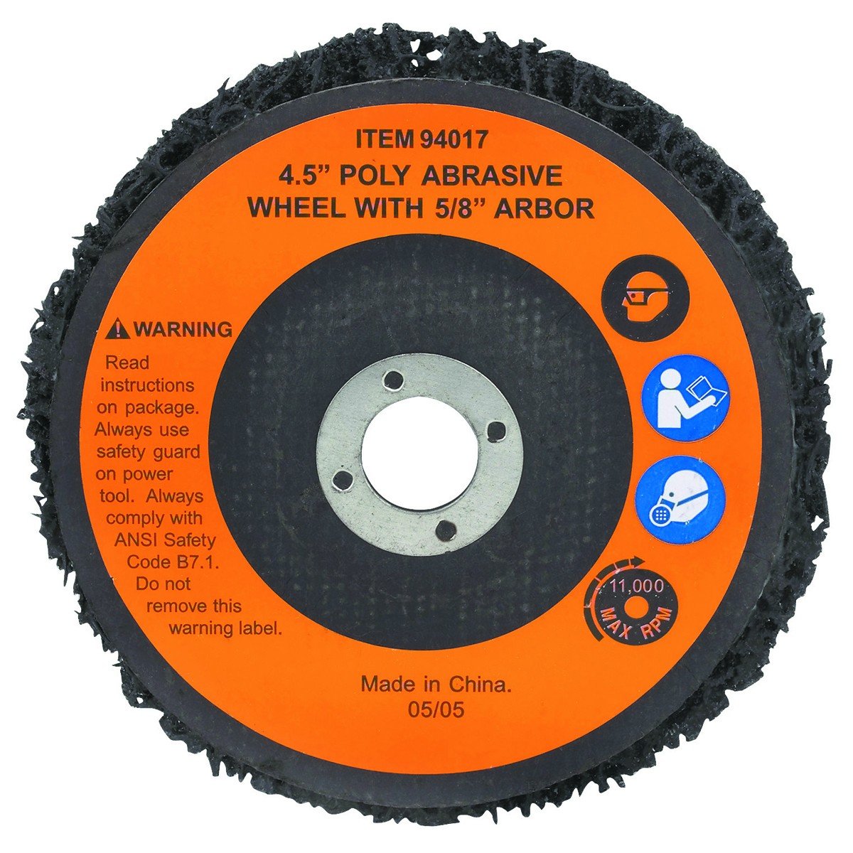

Put it on a grinder and Do! Work straight to bare metal!.is what I use at work

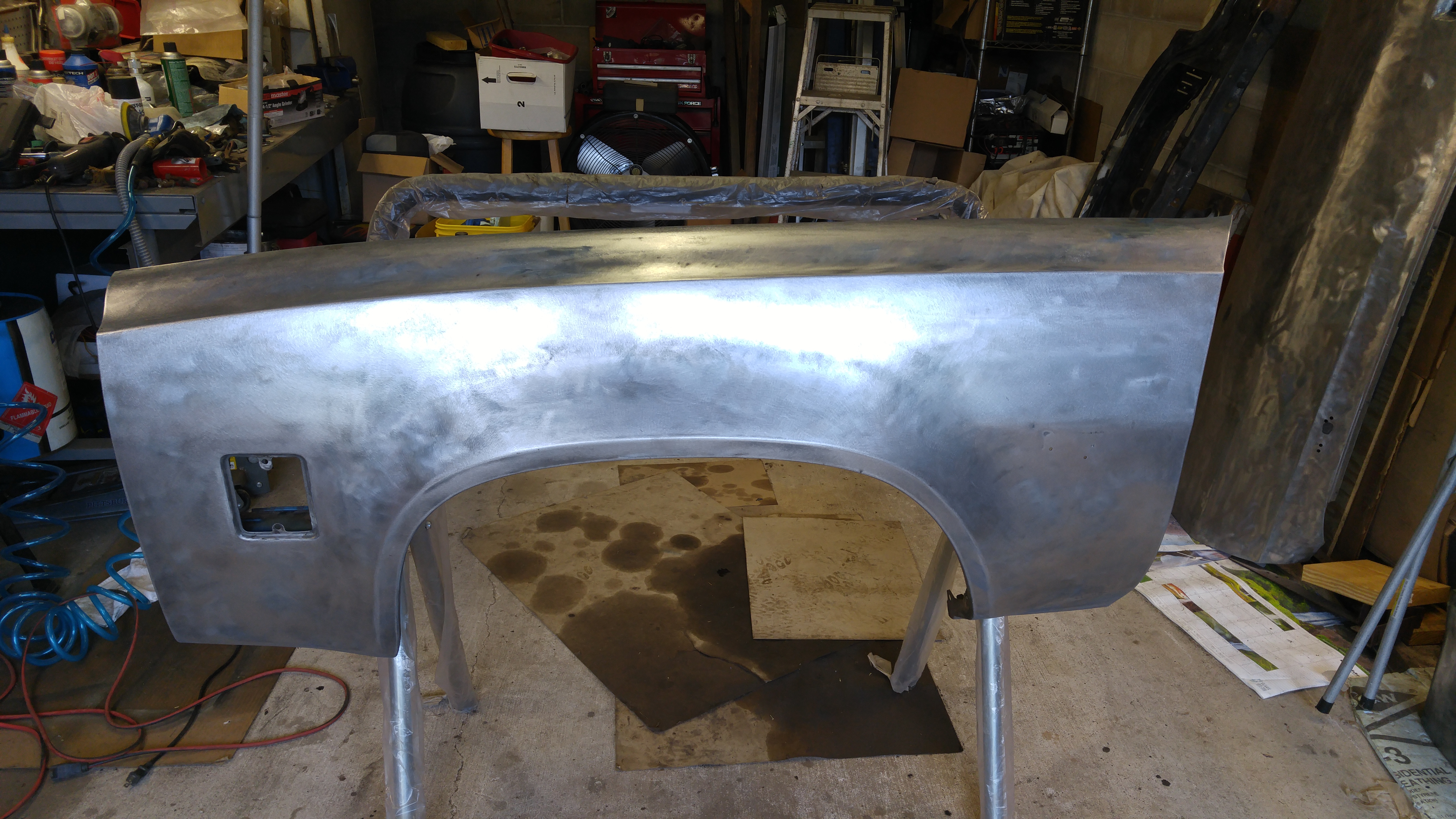

I second that! If you're on a tight budget this is the method to use. I used a $15 Harbor Freight 4.5" grinder and 3 of these abrasive wheels to strip 2 fenders, door and trunk lid on my 75 Laguna. It makes a mess but its a lot of bang for the buck. But if you can afford it, dustless blasting is the way to go to do a whole car.
View attachment 107652View attachment 107653View attachment 107654View attachment 107656
CHAFA FRIGHT! has them pads!? Dam never even bother looking .I normally get 10 at home depot (its right by my shop)..but I do have that grinder in my box

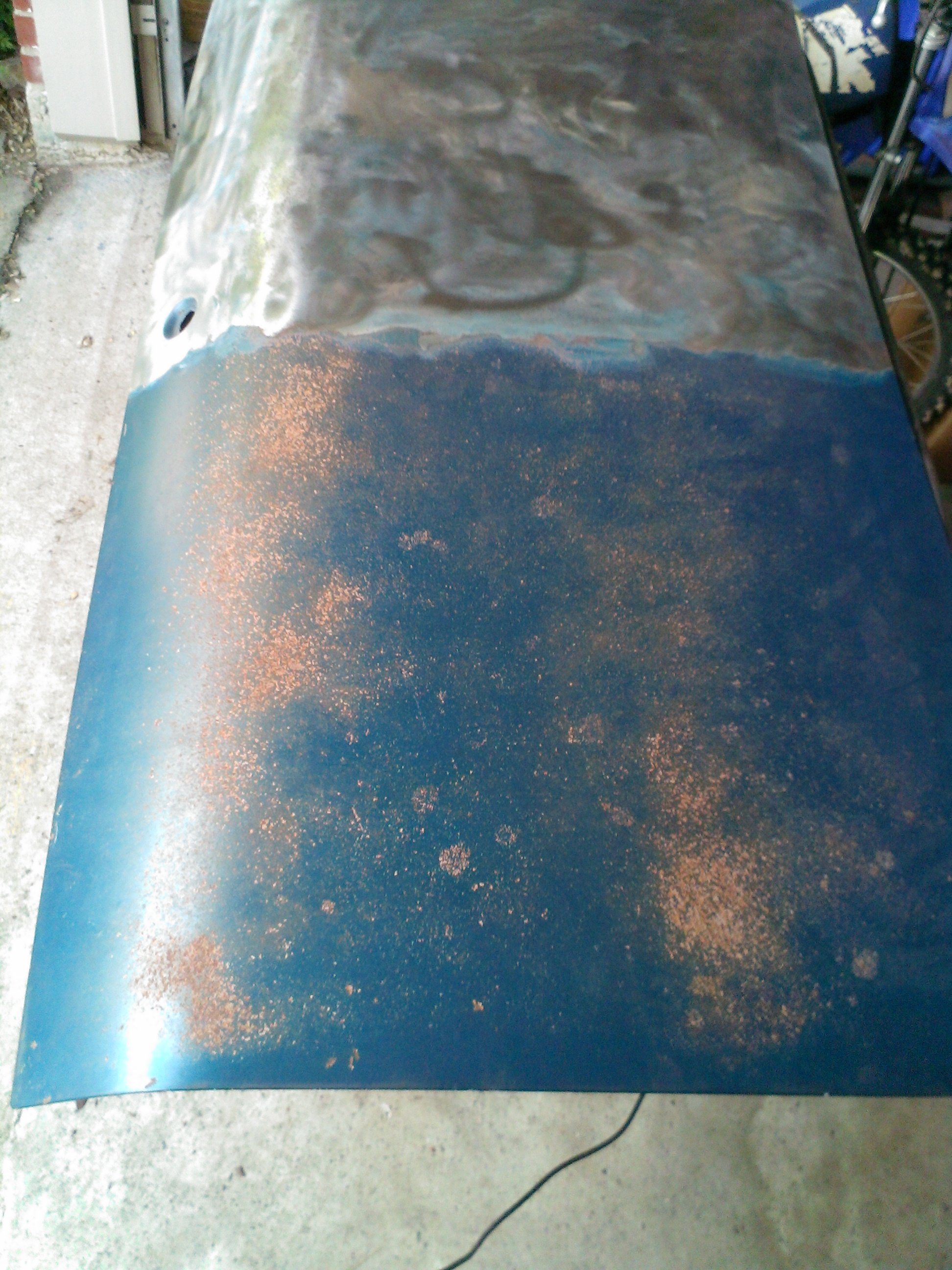

Building my bosses TRUE 70 gs convertible. We look at some parts plp are selling for a lot! We have 2 here 1 parts car
For budget, I'm definitely with the abrasive discs & grinder. I'd have a better quality higher amperage grinder, which you can always find other uses for. One of mine is a bosch with variable speed,which can be useful. Do it outside with a fan blowing at least some of it away from you, a dust mask, ear protection , & my preference of a clear full face shield & go to town on it.
Like any removal method , don't stay in 1 spot too long for heat control. Some pads are better quality than others. Never used the h.f. discs & not sure if their life span per dollar is better than the more expensive pads or not. May look into mail ordering some.
Some paint is much harder to remove, such as old Imron & will eat up any abrasives. Old lacquers are pretty soft.
