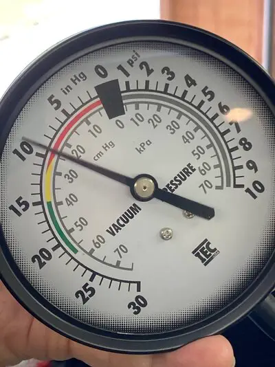

Ths is what Ive got at idle. When I bought the cam the tech at Comp Cams said I was right at the edge of having enough vac for power brakes. Guess he was off by a little. LOL
Thanks Mikester, that's what I was looking for. Now, I see it is not significant. Also, based on ck80's remarks, I understand things a bit more.
