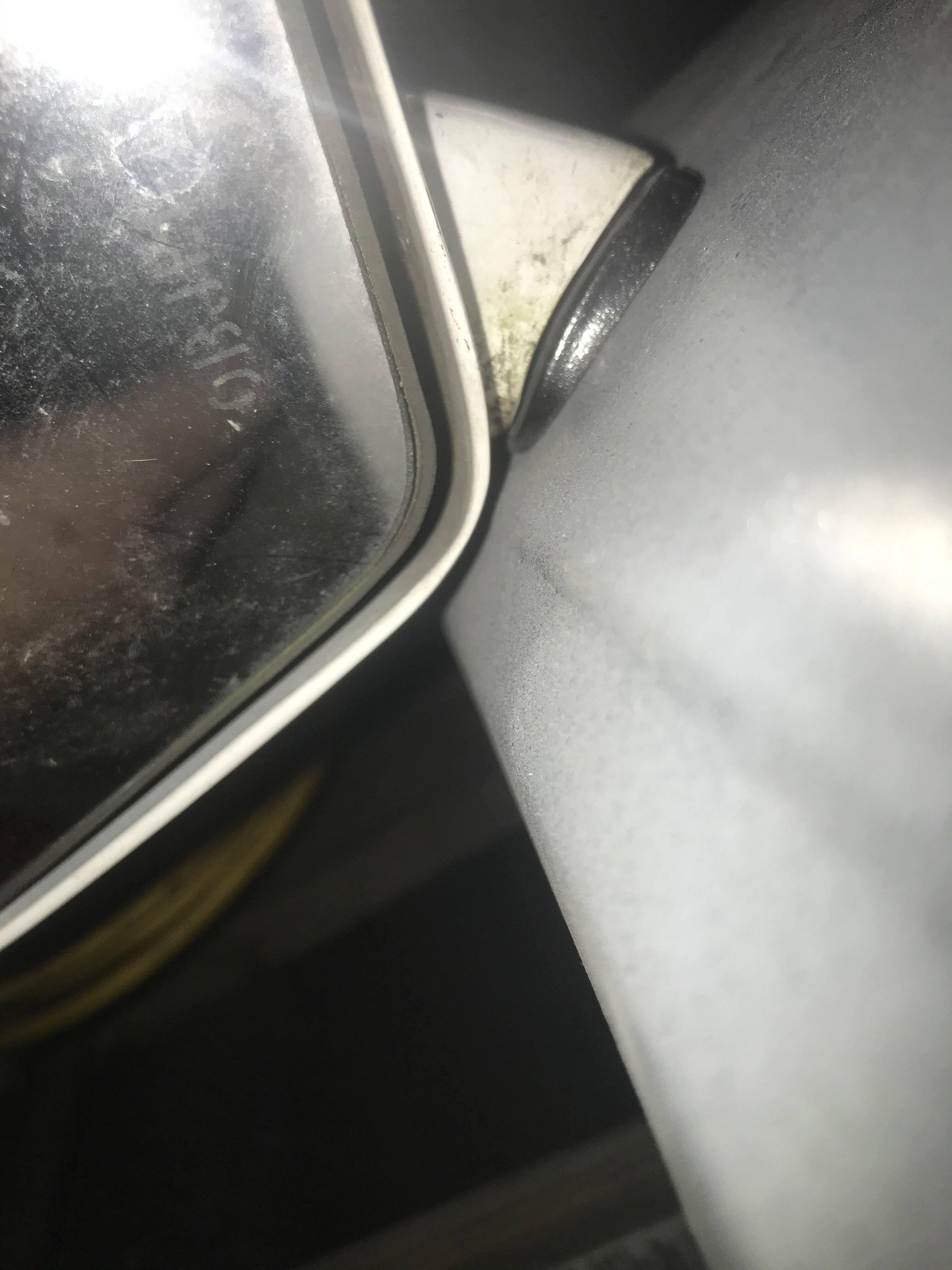

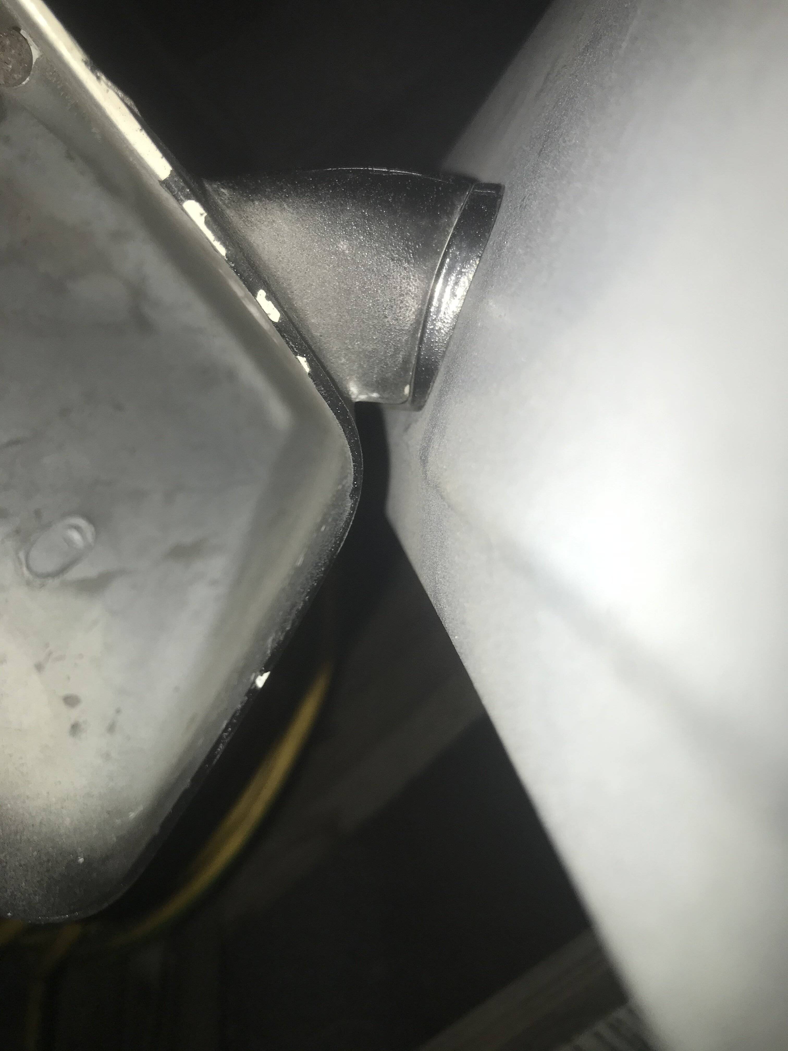

Figured I’d revive this thread with some new information on the C4 mirrors. C4 side mirrors actually appear to be nearly identical to Monte/Fiero except the pedestal around an 1/8 of an inch shorter on the Corvette mirrors:

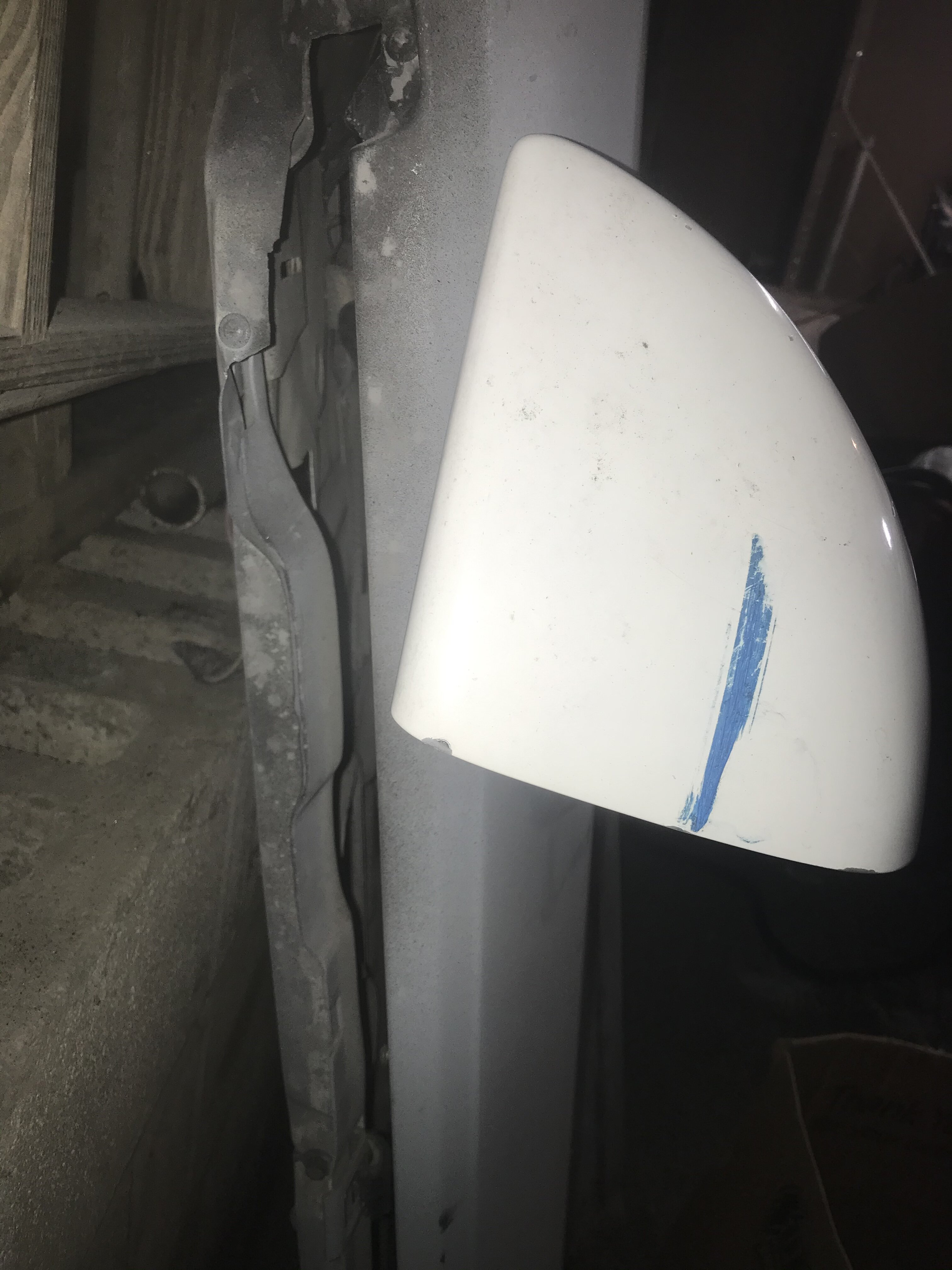

MC

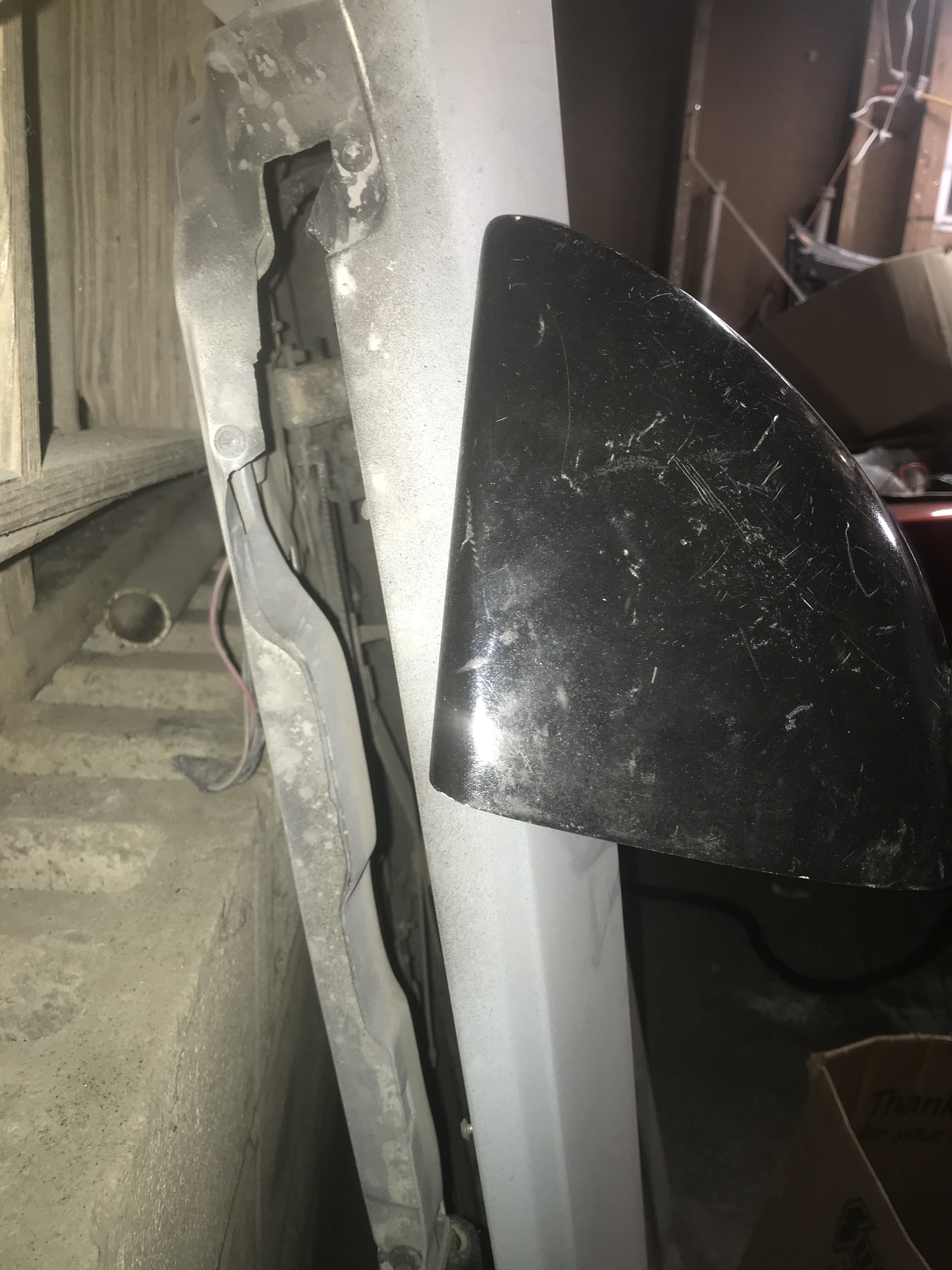

C4 Corvette
Note that both of these photos were taken with both mirrors bolted down in the front only, with a MC mirror gasket in place.

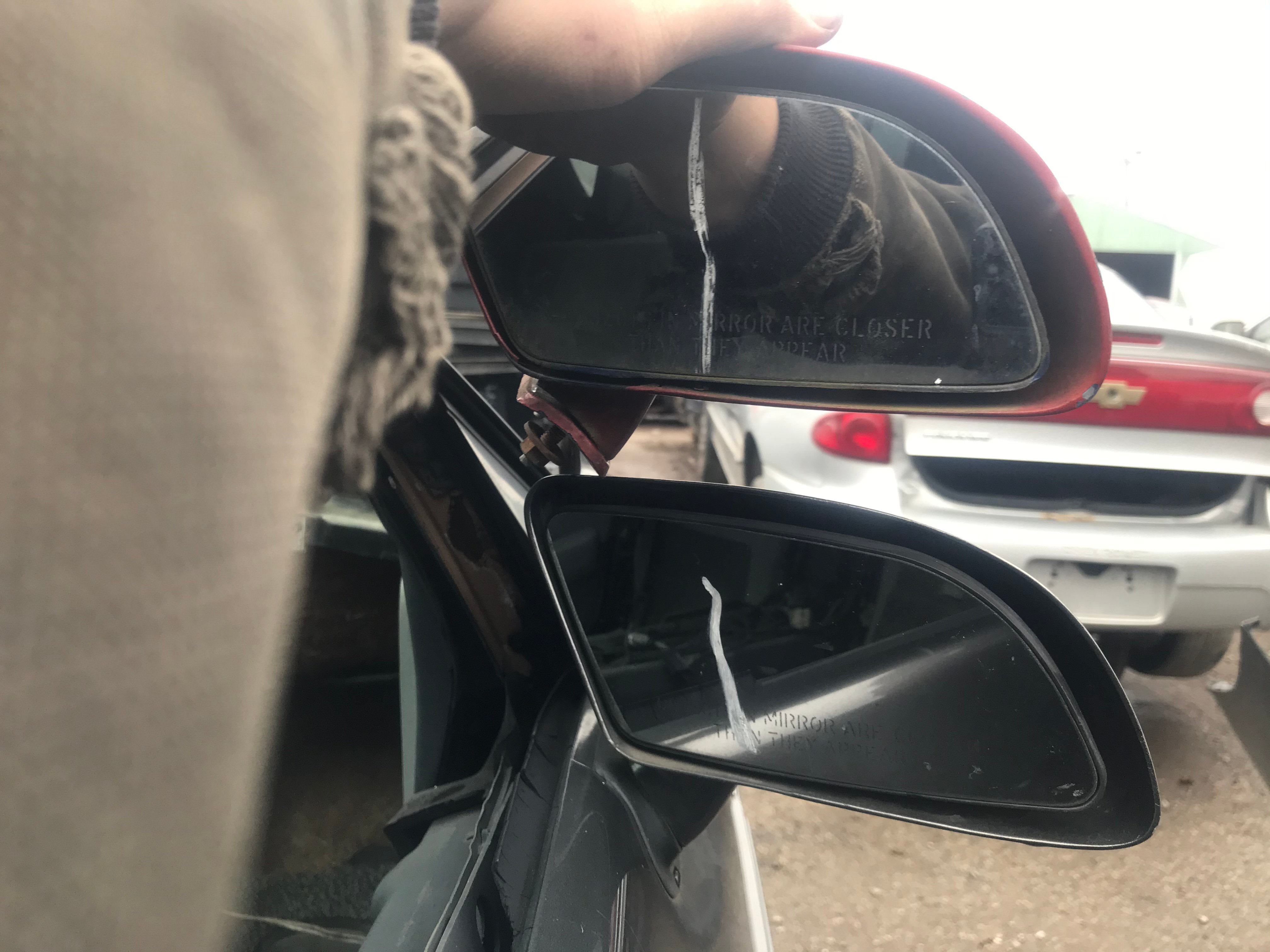

The angles don’t seem substantially different either:
If at all, given I’m taking these photos with a phone camera.
