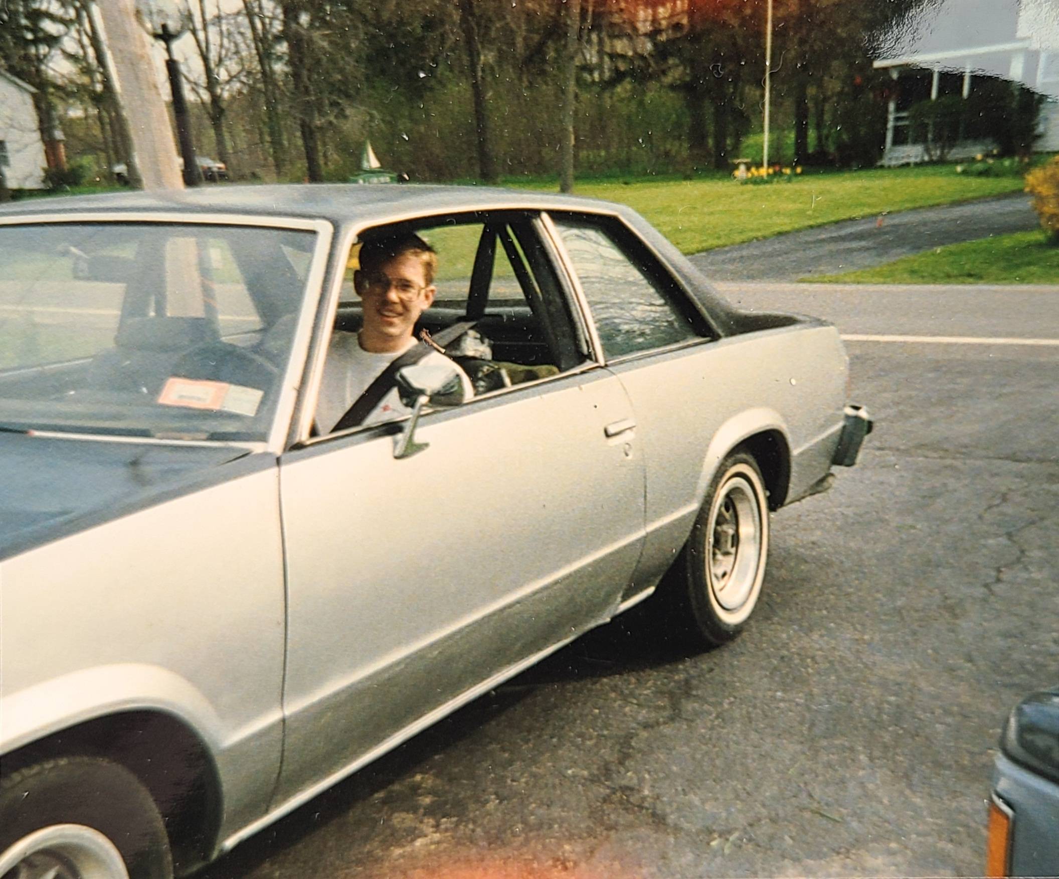

And completely off topic, I stumbled across an old pic today.
This is not my current Malibu, but the one before it. This one died while I was stationed in Georgia back in '94. Frame split in half down the seam by the left rear tire. Yanked the drive train out of it on Thanksgiving day '94 with the help of a buddy in his dirt driveway and installed it into my current car. You can tell where I got the inspiration for my paint scheme. That was factory original and the only one I've ever seen painted like that.
This pic was taken while home on leave just before I drove to Georgia from NY.
Look at the inspection ready hair.
