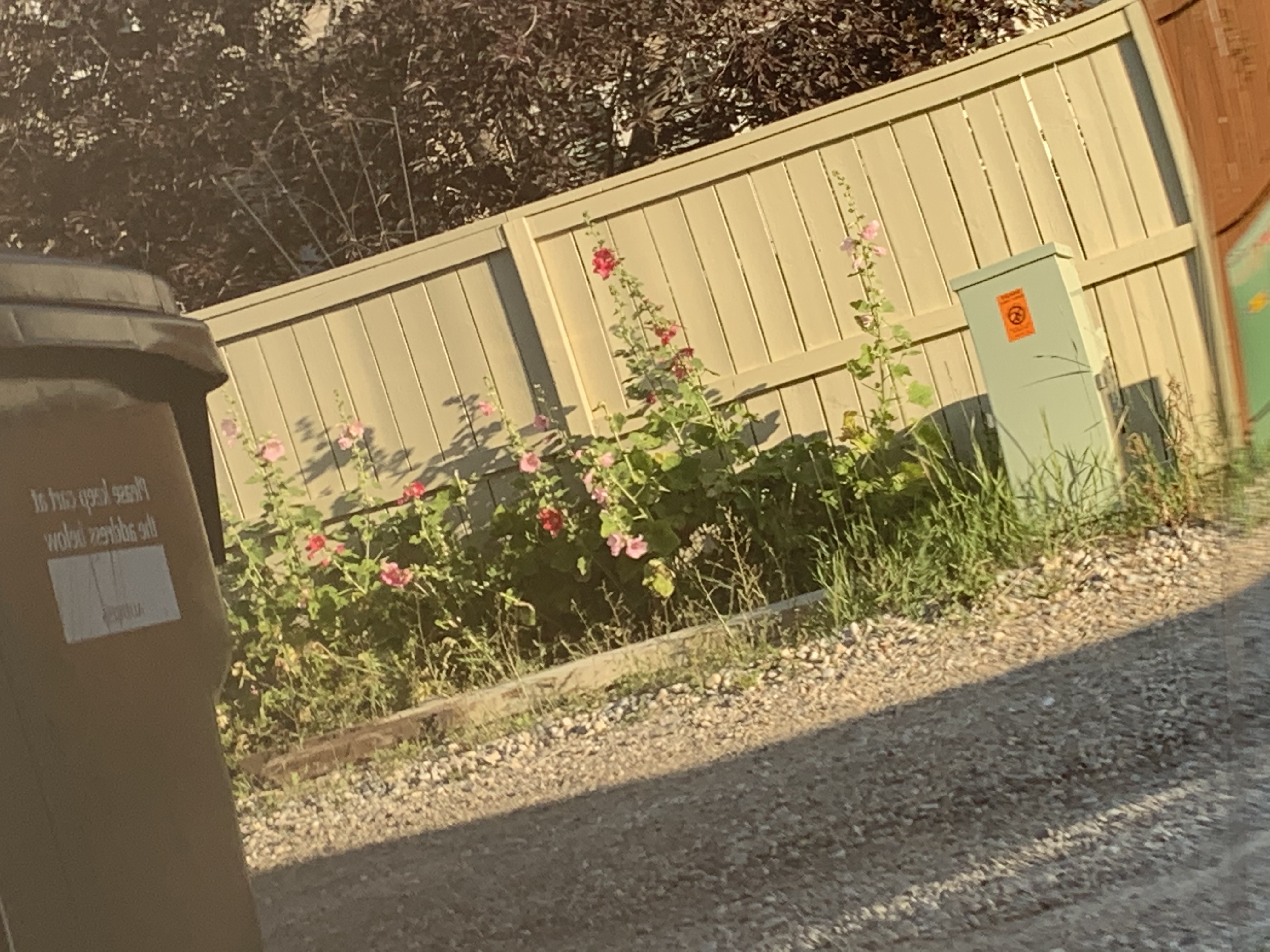

Not an update, but a fun little something I thought I’d share with y’all.
Why do I go to the extent I do? Well tonight I snapped a picture of the neighbors sweet peas growing out in the alley...
...but it was actually a photograph of the fender:
THAT’S why I go to the extent I do.
OK now you're just showing off. With your not flagship build. F me. I'll stick to motors, trannies, and suspension.
